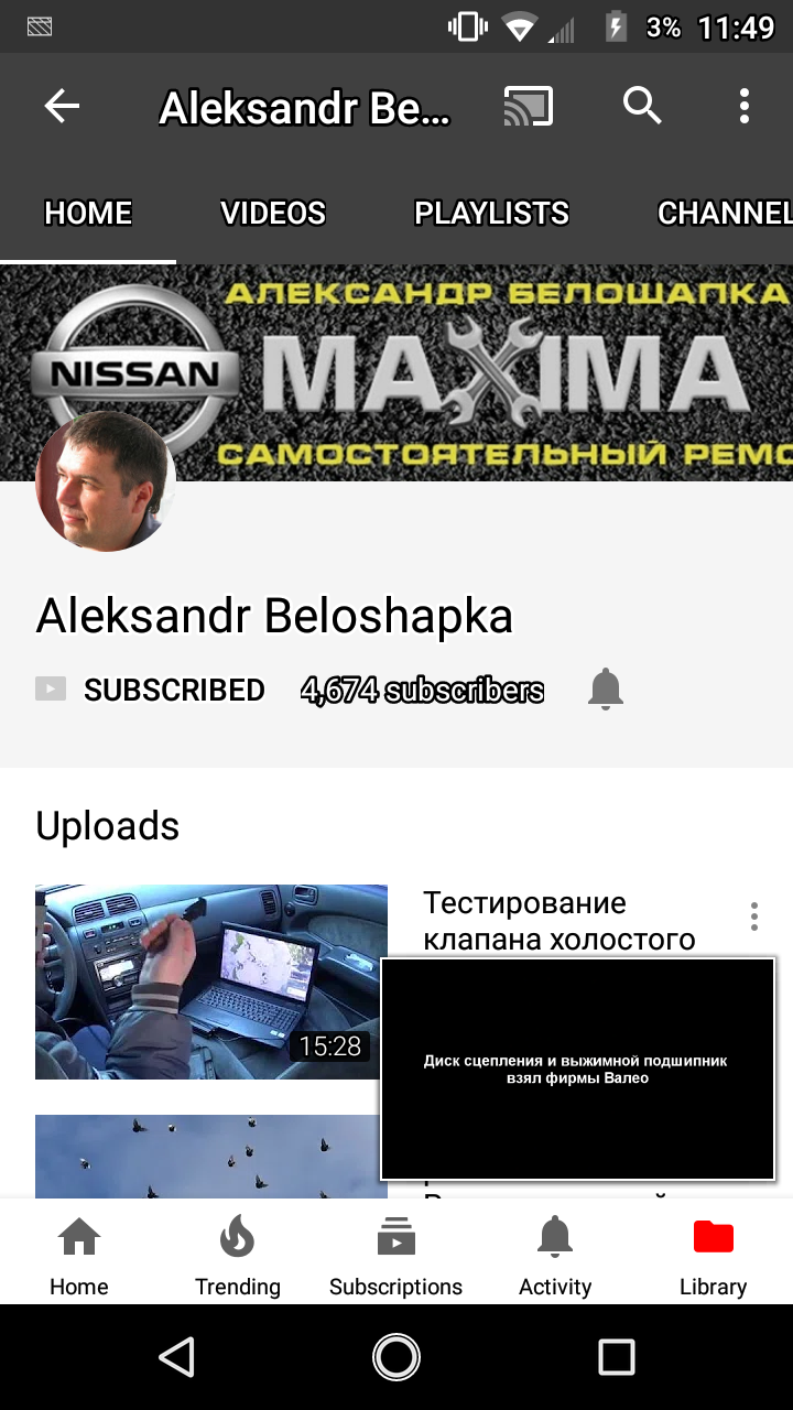

Detailed 5 speed and vq30dek rebuild videos. These are not in English but they exist. The related video links and subscribing to these guys will be your best friend because everything in English is vq35de stuff. It helps to have specific content if your a fan of the cheaper, less powerful, more reliable, and if done right easy to make up the power difference v6 before Renault got their hands on it. Alright guys don't ask how I stumbled upon these. I knew someone had to have done it and the lack of information available. To my fellow 5 speed owners with input shaft bearing problems I sought out finding us some content and succeeded. Same goes to my fellow vq30de and vq30dek owners. Here are the links...
The guy who so far tends to have my favorites... The 2 videos I post are his. This is his profile. You will see the related videos will show these are the Maxima rebuild videos we can't find on YouTube.
https://www.youtube.com/channel/UCCa...9QmruTlXgVmRvg
This is the trans
This is both in one

Got to YouTube search this guy's name then and the top video of my second screen shot is the trans video.

Here's his motor and trans one. He's also got build your own shop press, ecu repair, and vias fix. When you watch these the related videos are your BEST friends because where ever they are from there's a bunch of these guys doing major, detailed, and not a word of English repair videos. They video so well though that there is no need to hear really...
