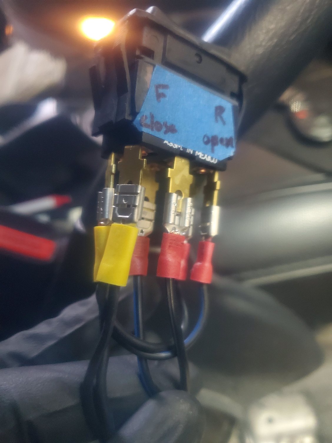

Hey Slamrod, not sure if you'll see this - 'cause old thread - but you should be fine hardwiring it. I finally got around to hardwiring mine this weekend. It's sooooo much nicer having it on a switch vs the remote control.
I'm far from an electrical expert, but if you wire it with a momentary on-off-on switch, you won't have continuous power to the motor/solenoid. You'll only be powering it when it needs power - to open or close. So it will work just like it does from the factory, except with a switch instead of with the remote from the factory.
Few pics of my install:
The spade connectors aren't pushed all the way on yet in those pics fyi.

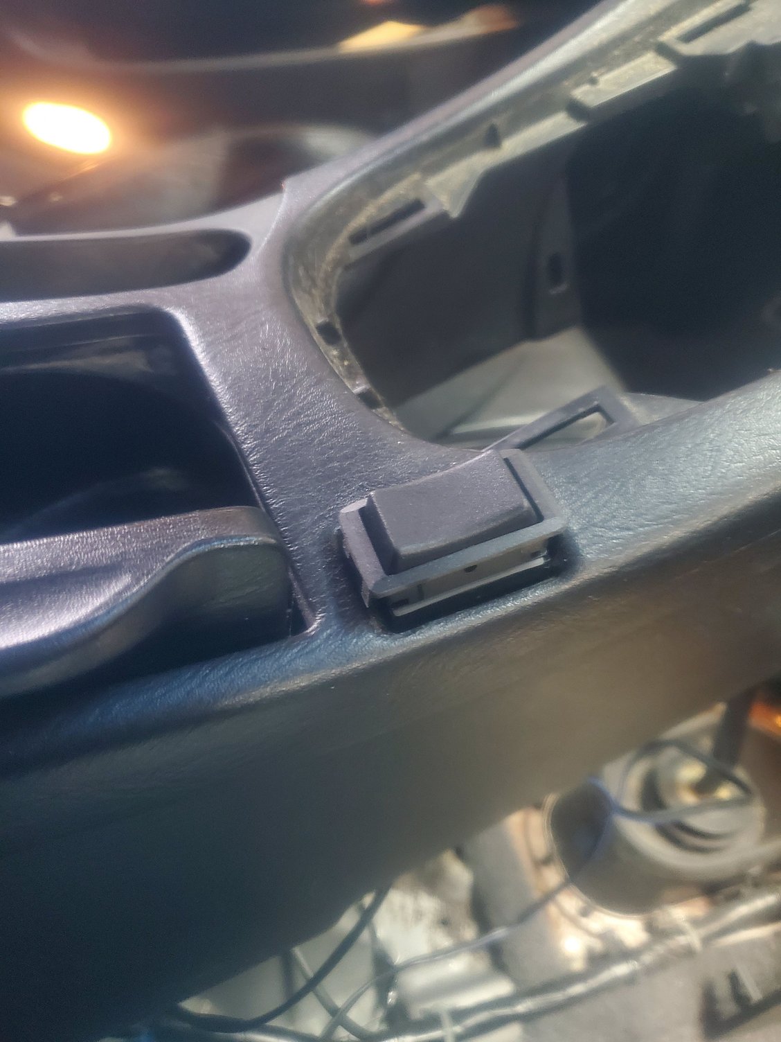

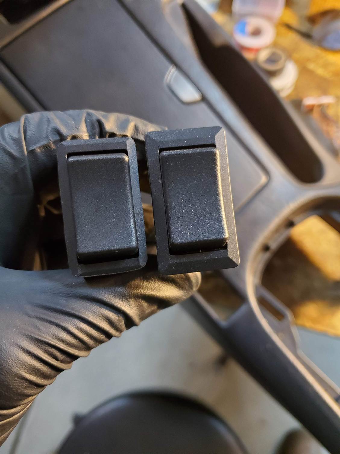

I had to shave down the edges of the switch, and coin-holder opening, with a razor blade to get the switch to fit.... but when pressed in, it almost looks like factory, so pretty cool. I filed the edges after taking this pic so nice & straight.

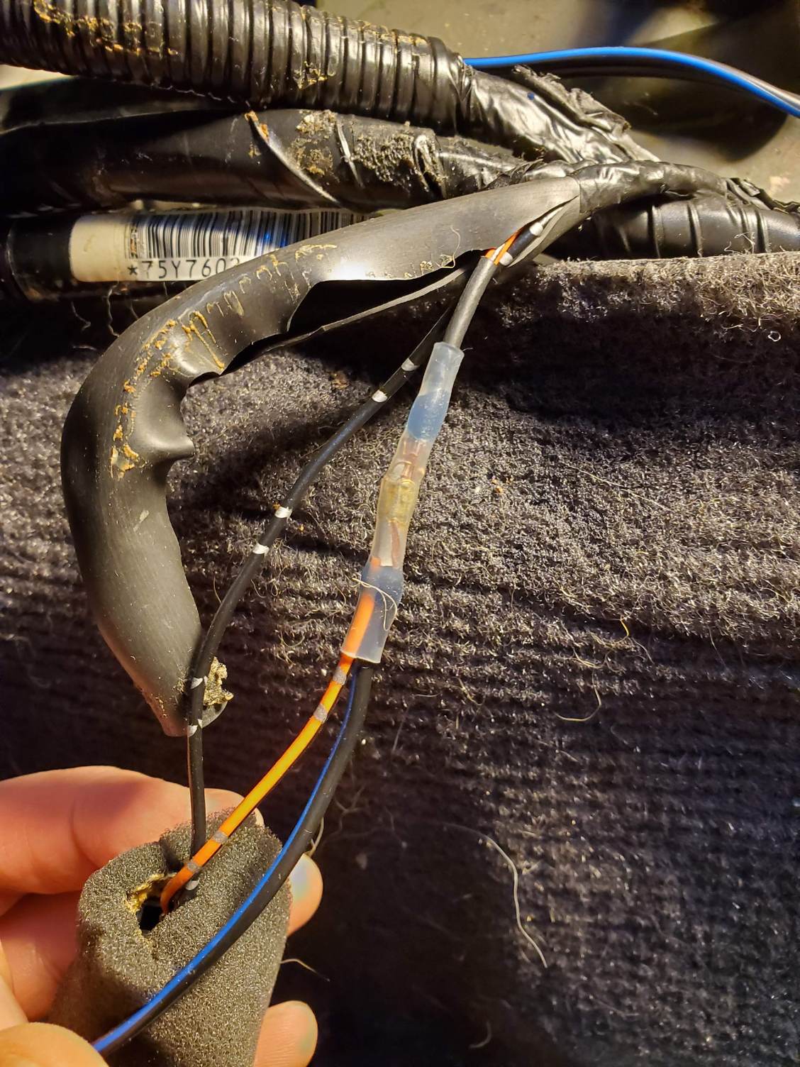

I ran the wire from the varex through the grommet in the spare tire cavity, underneath that metal backseat plate, and fished it under the carpet along the middle hump and into the center console area. I used the factory ground screw right next to the airbag controllers, and tapped into the rear cig power source.
It should've been a real easy install...... but it was my first time so I went really slow measuring the wire and thinking everything through, and ran into a few headaches along the way..... so it took much longer than anticipated. Some headaches were: I first aimed to ground on a bolt that covers the parking brake cable, but that bolt snapped 'cause so rusty..... so I had to drill it out and re-thread that hole. Later, the center console fell backwards and pulled the power and ground wires off the spade connectors and the switch, and of course they touched together, and of course I had forgotten to turn off the ignition switch..... so loud spark and popped a fuse..... took a really long time to figure out which fuse as I never knew the rear cig lighter is not labelled in the fuse box!, it's called something different. Joys of working on your own car haha.

Where did you get that switch? I really dig putting it in where the coin holder went, clean spot to have a switch there. Lmk, when I get around to it (not really a priority right now lol) i would like to copy your setup.

I can't remember where I got the switch.... I do recall searching online hours and hours trying to find the right size and type though. Lmk if you decide to do it, and I'll dig around for you to find it.
