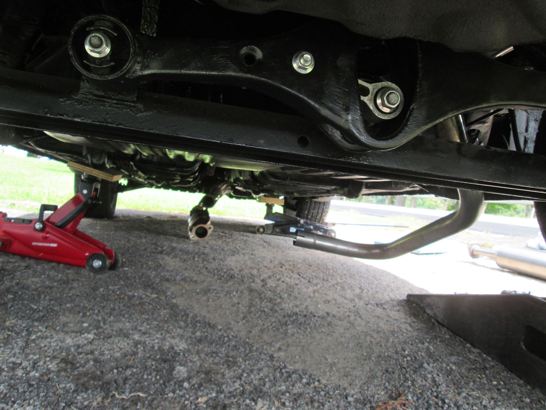

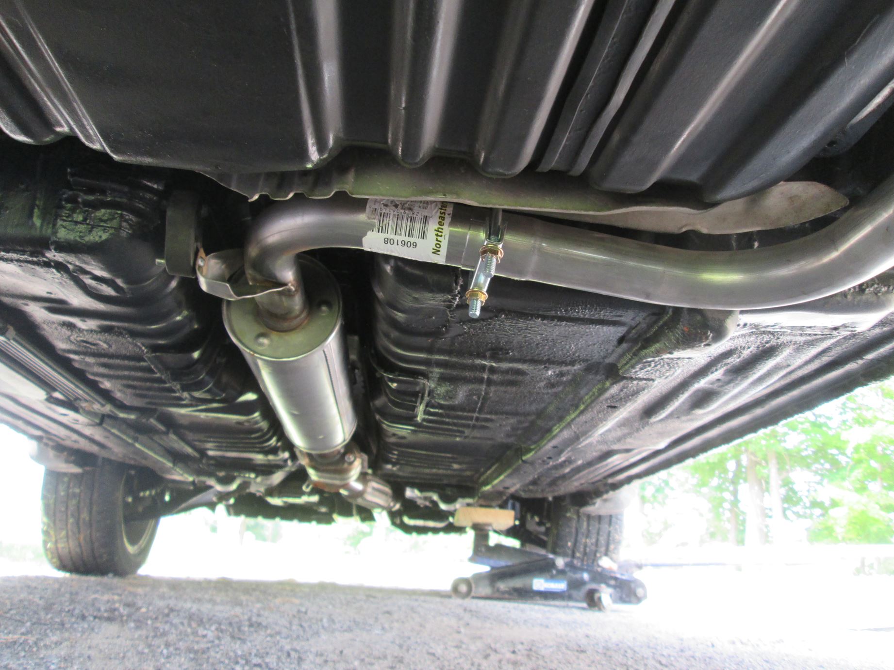

I thought i would start a new thread .So it can be seen more.

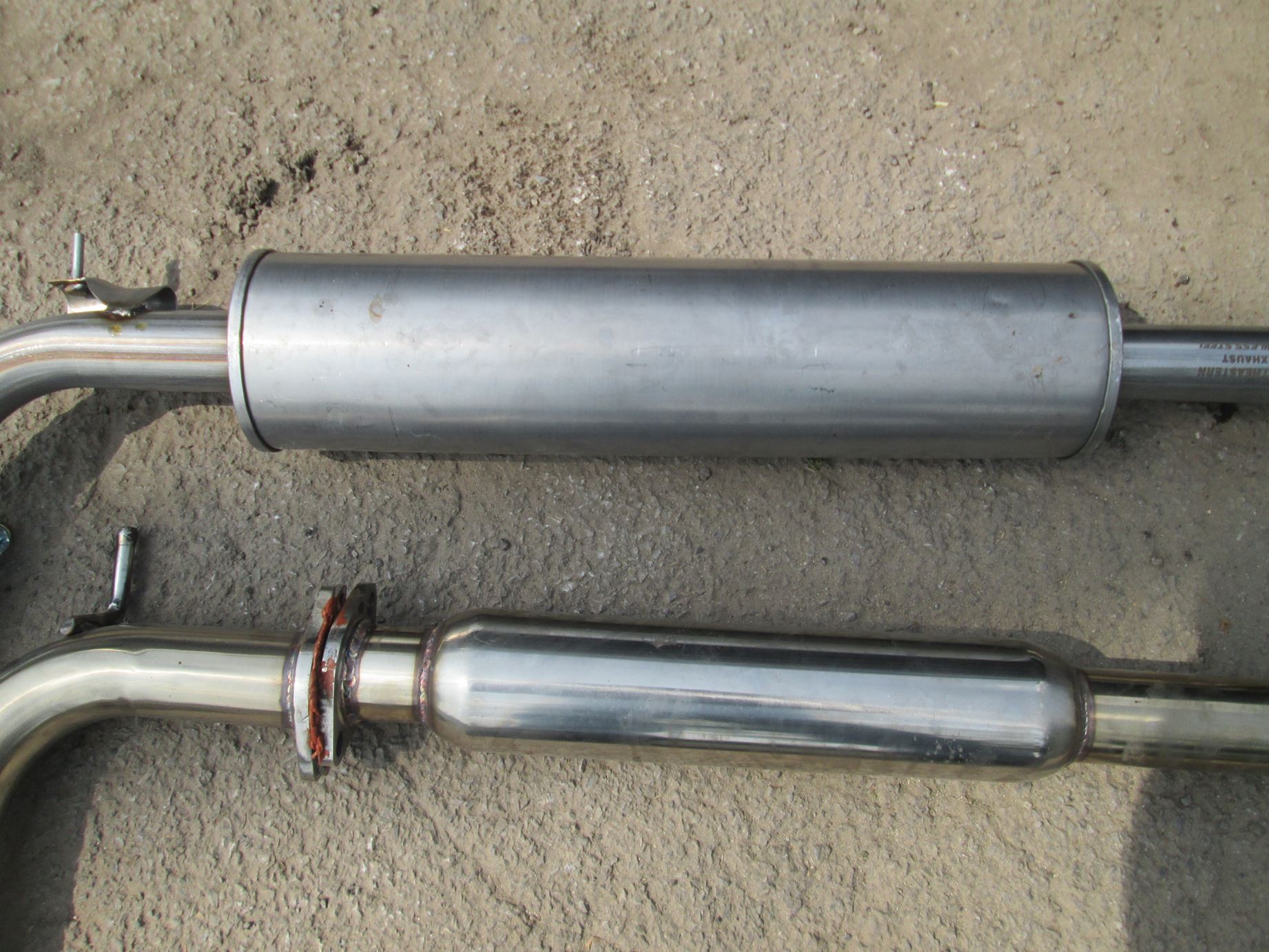

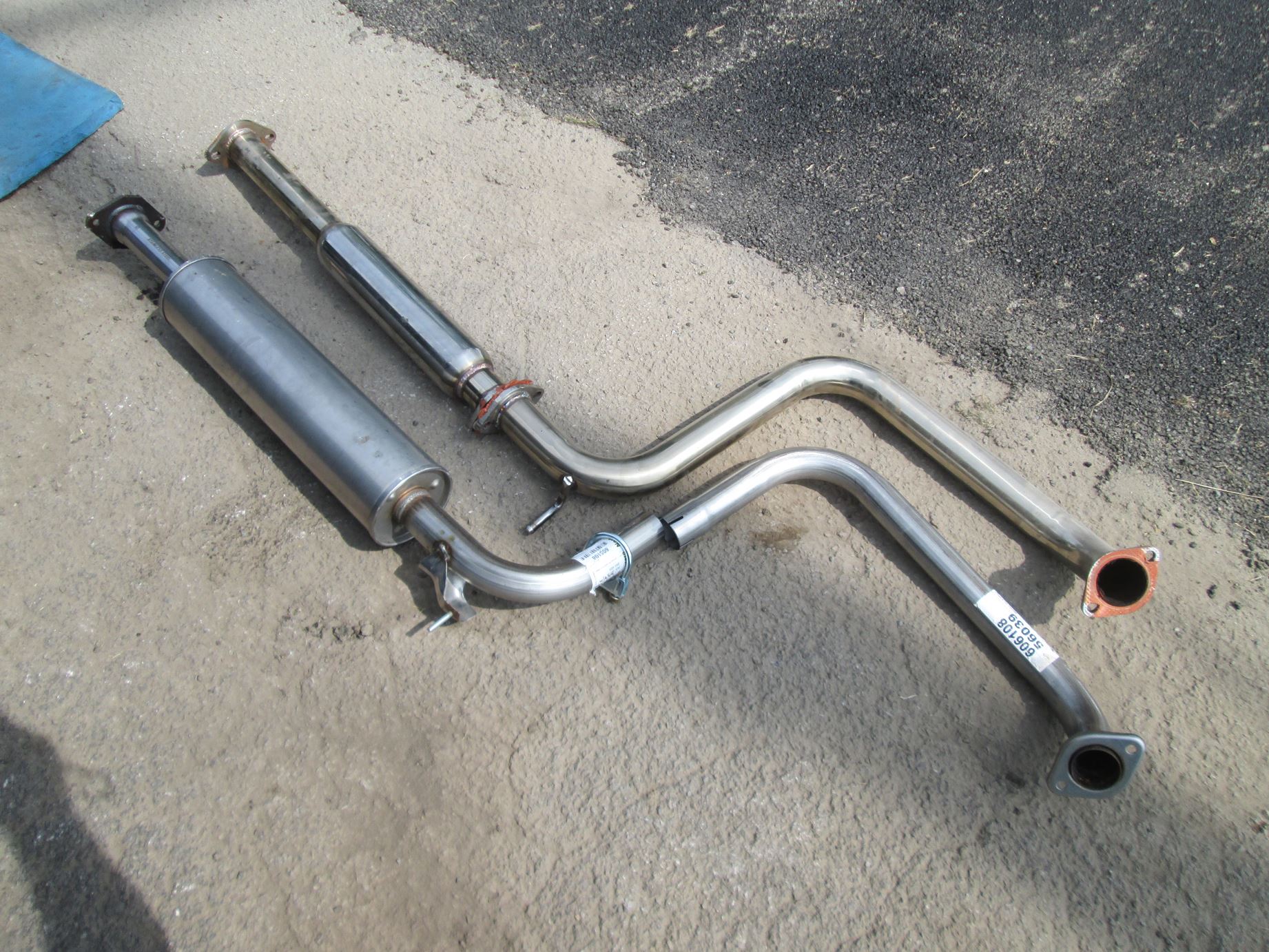

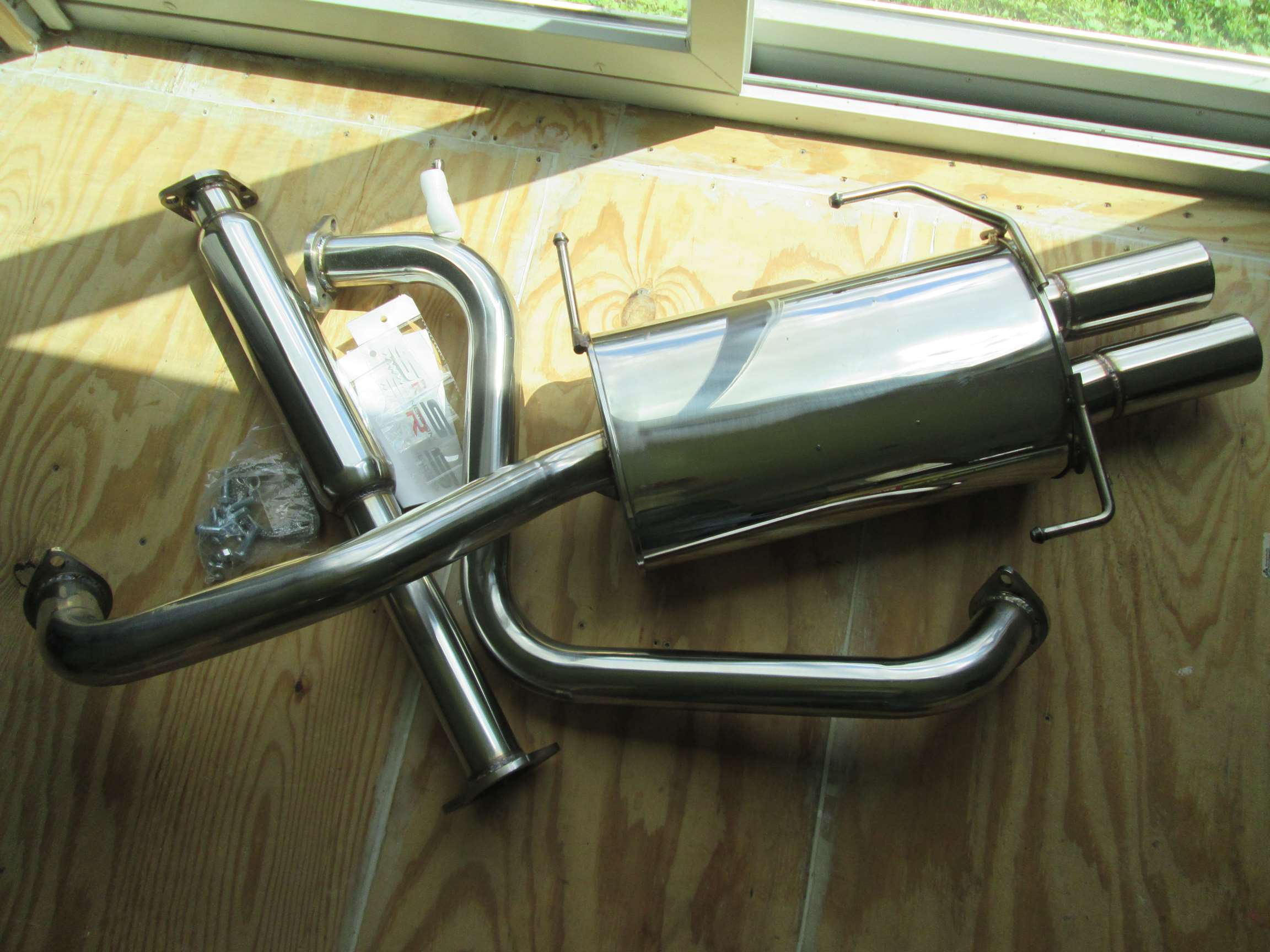

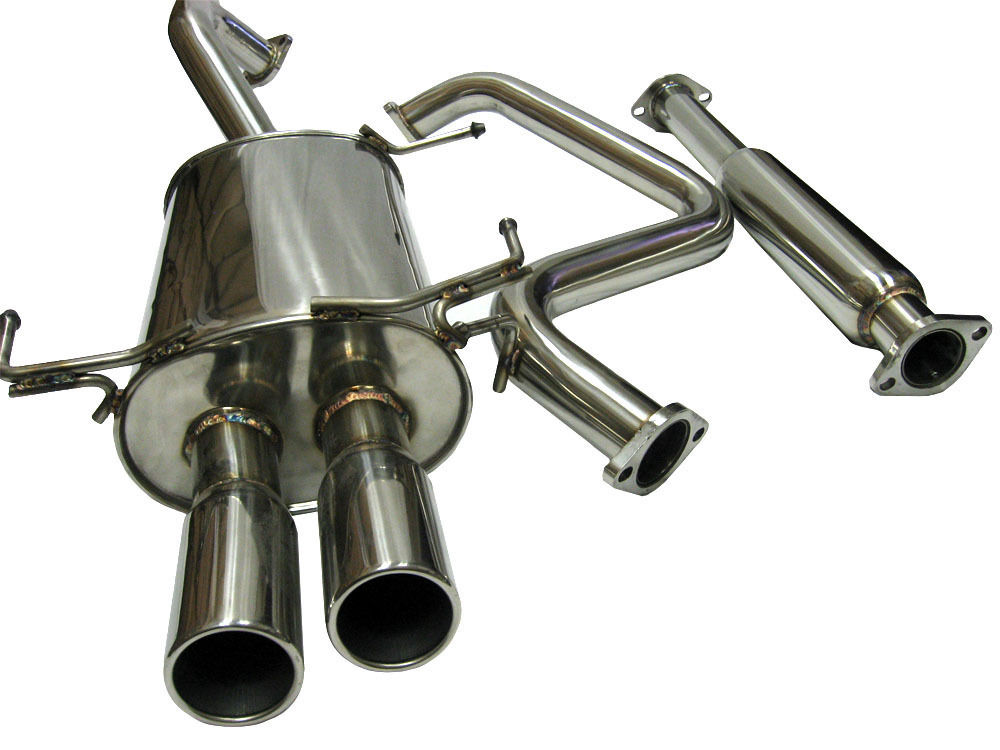

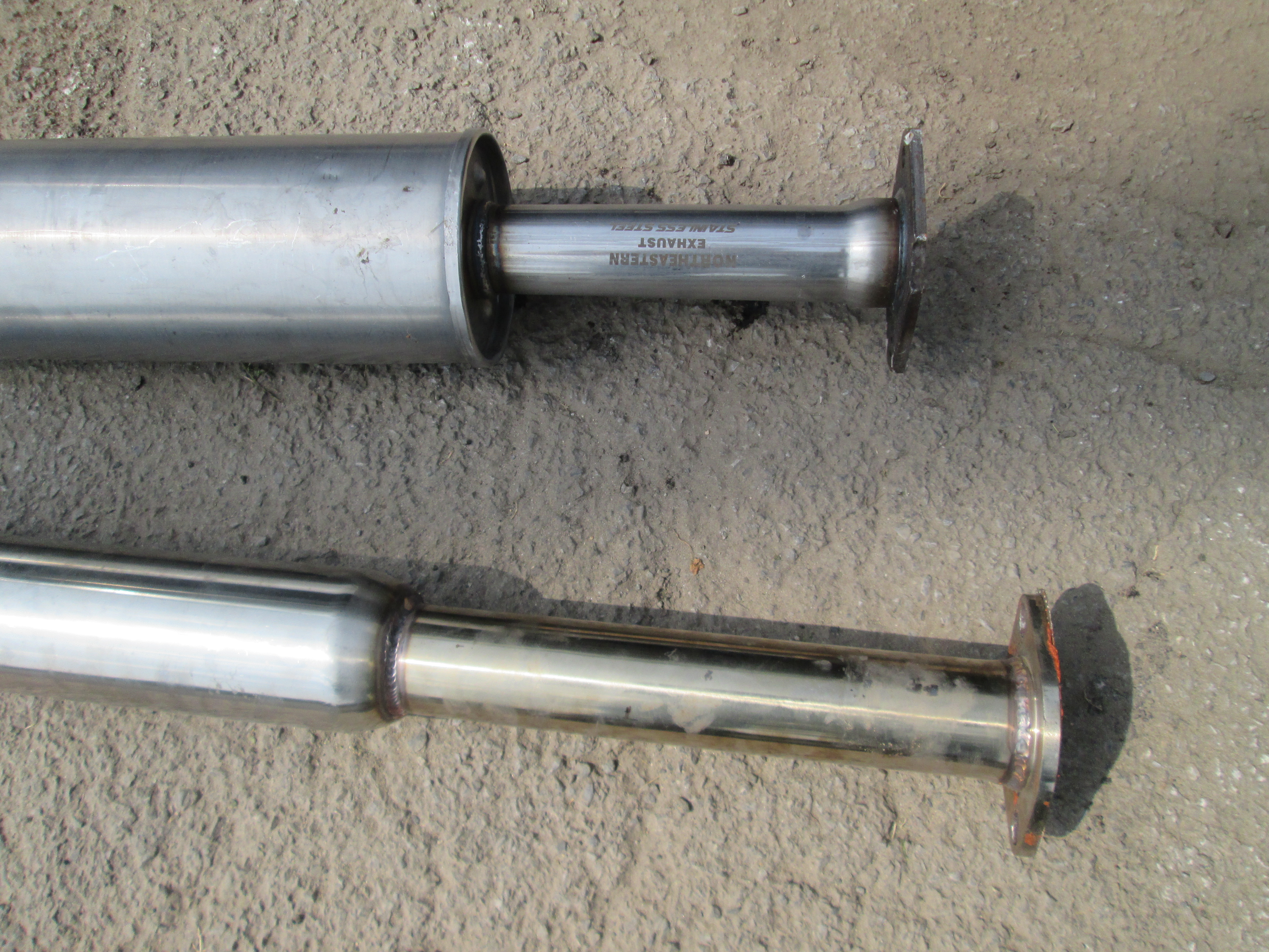

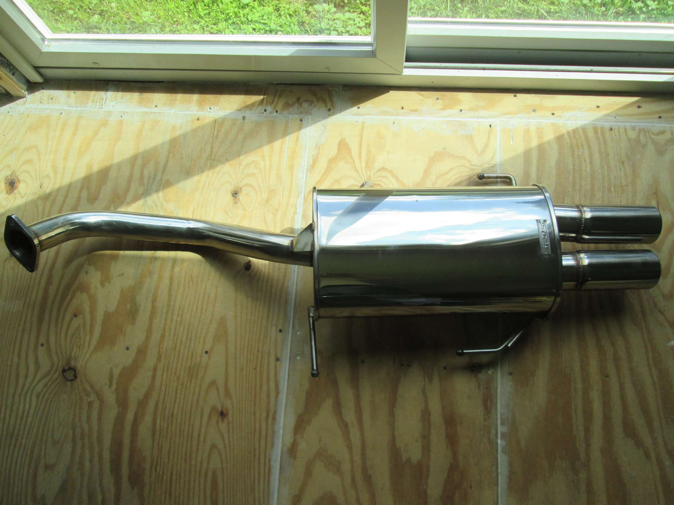

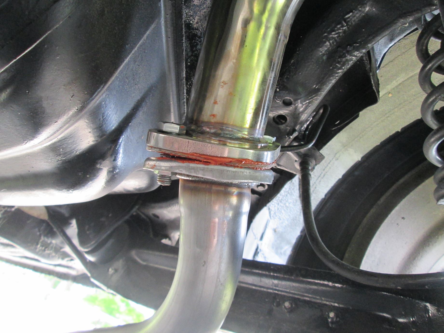

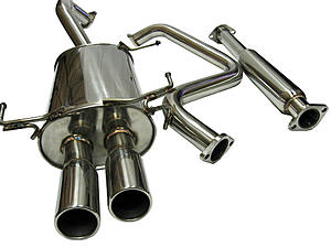

I bought the SRS 2000-2003 cat back. But it is way to loud .Pictures below shows the difference ,between the Northern exhaust and SRS.
The resonator is way to small.

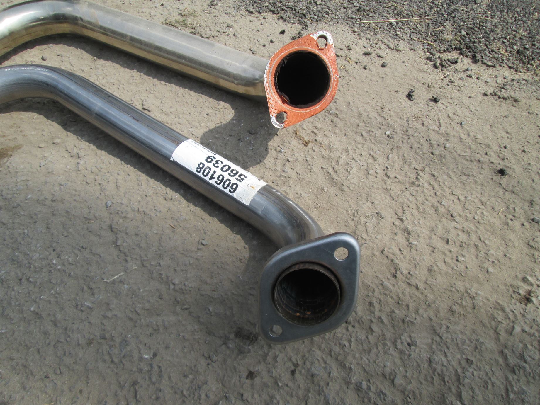

OK i have the full Northern Exhaust stainless steel catback (Stock Style)But below is just the b-pipe that can be bought separately.
https://www.ebay.com/itm/fits-1999-2...e/172426200089
So ..the great thing is the SRS is stock in the way it bolts together. You can use any combo.
This is good because i love the SRS muffler . So i bolted the northern B-pipe and SRS muffler together.
And i must say, it sounds like what a stock exhaust sounds like. But for missing precats ,and i have stock intake.
I love the sound .it's the kind of quiet you get when you rev it, and you hear 99% engine sound not exhaust.
Well i am going to stick to this setup. I haven't driven it yet but idling and revving sounds perfect.

From: Houston, Tx
What's the length of the rear muffler body? About 18"? What the pipe size? Looks like OEM stock size...2" maybe 2.25"
Old Aug 28, 2018 | 12:15 PM
krismax's Avatar
Father of the 00 VI
iTrader: (15)
Joined: Nov 2000
Posts: 3,323
From: amsterdam ,new york
Yes the body is 18 inch long (without tips and pipe) And it is a tad over 2.25 inch

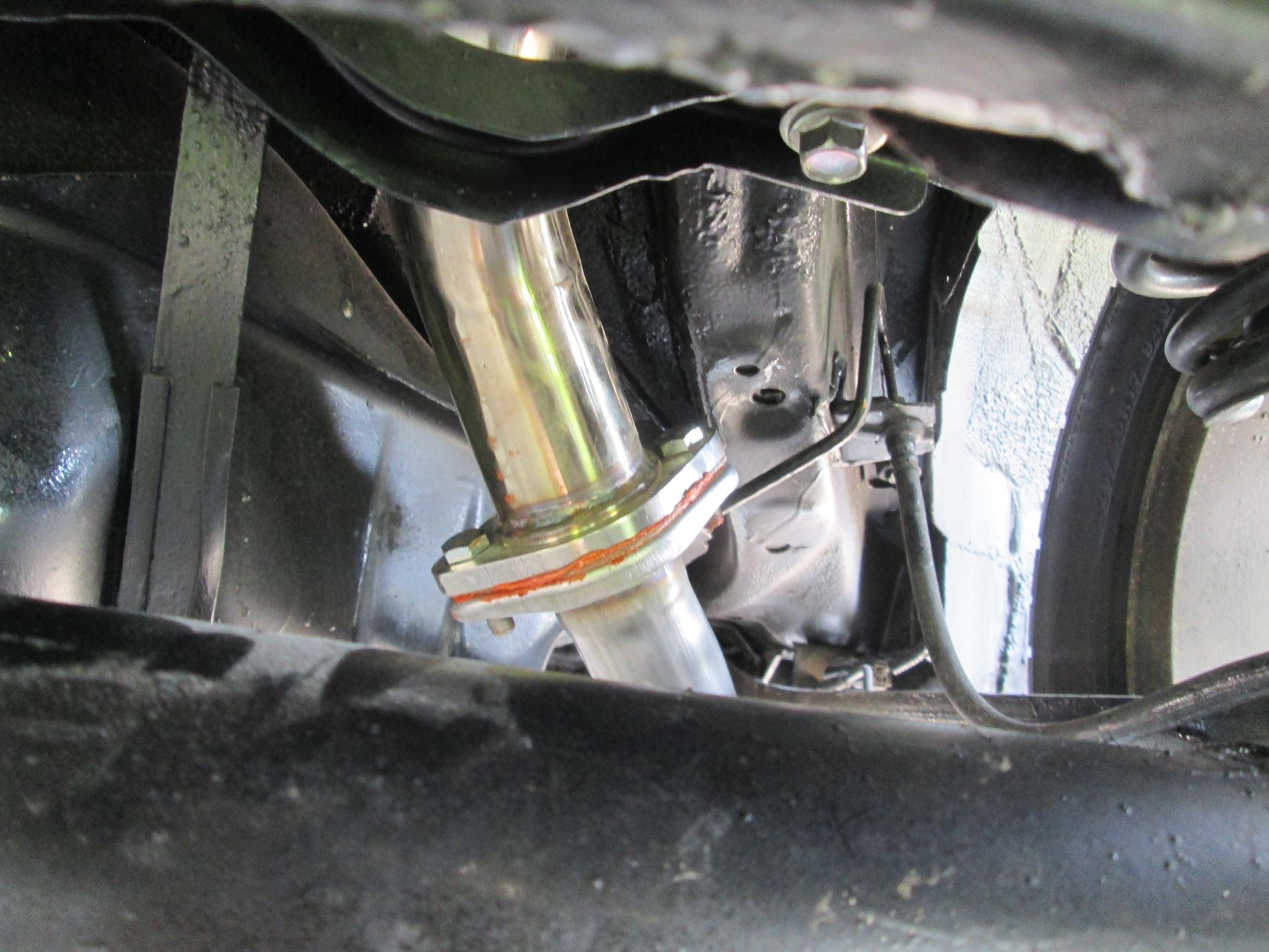

Old Aug 28, 2018 | 06:51 PM
User1's Avatar
Joined: Jun 2018
Posts: 2,493

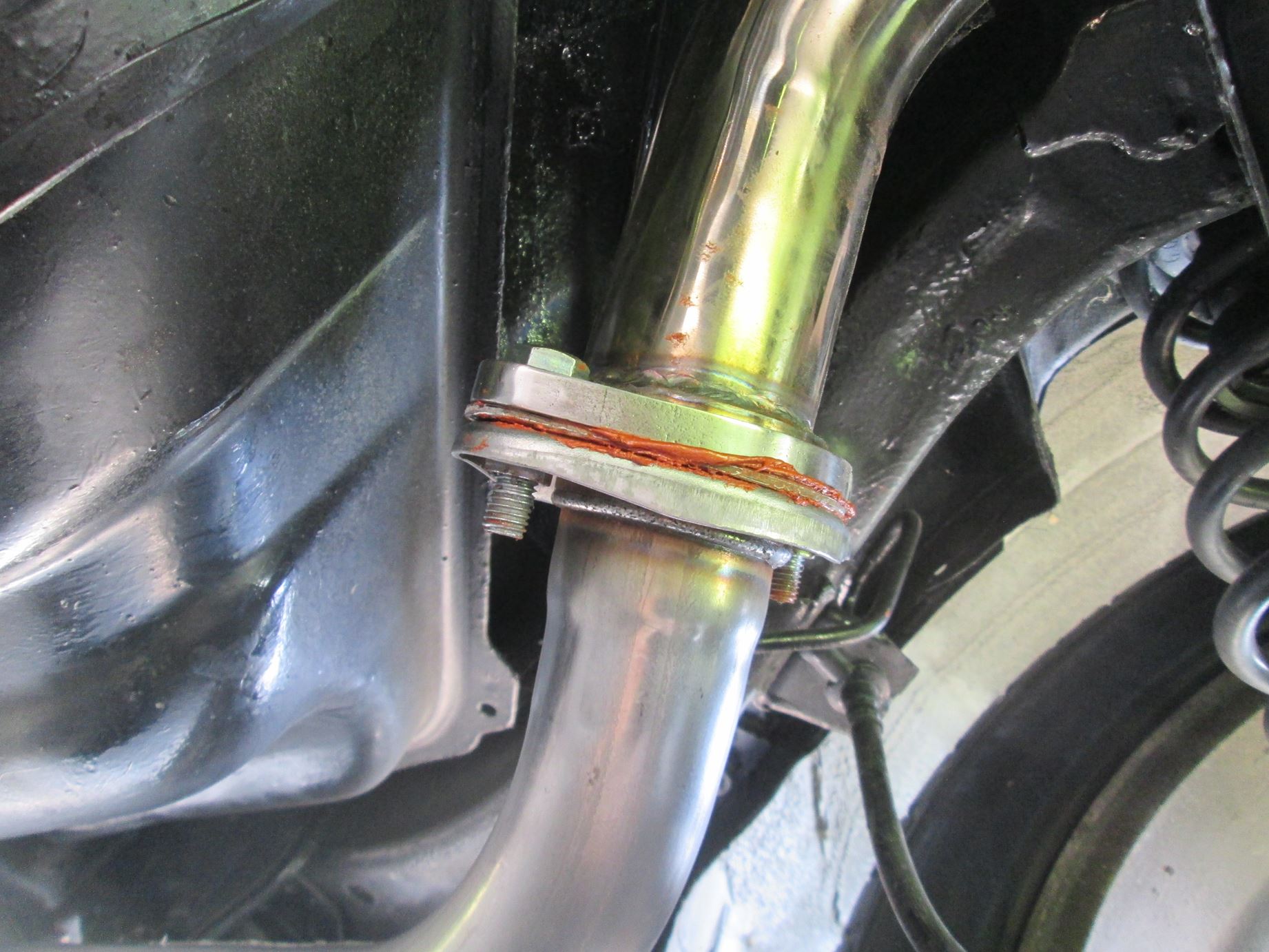

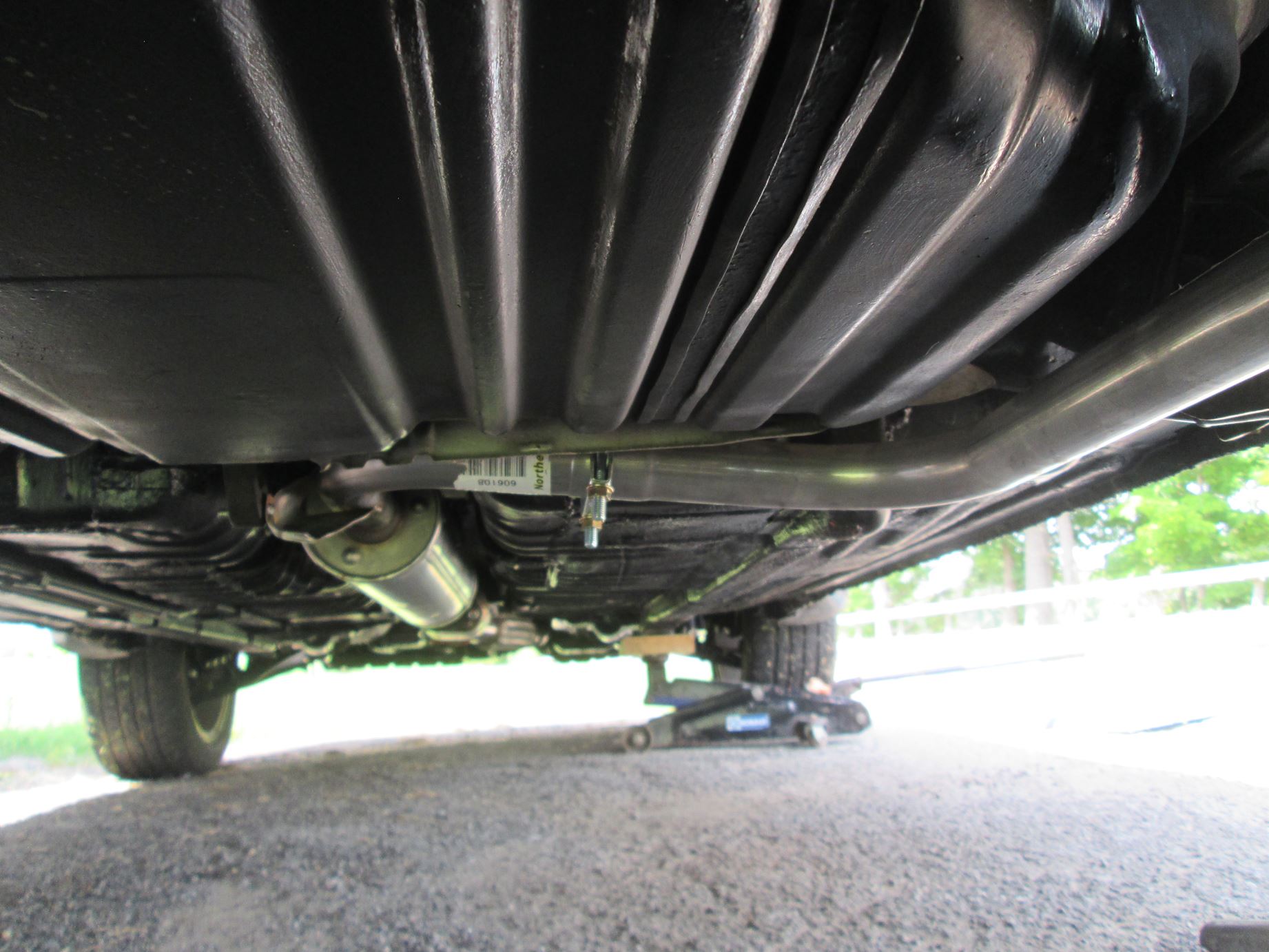

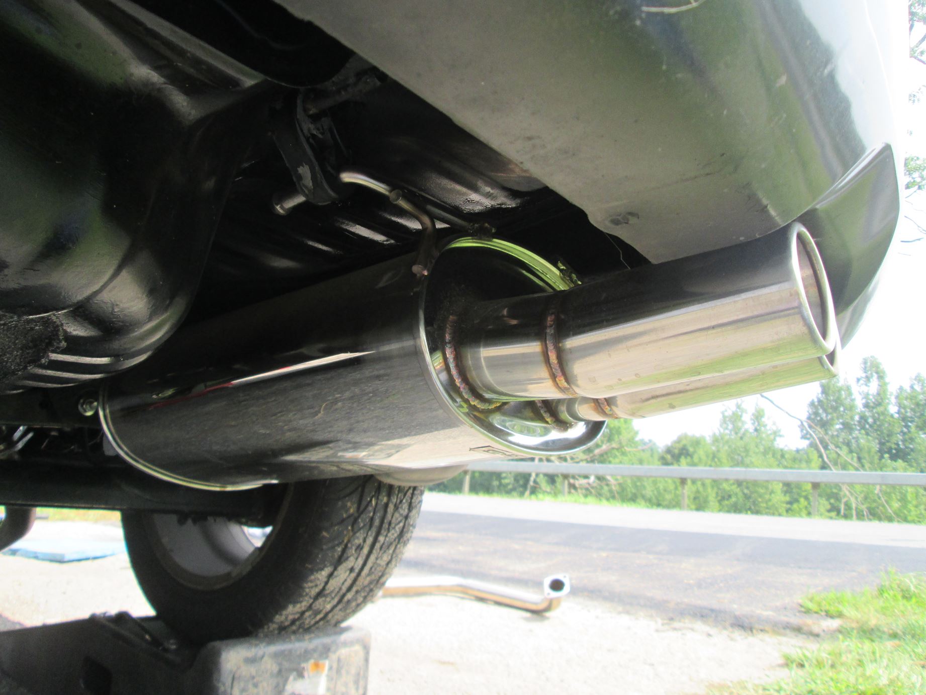

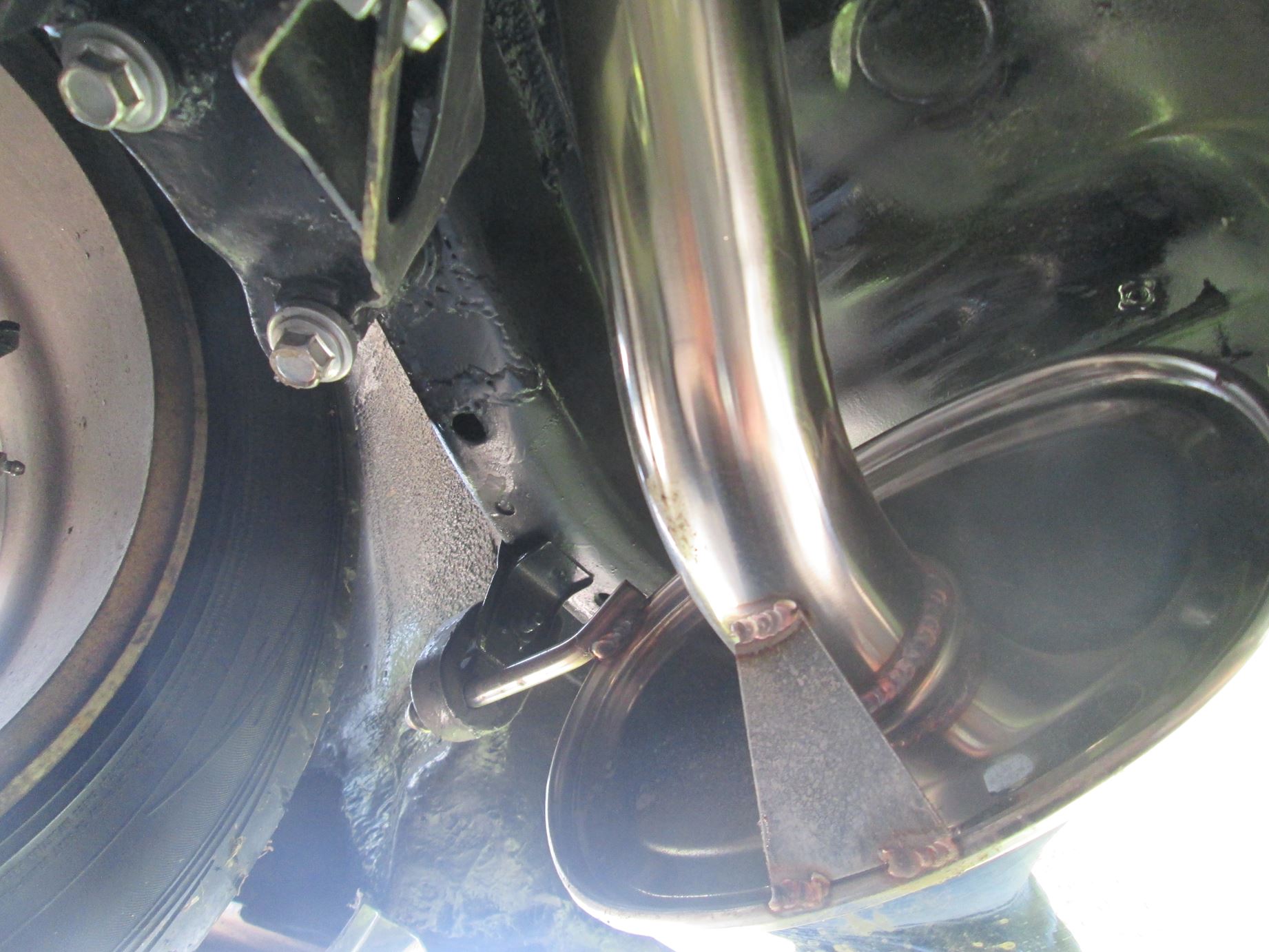

Your undercarriage looks great. Connection in pic 8/16 looks a little off kilter. I'm a fan of the stealth, Mercedes-quiet exhaust note myself. I love a nice -V8- exhaust note, but there's really something to be said when you walk on by most sedans and sports cars (vettes included, believe it or not) on the road in a 2013 S550 Mercedes and the turbos aren't even perceptible at 5k RPM, much less the exhaust.
That alignment is pretty good fitment for exhaust when it's loose. You don't want to see the super chinesium lol
Thanks ...i agree with the comments you make.
As for the exhaust being loose. I leave it that way ,for about an hour or so.
Because i use RTV copper gasket,i wait for it to set before i tighten them down.I took the pictures before and after this stage.

From: state of confusion
Originally Posted by krismax
I was fooled by the SRS because of the stock sized muffler. But i did't realize how much the resonators do.
Between the OE resonators and cats you almost don't need the muffler. And that's coming from somebody who doesn't particularly like loud exhausts either.

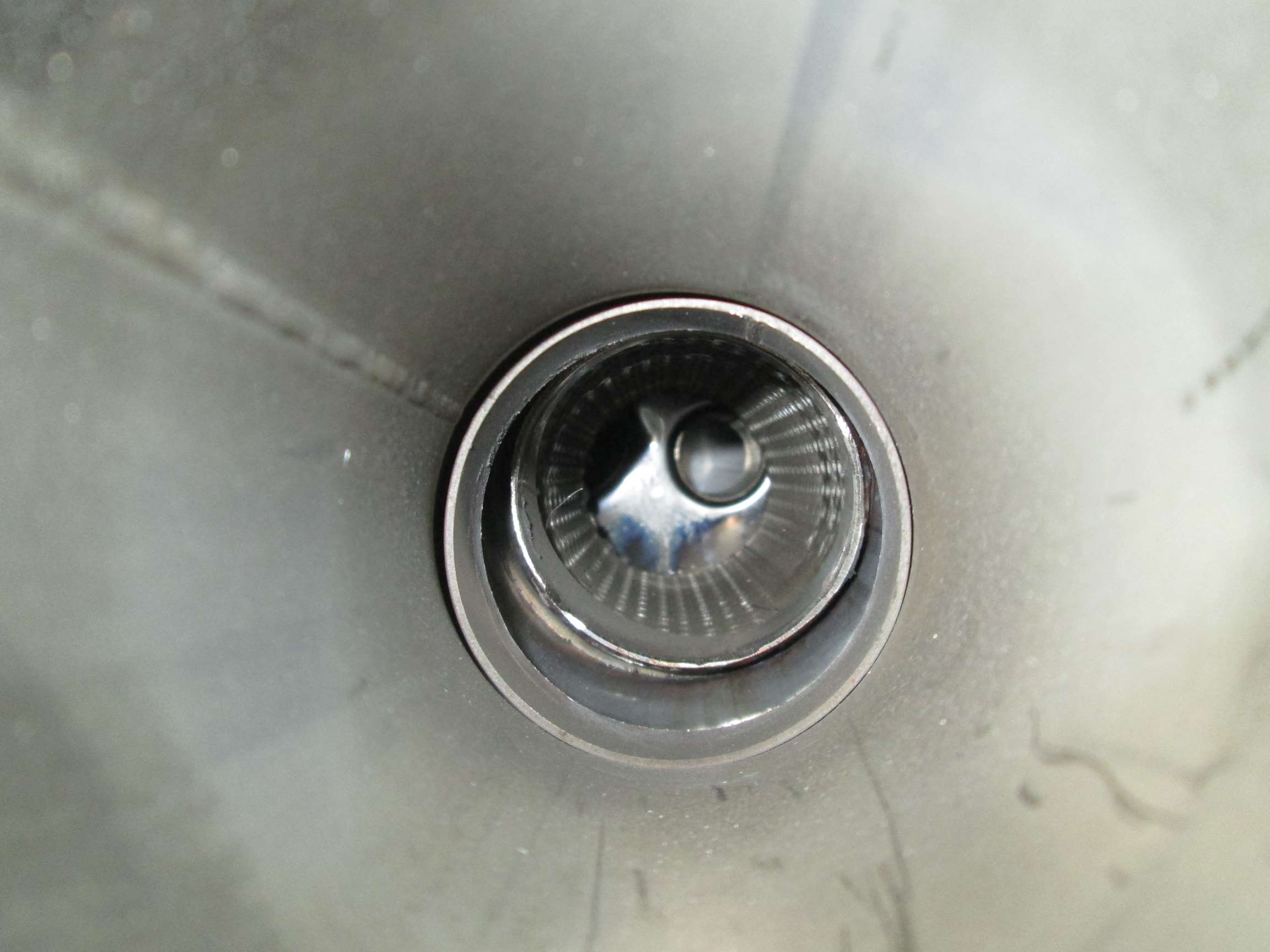

Yes i agree. That muffler is definitely ,still giving a rumble.
I just took it for a drive ,this morning. Idle is very quiet,to the point it would be hard to hear the car running from a few feet away.
it is still louder than stock. Highway cruise is quiet also . there is a slight drone in a 2000-2500 range. I am debating putting the northern muffler on also.
But it has a very nice sound the way it is. I don't think that SRS muffler does any sound muffling .
i think it actually tunes for the rumbling sound,it makes. Does that make sense?It rumbles more than any 3.0 liter engine i have ever heard.

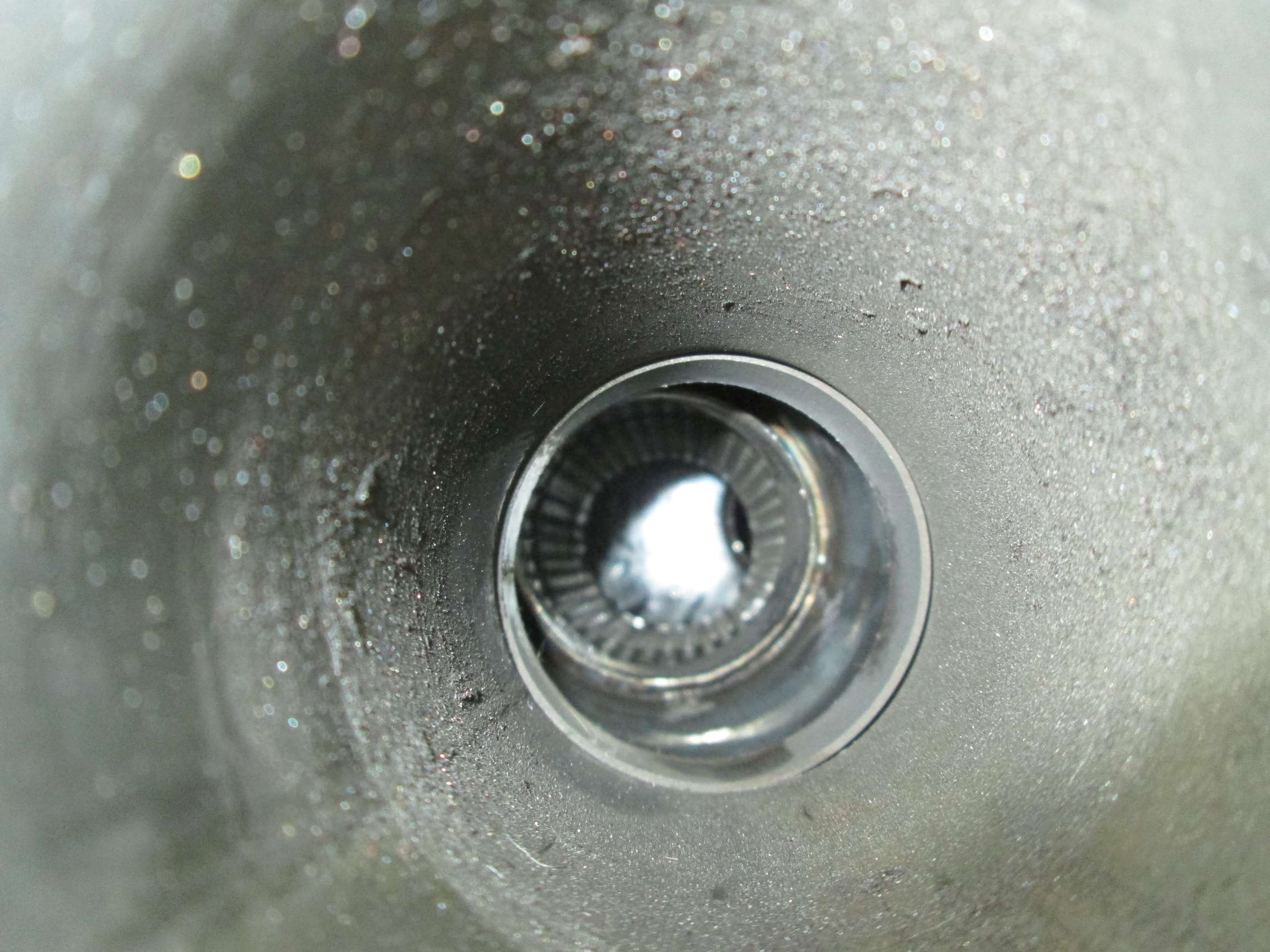

Here are the 2 pictures of inside of each tailpipe on the muffler.
I see a lot of turbulence with all the transitions internally...I would personally go to a Magnaflow 2.25" X 6" x 18'' resonator p/n:12645...and leave that 18" rear muffler in service . I experienced a lot more torque and throttle response on my 3" Cattman exhaust when I switched to the 6" round one piece Magnaflow design...It was so much more cleaner internally, no internal turbulence from all the transitions, welds, offset piping!
It's a 3.0, no worries on perf loss
