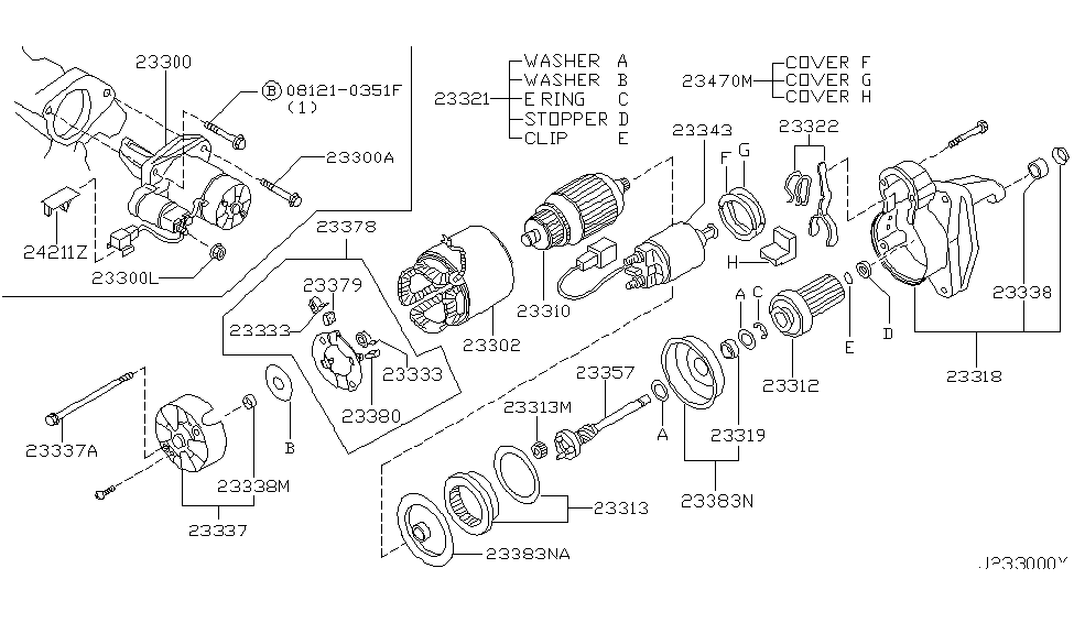

The starter gear is not a BENDIX drive that works by inertia. The starter gear is engaged mechanically by an arm, moved by the starter solenoid.
If you are holding the key in the START position, the starter solenoid will remain engaged, keeping the starter motor spinning and the starter gear meshed in the flywheel gear.
See part # 23322 neat the top right of the parts diagram.

Wait a minute, guys.
So if part 23312 remains engaged with the flywheel when the engine starts, what's to prevent part 23310 from spinning like crazy and self destructing due to centrifugal force? And what parts are making the screeching sound due to lack of lube?
The the starter gear itself (part 23312) is built with a locking clutch. The clutch is the bulge behind the teeth. When the engine starts running, it will cause the clutch to unlock and the gear will freewheel. If the motor armature (part 23310) were to be driven by the engine's flywheel, the centrifugal force would make it self destruct - exactly as you are thinking.
It's a good possibility that the squeal is the starter gear freewheeling on its hub.
