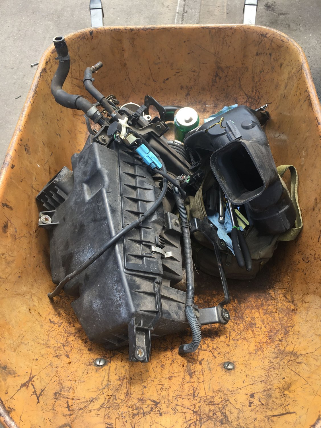

My 2000 Maxima GLE had stalling issues at Idle when I was at a STOP Sign or STOP Light. Cleaning the Idle Air Control stuff didn't help and it was not until I went to the Salvage Yard when I found an identical Maxima arrived and only three (3) days at the Salvage yard and sure enough it was completely intact with wheels and tires. I opened the hood and ALL was there, nothing missing and I wasted no time and took the entire Air Intake parts, Air Box, MAS and Unbolted the Idle Control Valve (Electro-Mechanical) unit and came home and replaced ALL.
Needless to say, this solved my issue with my 2000 Maxima GLE with the 3.0 Liter Engine V-6 and it idles perfect and solid. I have to be careful when I take off as it has lots of power and feel my body go towards the seat cushion when I accelerate and watch everyone else in my rear view mirror!
It is my belief that the MAS gets faulty and coupled with an aged Idle Control Electro-Mechanical unit just causes issues with stalling at Idle.
