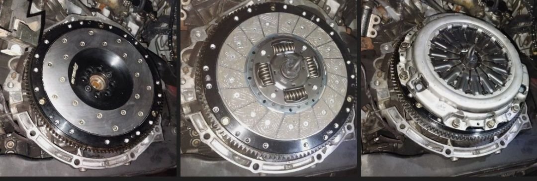

it's been a year since I installed the M-Pact 350Z pressure plate and disc along with JWT flywheel. it's held up pretty good and haven't had any issues so far. grips pretty good for a basic replacement clutch. I think I paid around $150 for the pressure plate and disc and $24 for a National throw out bearing..
I'm in the process of gathering parts for a 5.7 swap and I think I'm going ot go with one of their street performance clutches.
