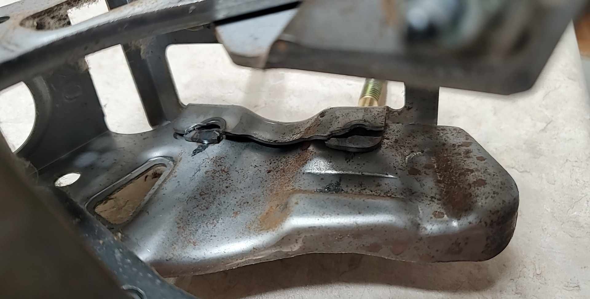

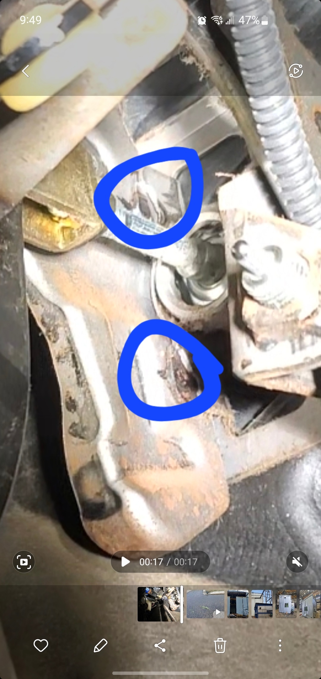

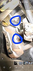

Checked the clutch pedal bracket? I just had some clutch issues which were caused by failed welds on the pedal bracket. This caused the clutch to be only partially disengaged which made shifting difficult when the engine was running, reverse almost impossible since it doesn't have a synchro
Attached Thumbnails Clutch issues-received_1264858750871086.jpeg   Clutch issues-screenshot_20230723-214946_gallery.jpg

i'll check the clutch pedal but i was under there for the master and things look ok. but a second check couldn't hurt. thanks

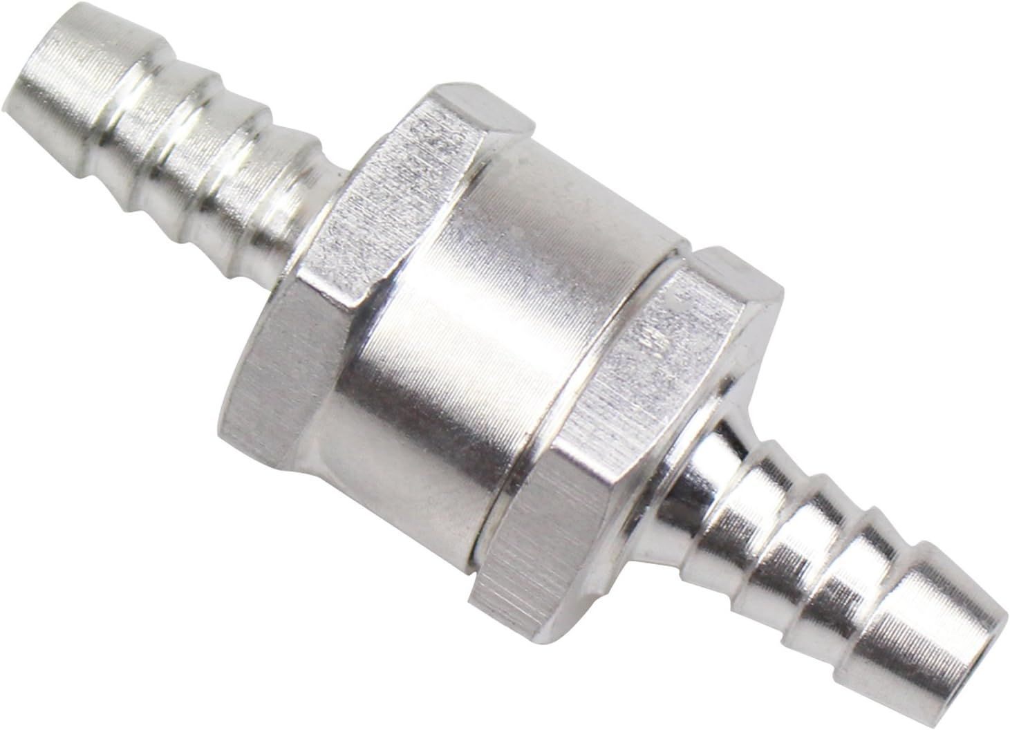

eliminating all the factory tubing made the clutch easy to bleed buy myself with a 1/4" check valve and vacuum hose..
