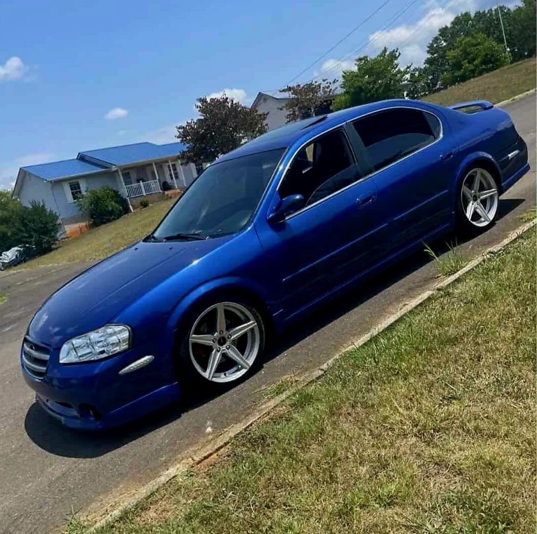

Hey guys,
I'm new to this one, not to forums but it's been a pretty long time. I just obtained this one to use as my DD. 02 3.5L 5speed. 200k miles.
Shes's back to factory height right now, but I'm going to put her back down to around this height. I'm thinking about the Rev9's Hyperstreet coilovers. They seem like a fairly good "bang for buck" type thing. Thoughts or recommendations or advice?

It's def an 02, but 5 speed, unless my shifter is mislabeled or something lol. I've never owned any imports just domestics and minitrucks

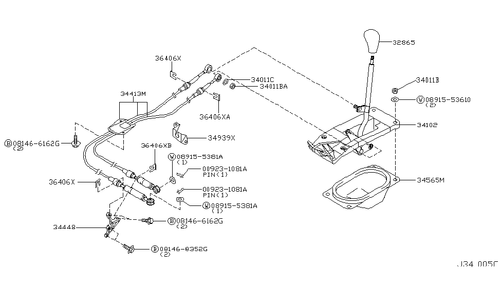

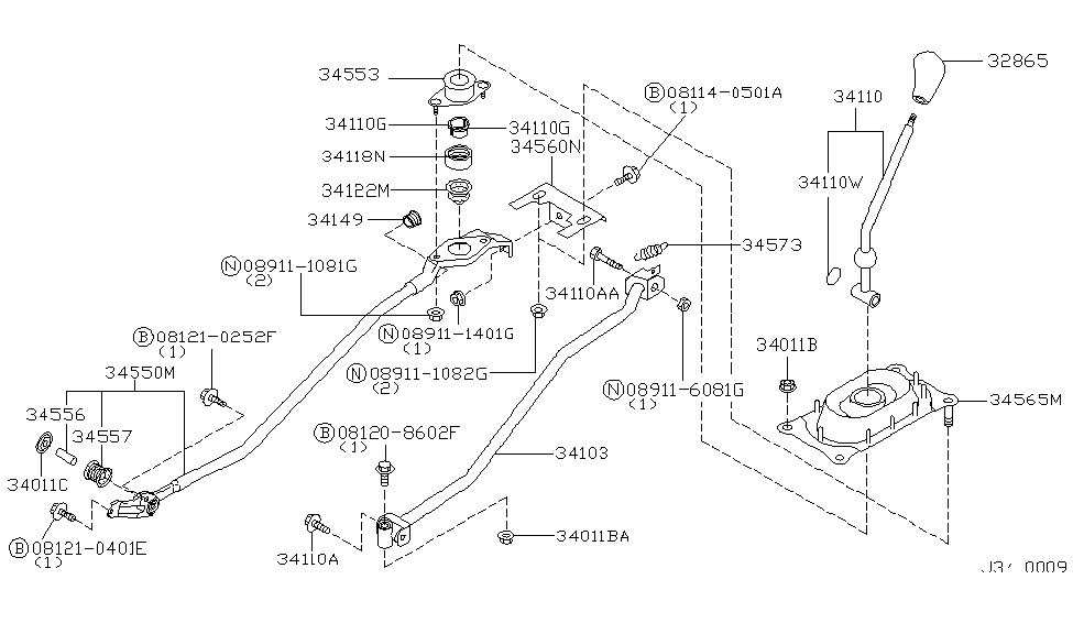

Best way to check, 6 speed uses cables for linkage between shifter and transmission. The linkage is on top of the trans at the back.
5 speeds use metal rods/tubes, the linkage is under/behind the trans.
6 speed linkage 2002 or newer model year
5 speed linkage 2001 or older model year
