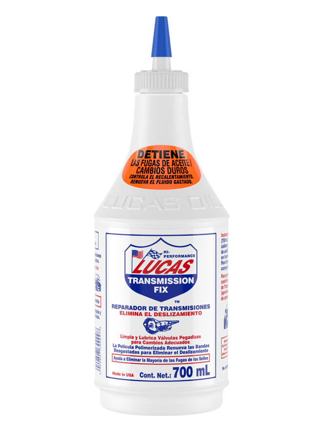

Hello!Just entered the community!I have a 2003 Maxima with an automatic gearbox, when the car shift from 1st to 2nd, 3th to4th, or shifts down gears, it basically shock the car a little bit, like it's a hard shifts, sometimes when the temp is low it doesn't do that infact it is much smoother, but after maybe 15 mins it starts to do that, I heard the lucas oil transmission fix does help the car shifts much smoother, but I'm a little bit affraid, the car has more than 300.000km, and I don't think my father did changed the trans oil ever before, does lucas trans oil help my tranny to shift smoother or I gonna blow my tranny?

Yes indeed, I do check the oil level regularly and it does burn oil very fast and I change them the engine oil in the correct time, the thing is that I checked the ECU of the car and there are no issues or faults about the transmission, I want to know if lucas transmission oil fix any good for my transmission? or does it help reduce those harsh shifts?

Some people call it snake oil and some swear by it. it will thicken the trans fluid. I used a bottle in my oil burning I35 and it did not make any noticeable difference.

Use the Lucas as indicated. Do not change the fluid if it's never been changed. Lucas is terrific in my experience and with my 2004 (also never changed before I purchased it). Add the whole standard size bottle even if you believe your transmission fluid level is full. It's okay. Lucas says the same thing but check before using it of course.

I checked the transmission oil level and it seems fine for most of the time, how to add the lucas bottle to the dipstick, does it need to be the car cold or warm? Is there are somethings to do during the process when you use it on your 2004?
