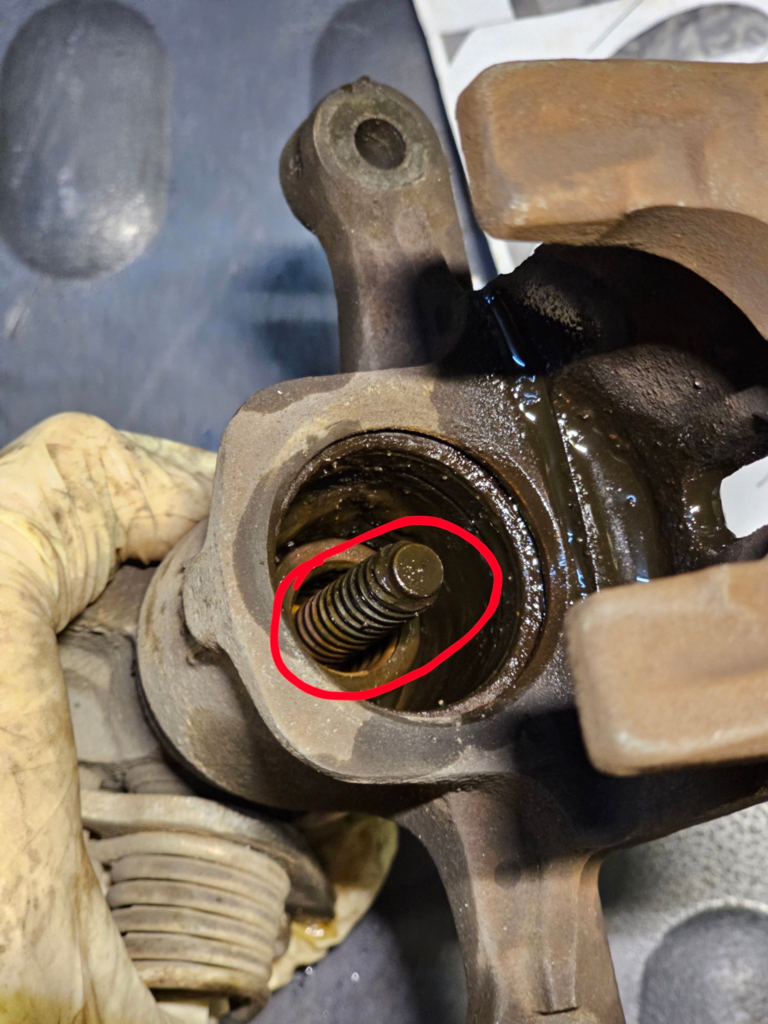

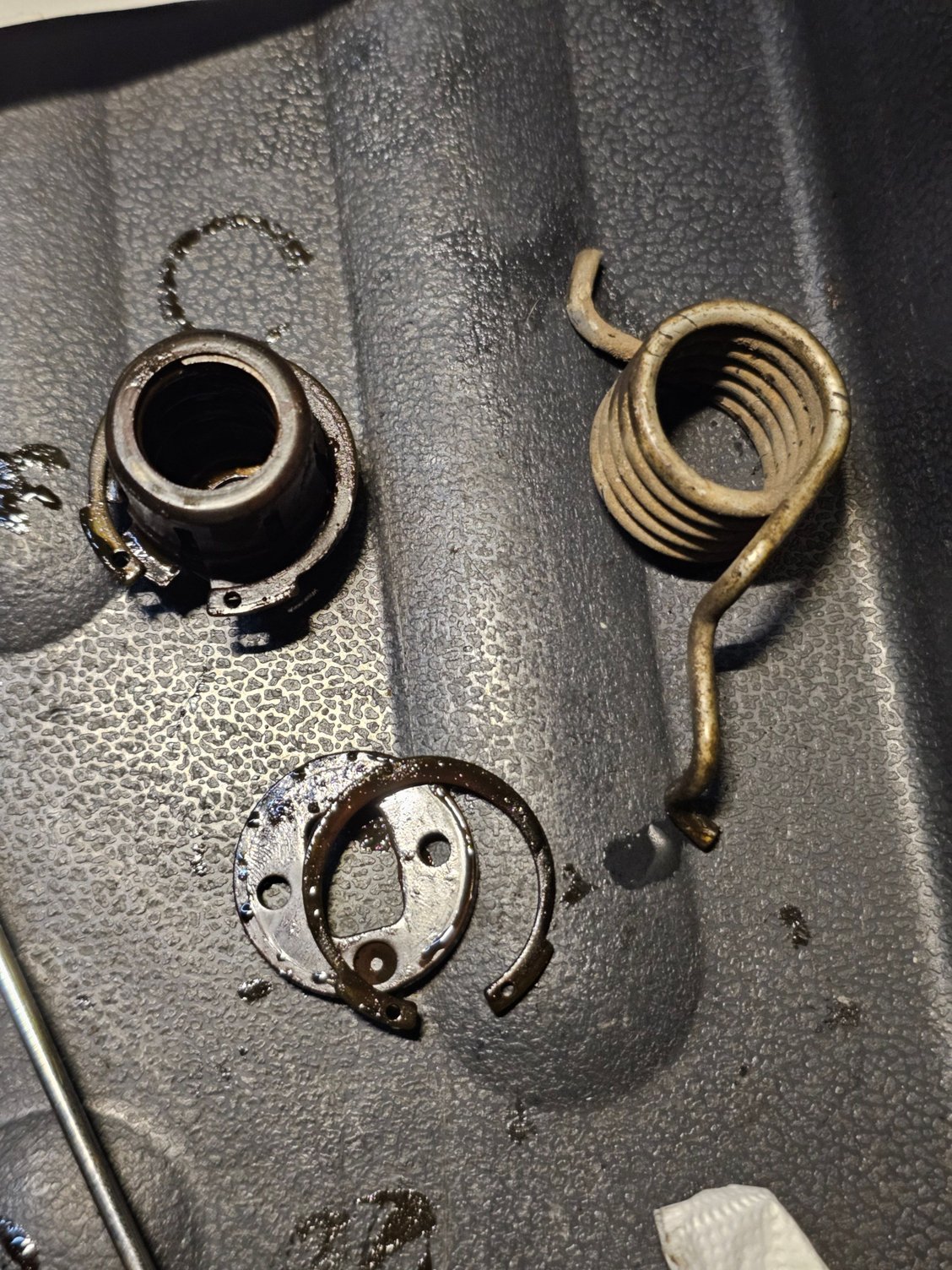

Hello everyone,
I'm in the middle of rebuilding the rear brake caliper, but I have no idea on how to remove the center push rod from the caliper, FSM says remove ring C, then keyplate, and then push rod, but mine is just stuck inside..... Anyone here mind to share some tips?
Thank you very much
Update 1: Did try using pliers to pull it out, no go, and damaged some threads at the push rod.

Thread a nut or 2 on the threads then grab it with pliers!

Thanks for the tips, but I just gave up and only rebuilt the basic brake section. By the way, the parking brake mechanical section for this caliper seized a long time ago. Maybe this is why it's so hard to pull out the center rod.
