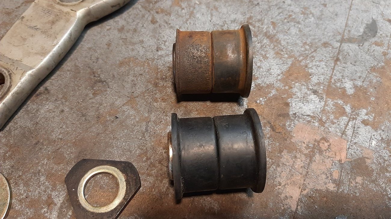

I had ES bushings. Pulled them off after about a year due to movement of the control arm (the OE bushings are bonded so the arm cant move fore/aft. The ES bushings are simply slipped in) allowing metal on metal contact between the arm and large washer on the front bushing. Im not the only one that had this issue. The OE bushings are perfectly fine if you dont allow oil leaks to happen.

The ES LCA Bushings I installed were great and were still in excellent condition once I damaged the LCA hitting a culvert at 45-50 mph. They had been installed for approximately 4 yrs. They transmitted a little bit vibration than the rubber bushing but it wasn’t horrible. I want to now why you seem to be eating up LCA bushings? A possible oil leak?
