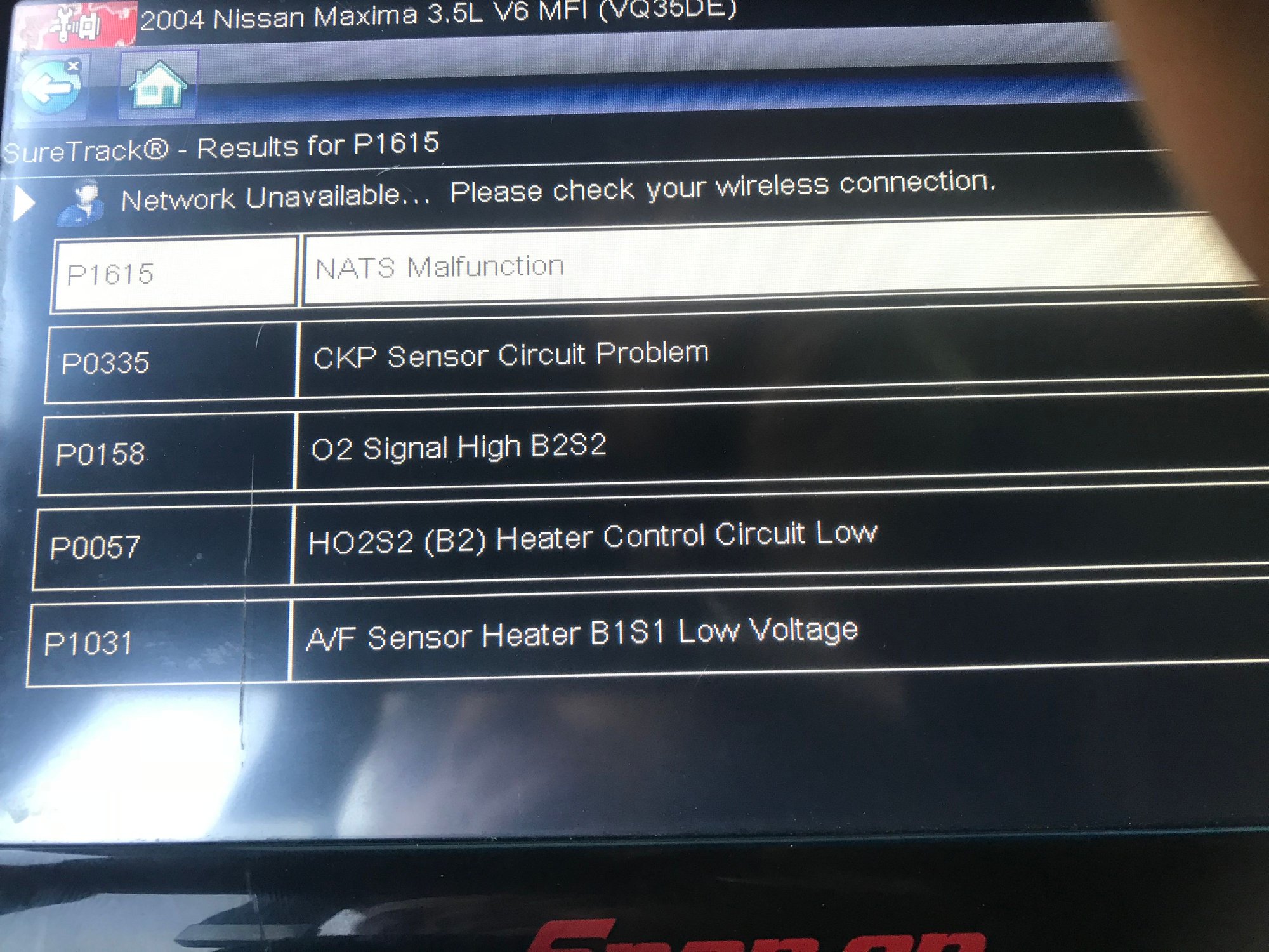

The codes I have are for the crankshaft position sensor (the flywheel is missing teeth) which I had for about 6 months now and o2 sensor level high. But I also grabbed and tugged pretty hard on a 3 wire connector (brown in color) that runs in the same harness as the ignition coils and fuel injector connections. I will take a pic tomorrow. I dont know what it leads to, but its routed through the front engine mount.

yes! Unfortunately, it was the clutchplate / flywheel missing teeth and its warped. So there was no constant signal being sent to the computer. Getting the whole transmission revuilt as we speak!

Posts: 174
ya also need to fix that nats issue. it will lock down the whole vehicle
