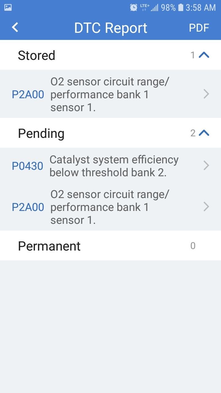

Only codes i get...ive erased them an they havnt returned

Like they say - your pre-cats are plugged.
