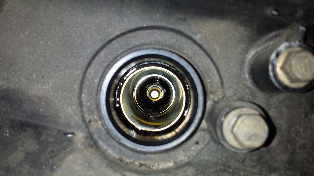

Oil in tubes look likes this.

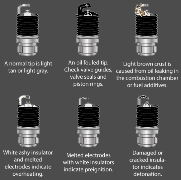

How to read spark plugs.

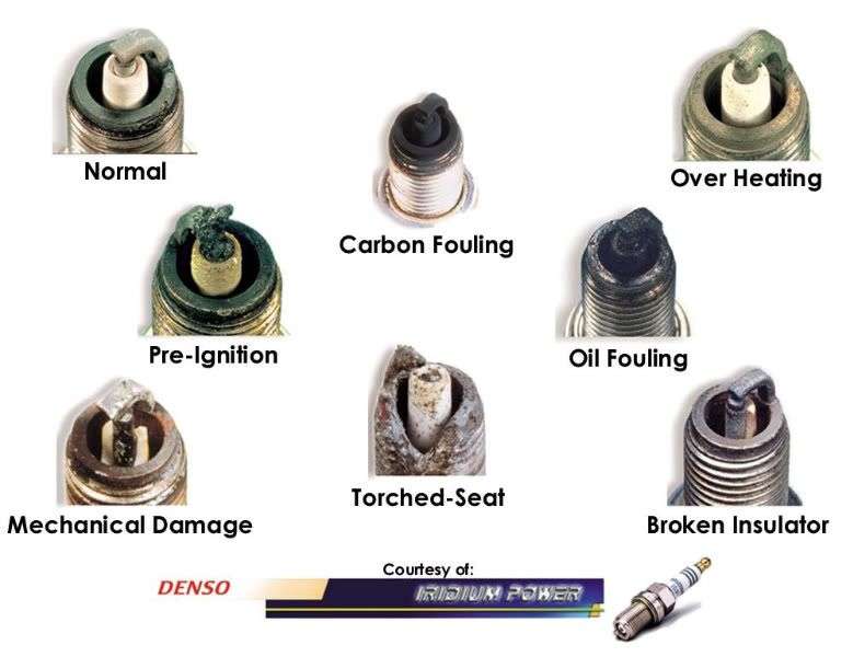

Better pic of spark plugs.
