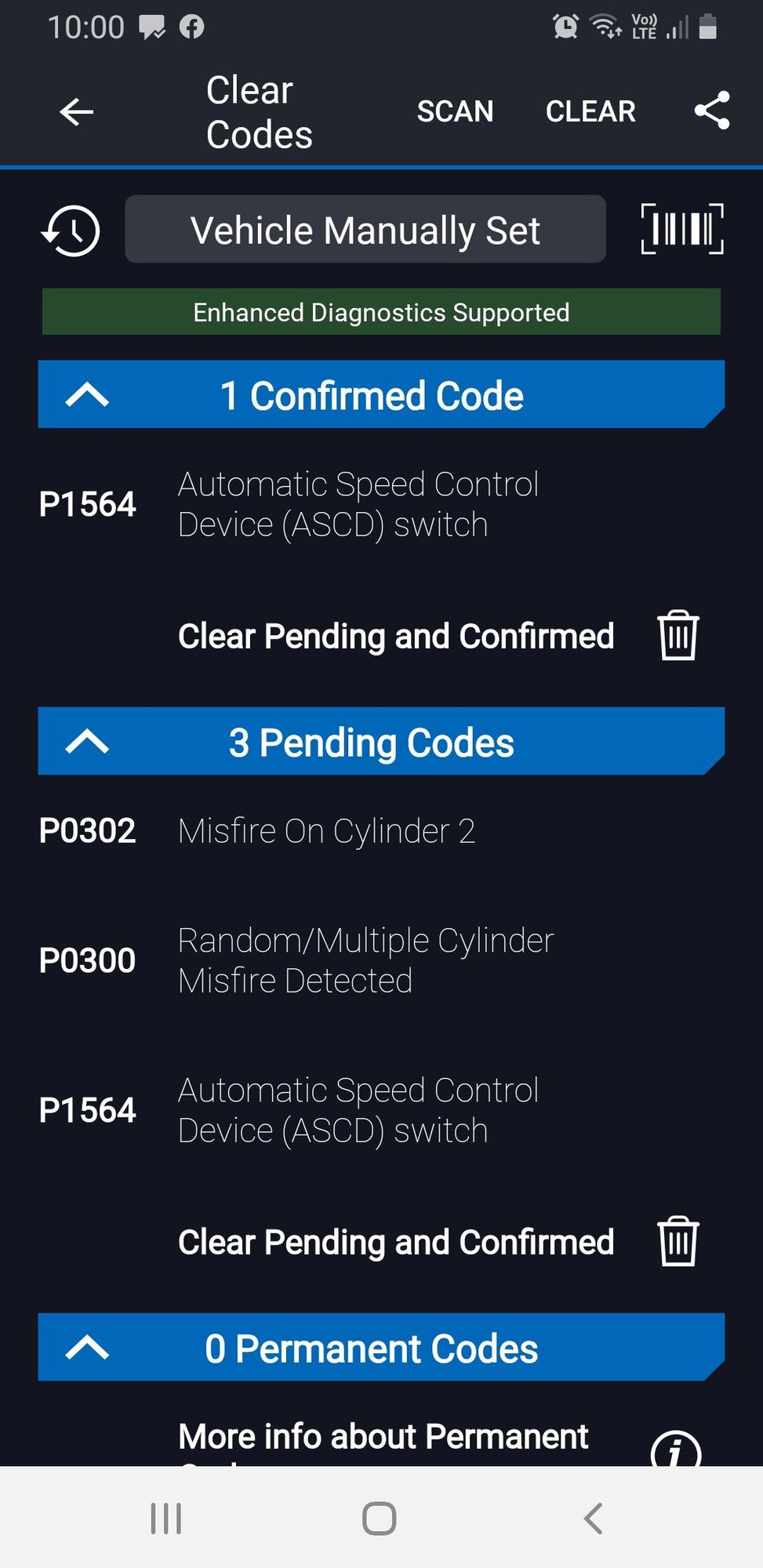

New code P0300.. Random multiple cyl misfire detected
Originally Posted by Gerry_007
ok, where is thos cylinder 4,s location please.
ok there's good and bad news, bad is some.where along the way I read "the bad news is i,d have to pull the intake plenum off" .. God knows how i managed to get mixed up is a mystery to me, but u defo read this but must have been in a different post in my hast I did all this while waiting on someone kind enough answering me which cyl is which.. so anyways, good news the intake and related parts are all back in situ now(I can't remember when I last had that much fun, think it maybe it was the first time I soiled myself back in preschool days ... In the process I,ve swapped number 4 platinum sparkplug and also the coil, and ordered a full set of both from online store, so when they arrive, I,ll replace the lot. (Sparkplugs and coils.). Now I have the other issues to deal with any suggestions on what to do with them? Just to get me started on my new quest ..cruise control, my horn, and can only get reverse and not the individual gears function ( meaning when I select + or - whilest driving nothing happens other than staying in D drive. Thanks in advance
quest. see new screen shots for the codes
Last edited by Gerry_007; Aug 31, 2023 at 07:06 PM. Reason: Took it for a drive and now get this new code

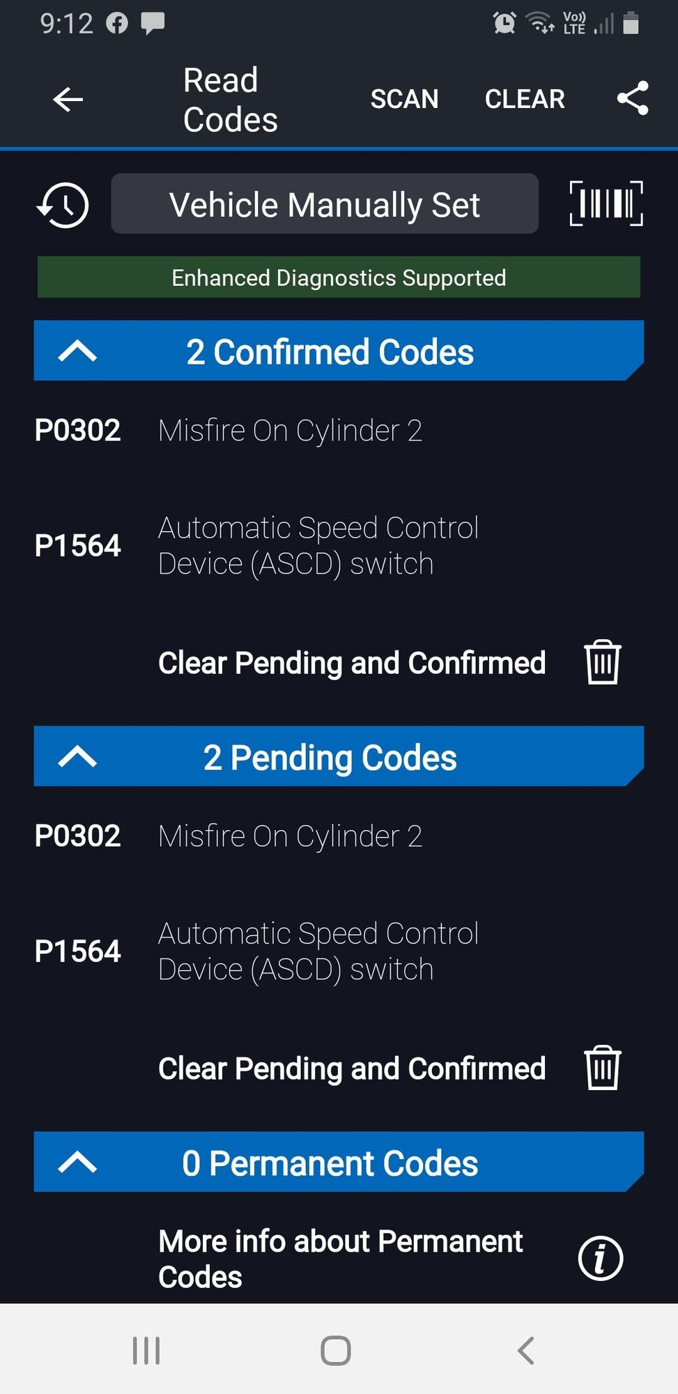

All sorted as far as engine running badly thanks so much for your help as i changed the front 3 coils and plugs and now to find out how to deal with the rest of the codes P1564 ?
