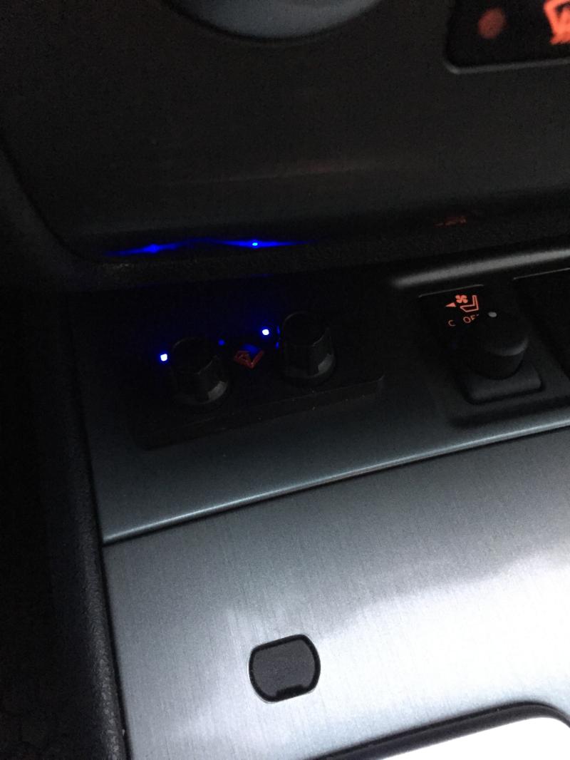

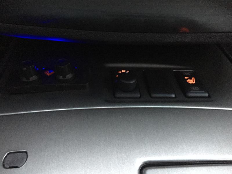

Originally Posted by andremike
Someone posted a picture of the base control **** next to the key slot.. i cant seem to find it. does anyone know where its at? Was that difficult to do? I am trying to figure out where fo put mine..
That's where I have mine installed too. Name:  54076B40-F601-4D1F-9C57-310D781B129E.jpg

Ok So I have an appointment for the sub install Saturday. I ended up buying an lc2i and the remote **** for it. Where have you guys installed the remote **** at? The picture above is a different style then the one I bought: http://www.crutchfield.ca/AudioContr..._p/161ACR1.htm
This one looks like it's designed to go under the dash, just curious where other people have put it. I was thinking inside the center console where the power port is, but not sure if the shop would be willing to do that or how much they would charge for it.

Ya. That's the way I did it, put the **** next to the key slot. I had to dremmel it out, but I couldn't be happier with it.
https://maxima.org/forums/7th-genera...mote-line.html
I really liked this, but with the setup for the remote **** for the lc2i it does't look possible, I was hoping someone who installed the lc2i remote **** found a good location for it.
