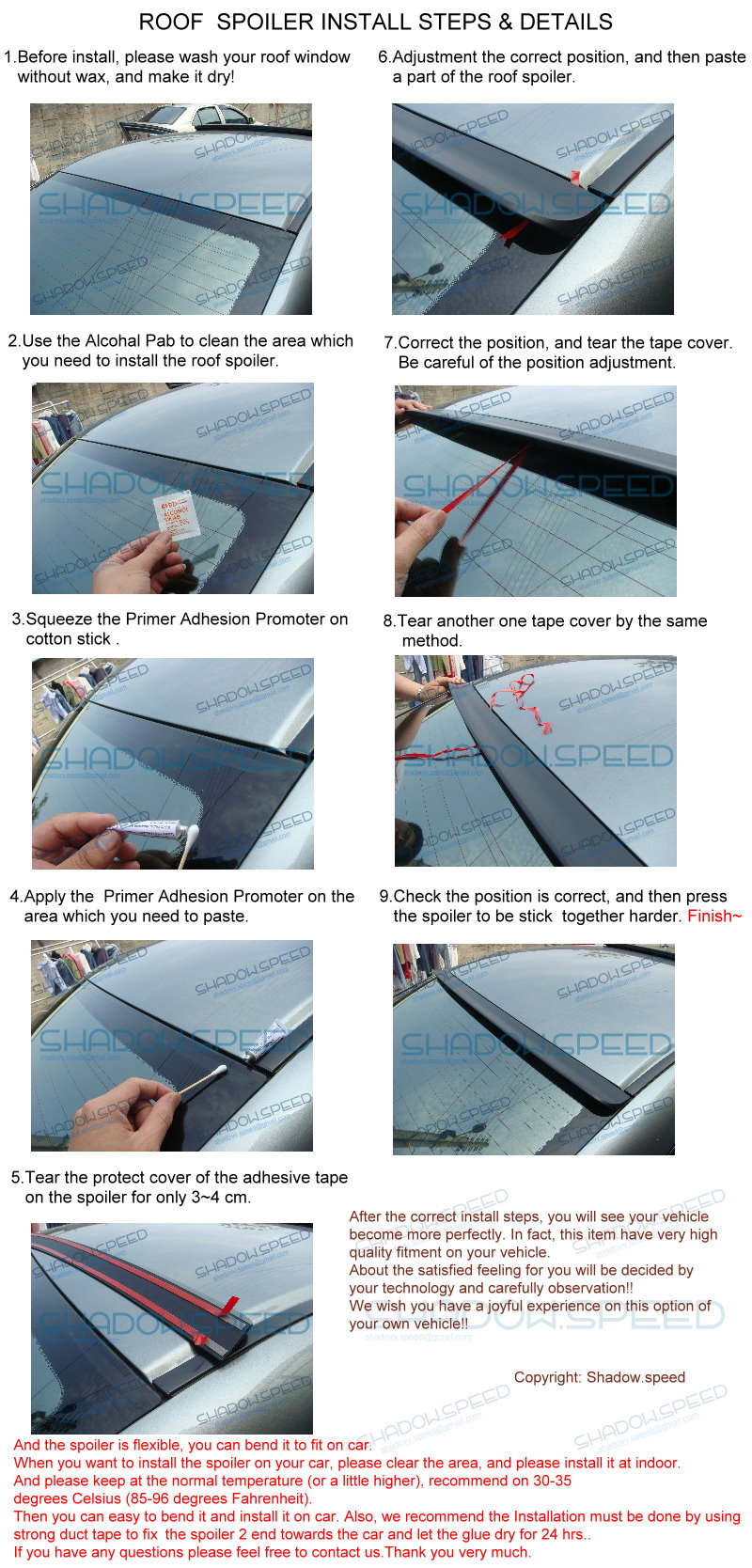

I washed and dried the entire car before installation. Then use 100% isopropanol the top few inches of the rear windshield. Let it air dry for a couple minutes. I used 3M adhesive promoter (06396, sponge applicator). Spread it over the area you are adhering the double sided tape to. Semi dry for a couple minutes then affix the spoiler.
It's my understanding that you don't need to use the adhesive promoter but if you want that thing to stay there ...
Tips:
You'll need to peel away a couple inches of the red backing before placing the spoiler on the windshield.
Make sure you get it centered because the spoiler is about 1cm shorter than the top edge of the windshield.
Having another person hold the other side of the spoiler in place is very helpful.
After installing, apply a coat of wax.

You don't have to wash the entire car. I just did it because I was going to do that anyways. I try to wash it once a week anyways.
In terms of fitment, just take a piece of painters tape to mark off placement. Then have your friend hold down the 'taped side.'
you peel off your end and affix it to the window. if you start on the driver side, pull the red plastic covering off with your right hand, while following behind with your left hand pushing down on the spoiler. Take a break about halfway through and apply some constant pressure to the areas you just worked on.
Switch positions with your buddy and have him/her apply light pressure to the areas you just worked on. Continue removing the red plastic until finished. Make sure to let it sit for a few hours to let the adhesives cure.
This probably works better when the weather is dry and hot as opposed to freezing and snowing. Which is why I waited 4 months to install mine.
WRT to waxing ... just wax it as if the car came that way. If you took your time affixing it t the window the thing will stock.
Oh and important last step ... stand behind your car about 20 ft snap a few pics and admire your new addition.

I also did it myself, I would try and bend/curve the wing a little to shape of the glass before installation. Should do it in sections. I peeled a little from the ends out as well I cut the middle in half and peeled it in each directions. The directions it came with is pretty self explanatory. Here is the link:

Read my posts above about the fitment. The spoiler is slightly shorter than the width of the rear windshield. Make sure you get it centered the first time otherwise it'll be cockeyed.

Elevit, it is best to have a helper to bend it a bit to fit. I did it myself and am off by an eight of an inch on one side. Nobody will ever notice except me though.
After 16 months in all weather, the 3M tape still hold firm with no additional adhesive, if that helps.

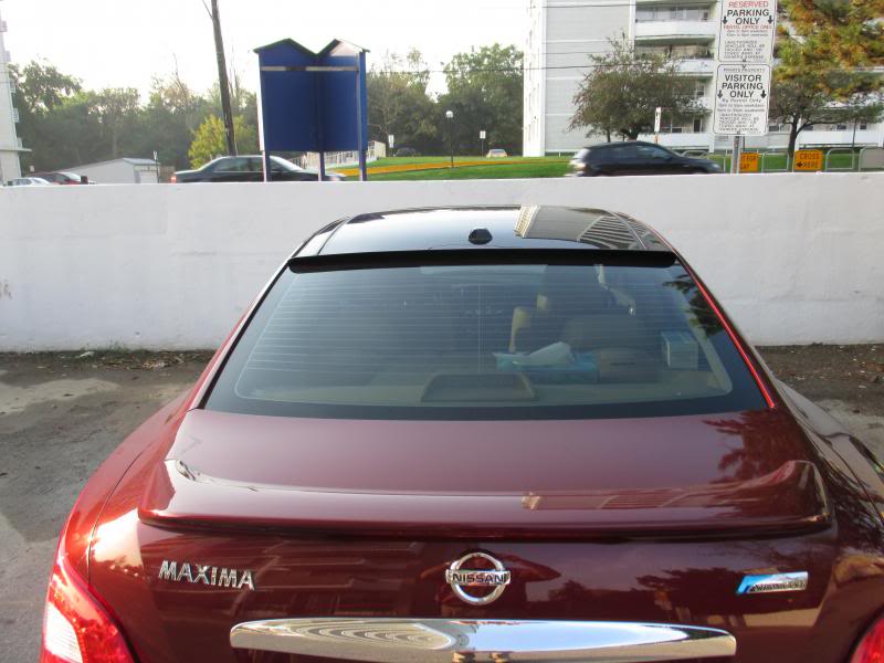

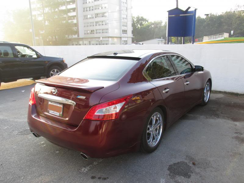

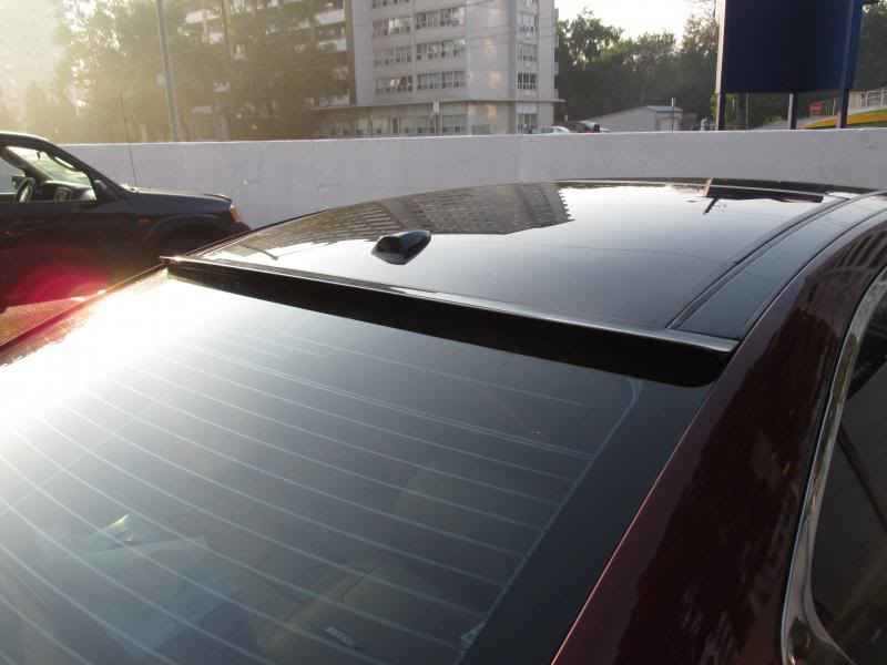

Last weekend was warm and sunny and finally I had a chance to install the wing. I like the way this small mod looks, and the installation was rather easy too. I hope it'll hold for a long time.
Thank you very much guys for all the tips and advice, and to the OP - for creating this thread.
Here are a few quick pictures...
