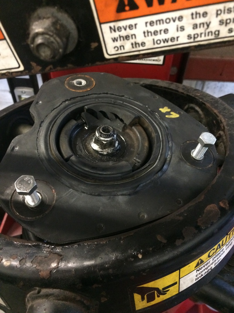

I finally found out why my eibachs have been makin noise
Old Jun 26, 2015 | 01:07 PM
official_style's Avatar
Joined: Apr 2014
Posts: 220
Also, the strut bearings are bad on both sides. Car is a 14 with 18k on it. I'm really happy right now 😡

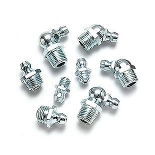

sorry I misspelled it, its grease zerk, here is what it looks like. Racing line site is down, so I can't tell you if they have serviceable joints or not.

I was confused for a second, but then looked up racing line site, which is now up. Yeah, they use completely different style end links with bushings, vs oem style with balljoints. I guess your best bet is talk contact Racing line and ask them what if any lubrication is required for endlinks. In their online instructions they don't mention anything like that.
