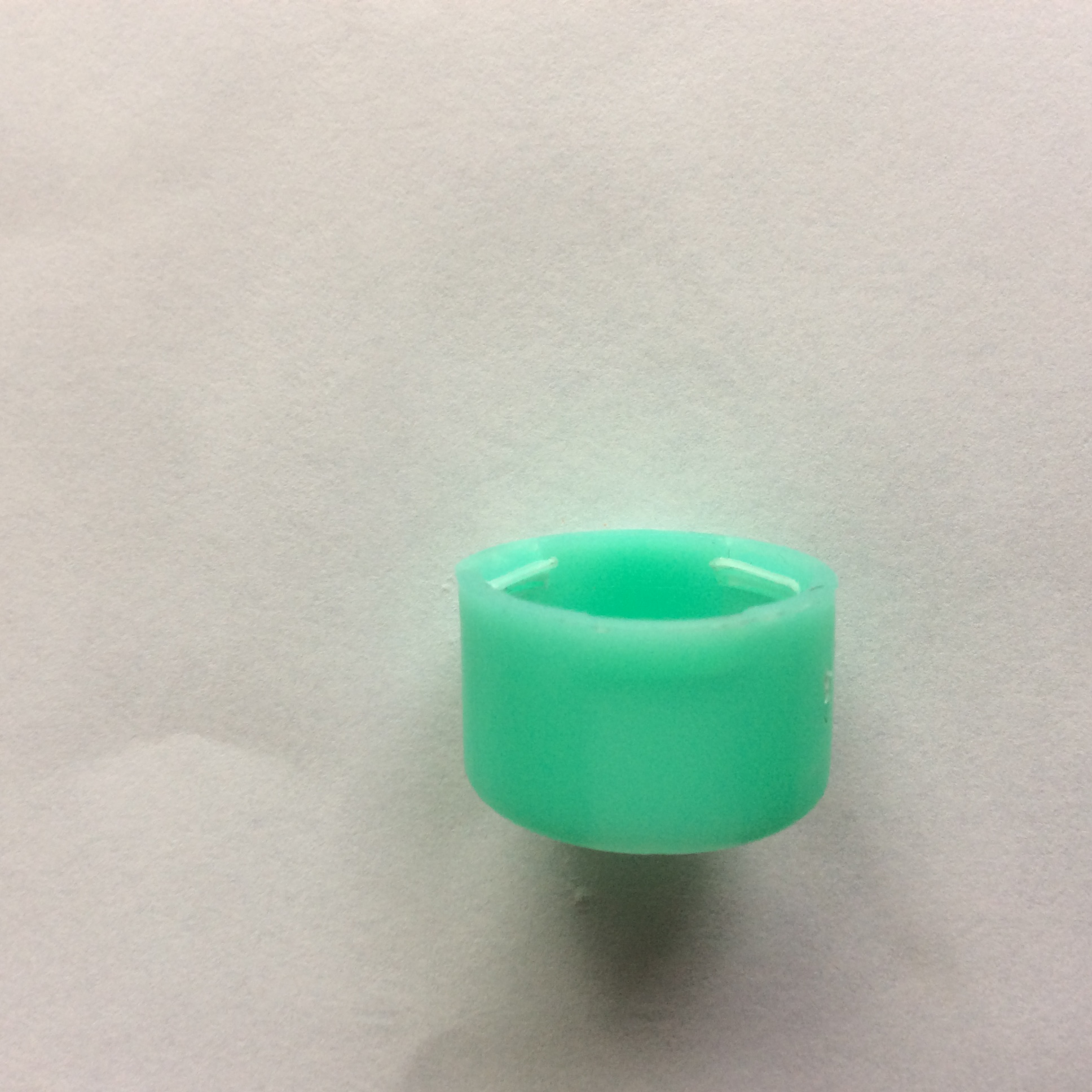

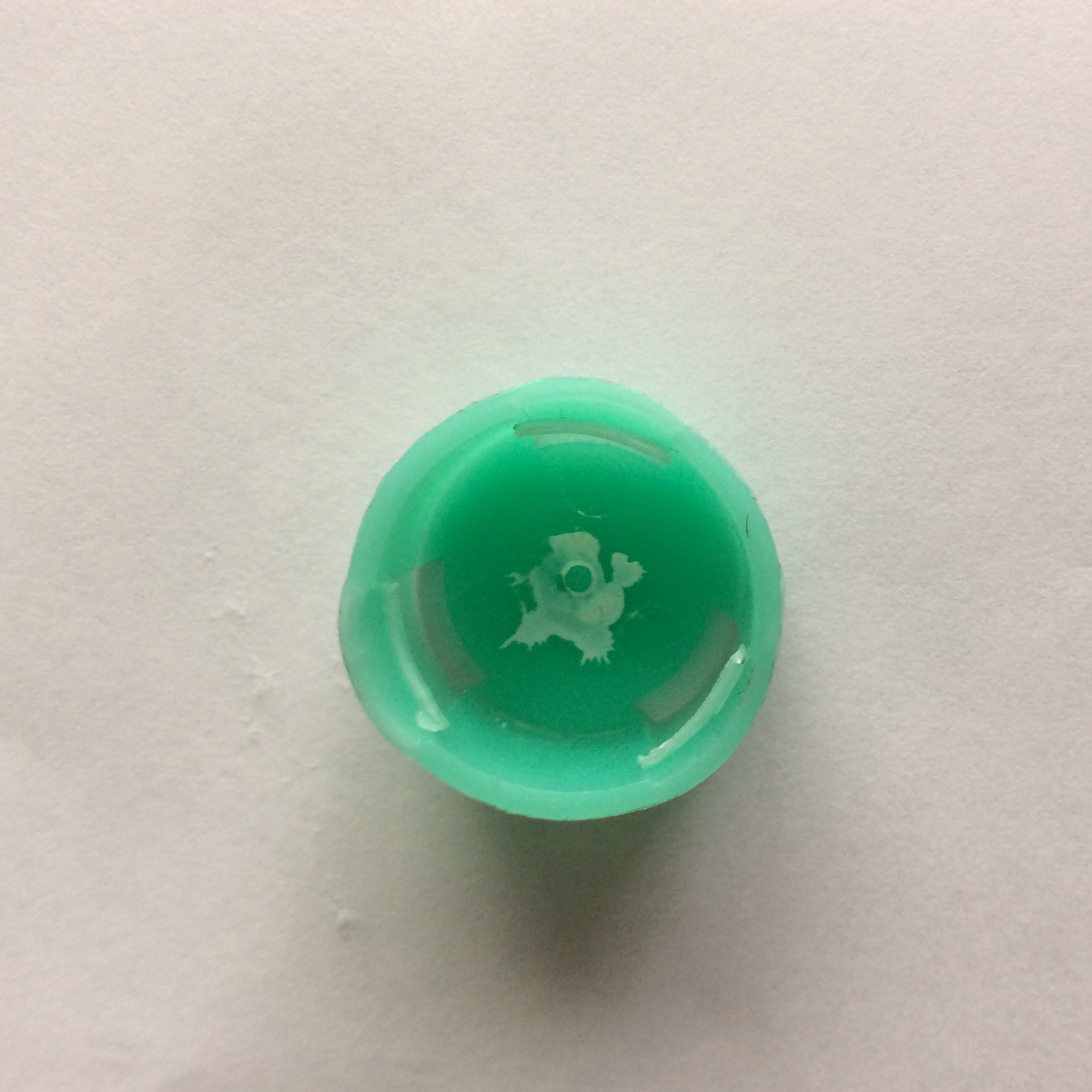

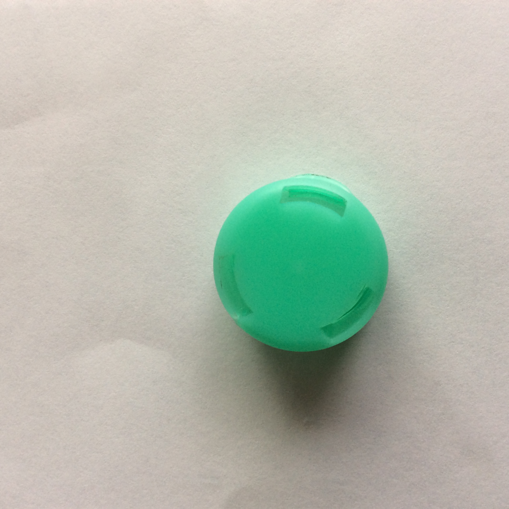

The day after everything is normal ! but in the afternoon coming back from the grocery some plastic cap fall from inside dash to my foot. I don't know what it is for.
)The day after everything is normal ! but in the afternoon coming back from the grocery some plastic cap fall from inside dash to my foot. I don't know what it is for.
300,000 mile trip? That's a lot of potty stops. I went out and crawled into the drivers foot well as well as I could but couldn't find any green cap. I didn't see everything under the dash as I am not a limber as I once was in my younger years.
I too would like to know what the cap is for... I recently removed the lower panel to install a remote start. The same green cap fell down.

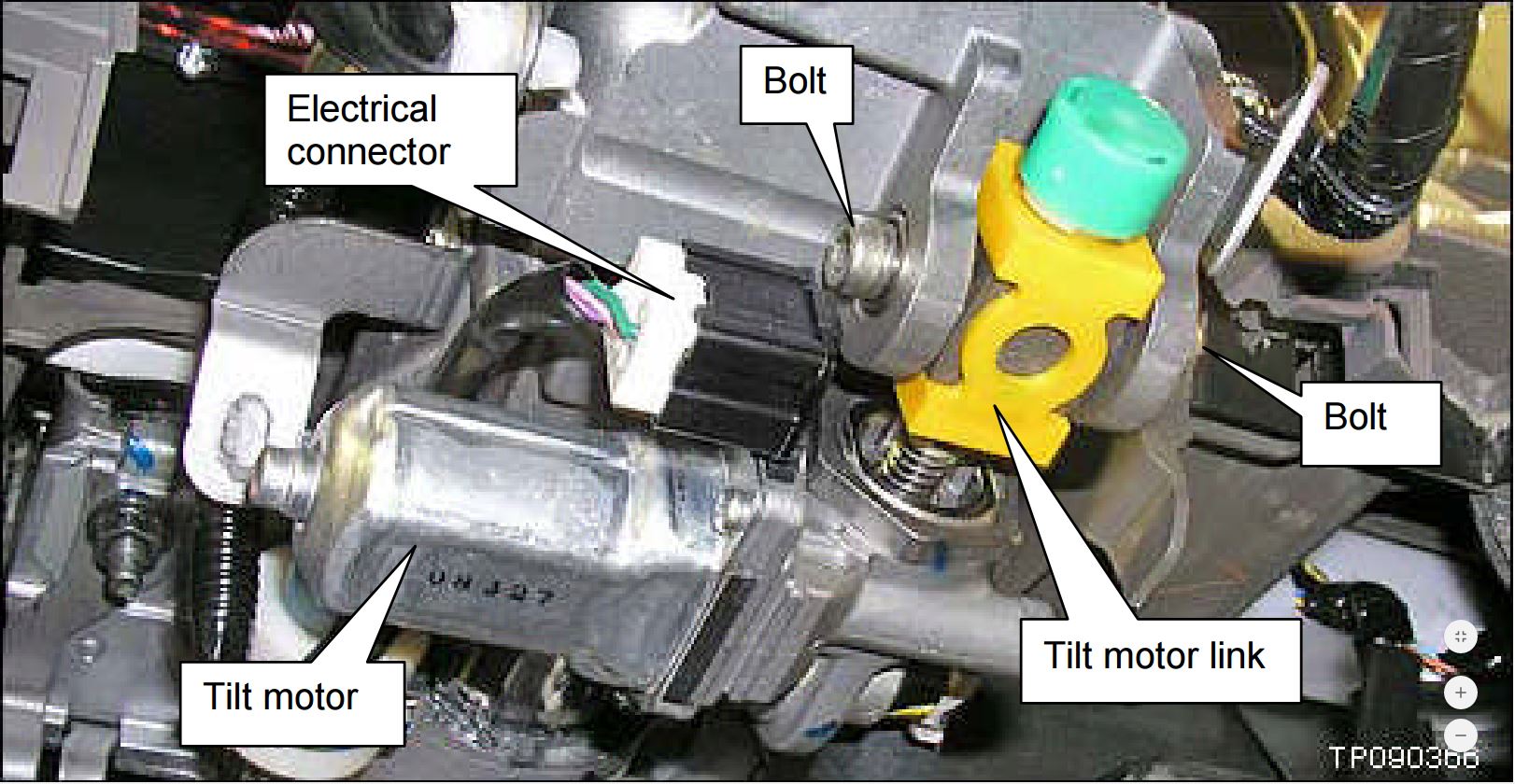

As for the green cap maybe it is for covering a endless screw on the steering column.

On a TSB I found this picture:
