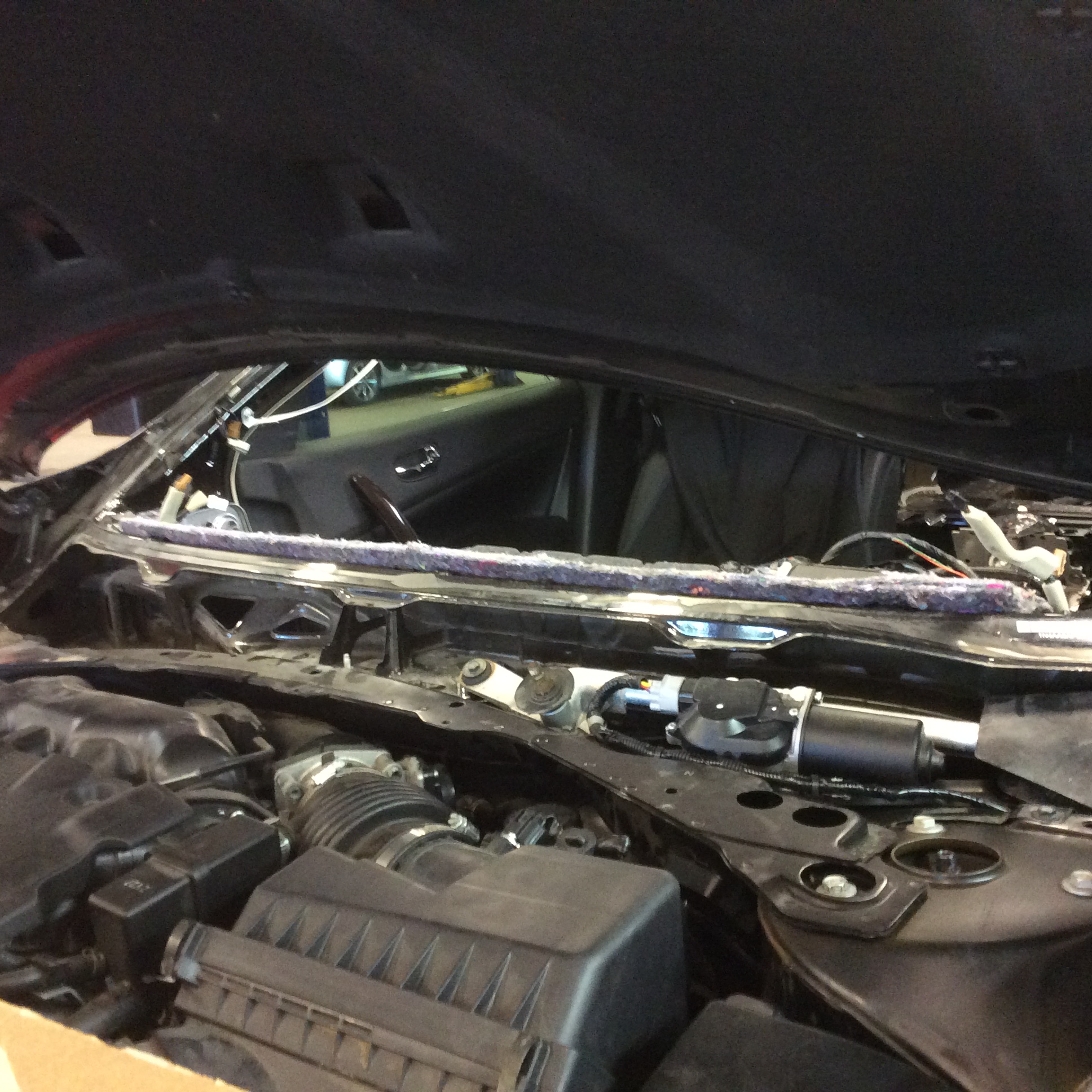

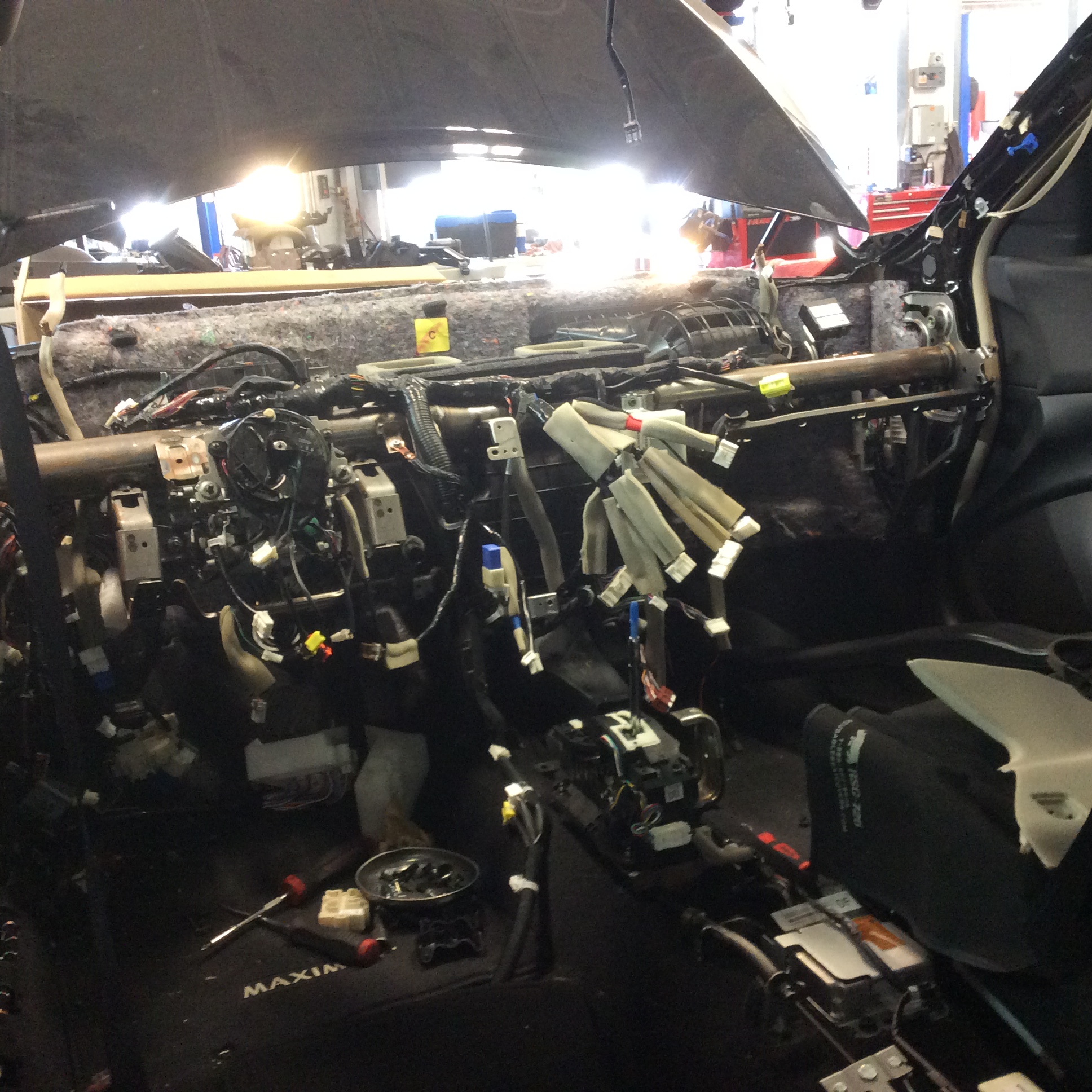

My 2013 max was acting very strange.My auto climate indicated around 20C less than reality and after I noticed that the cruise control light was blinking and I cannot set the cruise control On. The day after everything is normal ! Went to the dealer because the morning after the buzzer continuously buzz. So he dismantled the left underside dash and found water leaking causing shorts and corroded wires.
They found that water was leaking from the bottom driver side of the windshield because of missed caulking from the factory. They changed all the harness that has corrosion on there connector. Replace the windshield and check for leaks before reassemble everything back.
Attached Thumbnails Water leaking from windshield causing short circuit.-img_0094.jpg   Water leaking from windshield causing short circuit.-img_0095.jpg   Water leaking from windshield causing short circuit.-img_0096.jpg   Water leaking from windshield causing short circuit.-img_0097.jpg

I'v got my max back all clean inside out after almost a month of waiting. The dealer did a good job.
They replaced 3 harness : ENGINE ROOM, MAIN AND BODY HARNESS
241012-ZX70B
24010-9DF4D
24014-9DF0D
CONSULT CODE :
B2562 LOW VOLTAGE
B2604 PNP/CLUTCH
P0826 UP/DOWN SHIFT SWITCH
B2110 INTERLOCK/PN OFF CIRC.
WATER ON CONNECTOR B1, B10, M6
