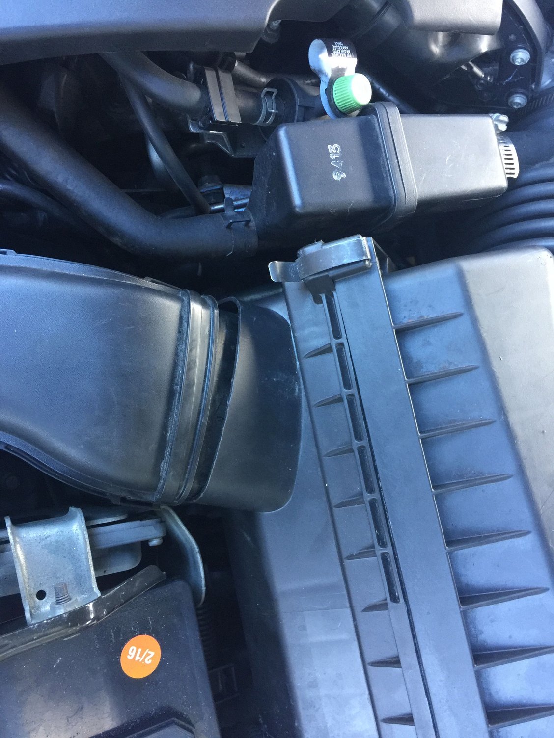

I feel like im filling up my max too often. Im not sure if this makes any sense but I had a stillen cold air intake on the car and went back factory. Now someone put my aftermarket intake in and i put the factory 1 back in and i doubt i missed any steps. Not sure if this is considered a leak in the pic
I put in a new air filter with the factory intake and put a can of seafoam also in the tank to see if it would increase my mpg. I dont think i need a tune up because i only have 72000 miles.Please any input would help. Thank u

That is not a leak.
How many miles a tank are you getting?

That is not a leak.
I didnt think it was a leak either but i feel like around that opening it should be a little tighter. 280-290 with a full tank and that is with me treating the pedal like a baby.
