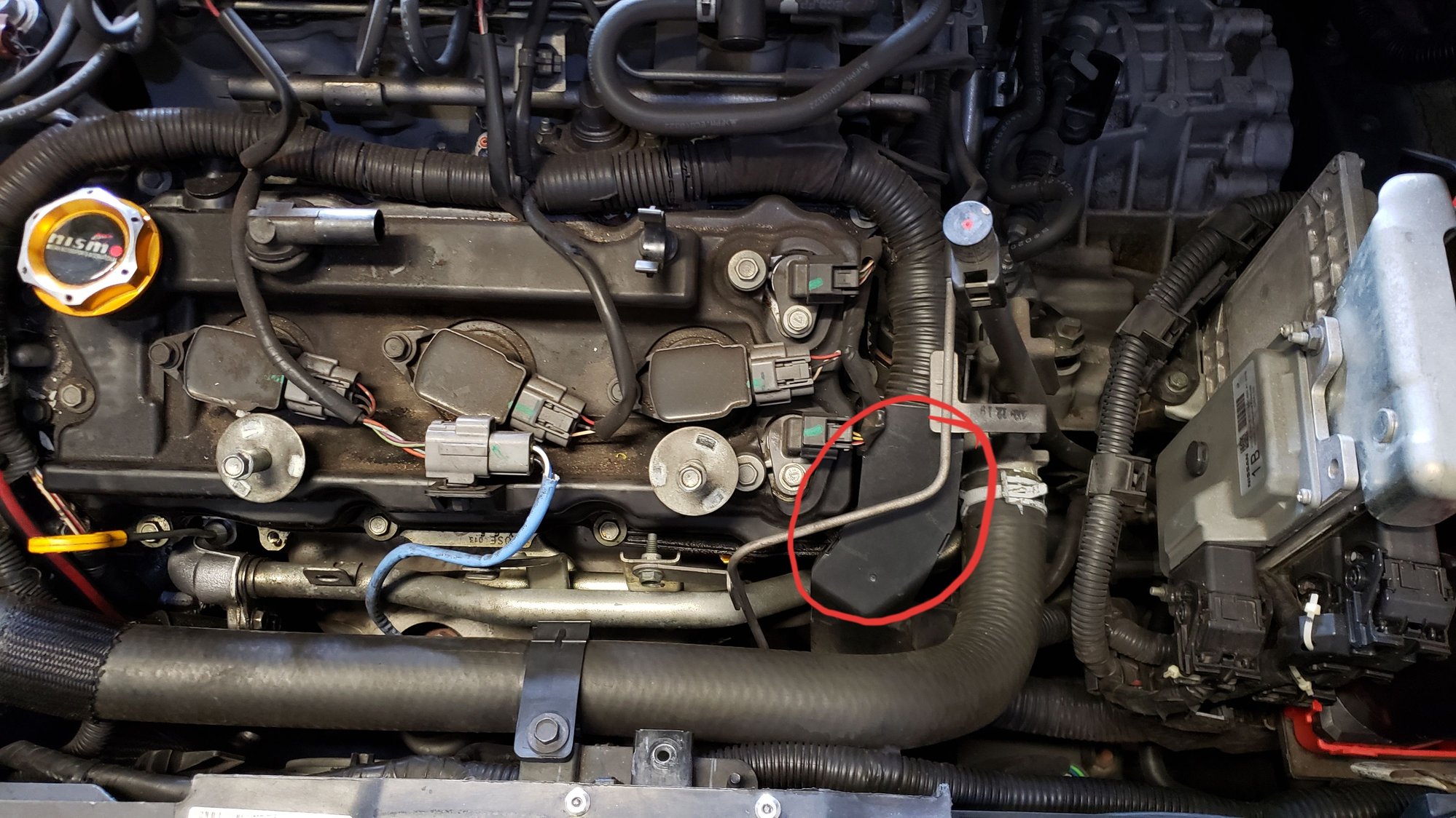

If you attempt the valve covers, keep everything organized, labeled, and take good quality pictures so you can back track if you forget where something goes. Give attention to detail and you get good results. Another way of organizing bolts is to leave them on the part you removed. Leave throttle body bolts on the throttle body and put it aside, valve cover, vacuum rail, vacuum solenoids, etc. You may want to check the condition of hoses before you go in because the vacuum hoses become brittle. I ended up changing all of mine out because some were cracked. Get a good RTV because you'll need RTV on the corners of the valve cover gasket. You'll see it when you remove the old ones. The fire resistant conduit on mine fell apart because it was old and brittle so I ended up wrapping new electrical tape and new conduit onto the harness. Try to keep debris from falling into the engine when taking things apart and if you can't complete the job the same day, cover exposed areas with a lint free cloth. Make sure you have a inch lb torque wrench and don't use excessive force to remove something. Compare the new part to the old part before removal to see if you missed bolts to remove then compare the parts themselves once you're able to. Like mentioned earlier, the spark plug seals are built into the valve cover but the valve cover doesn't come with the valve cover seal itself.

Yes you'll need new valve covers (which aren't too expensive) because the spark plug seals are non-serviceable. For the vacuum hoses, you can get one from any auto parts store. It's a generic vacuum hose that's usually used for washer fluid pumps. Bring a piece of the hose in so they can help you find the inside diameter. It did take a while when I was working on mine but most of the problem came from the conduit on the main harness falling apart. I spent most of my time re-insulating the main harness. If you have the same problem or notice your conduits cracking, remove the broken pieces first and re-wrap it. Also, the front cover will give you problems with removal and installation since the main wire harness is hovering over the right edge of the valve cover. The harness itself has some "give" to it so try your best not to damage the wires. Sorry, I didn't take enough pictures to give a full step by step.
