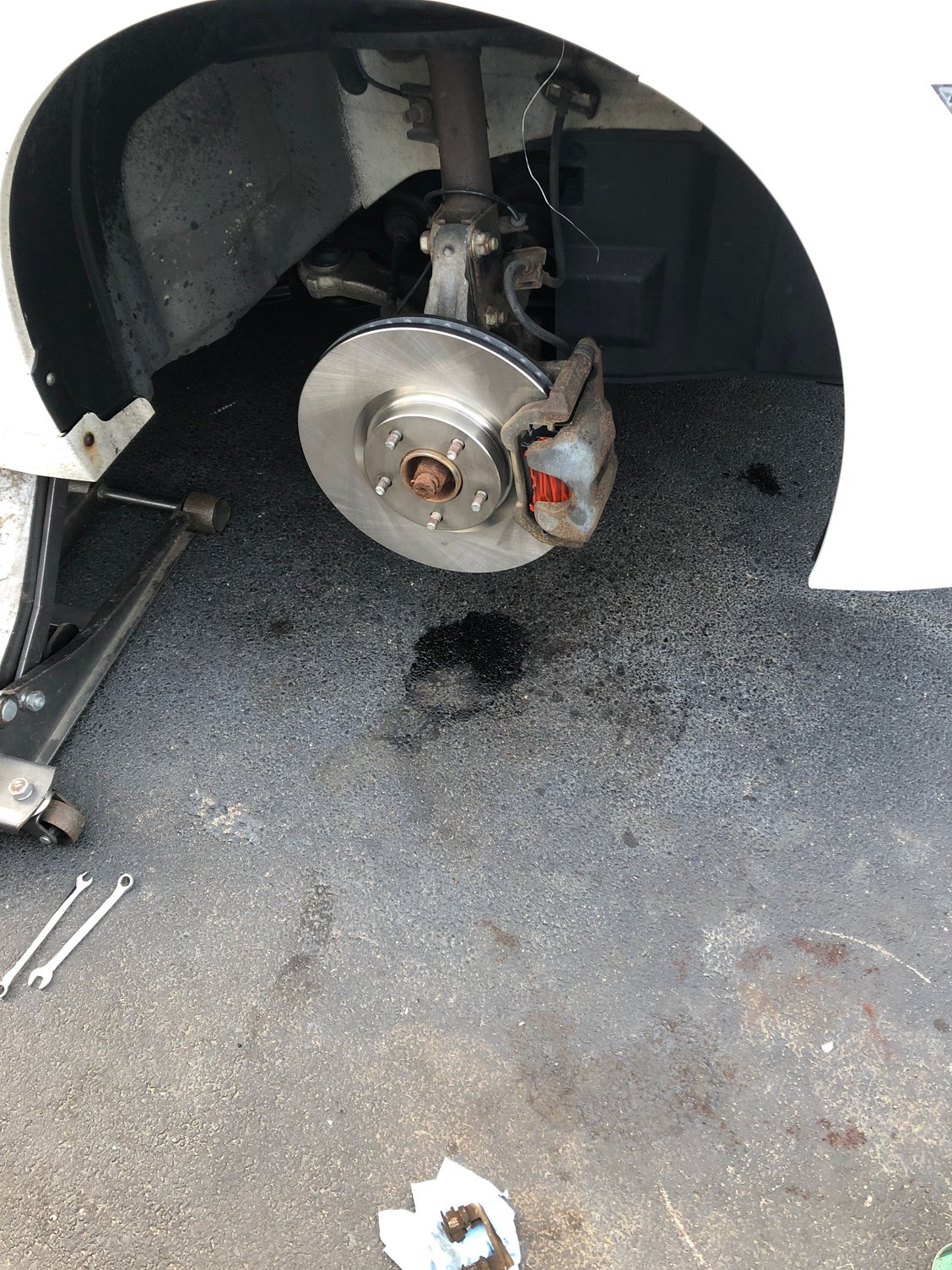

Put new axles in it. And I hope to god that's not where you put the jack when you lift the front end.
Edit: Sorry, wrong forum. Jack location looks good. Definitely axles though.
