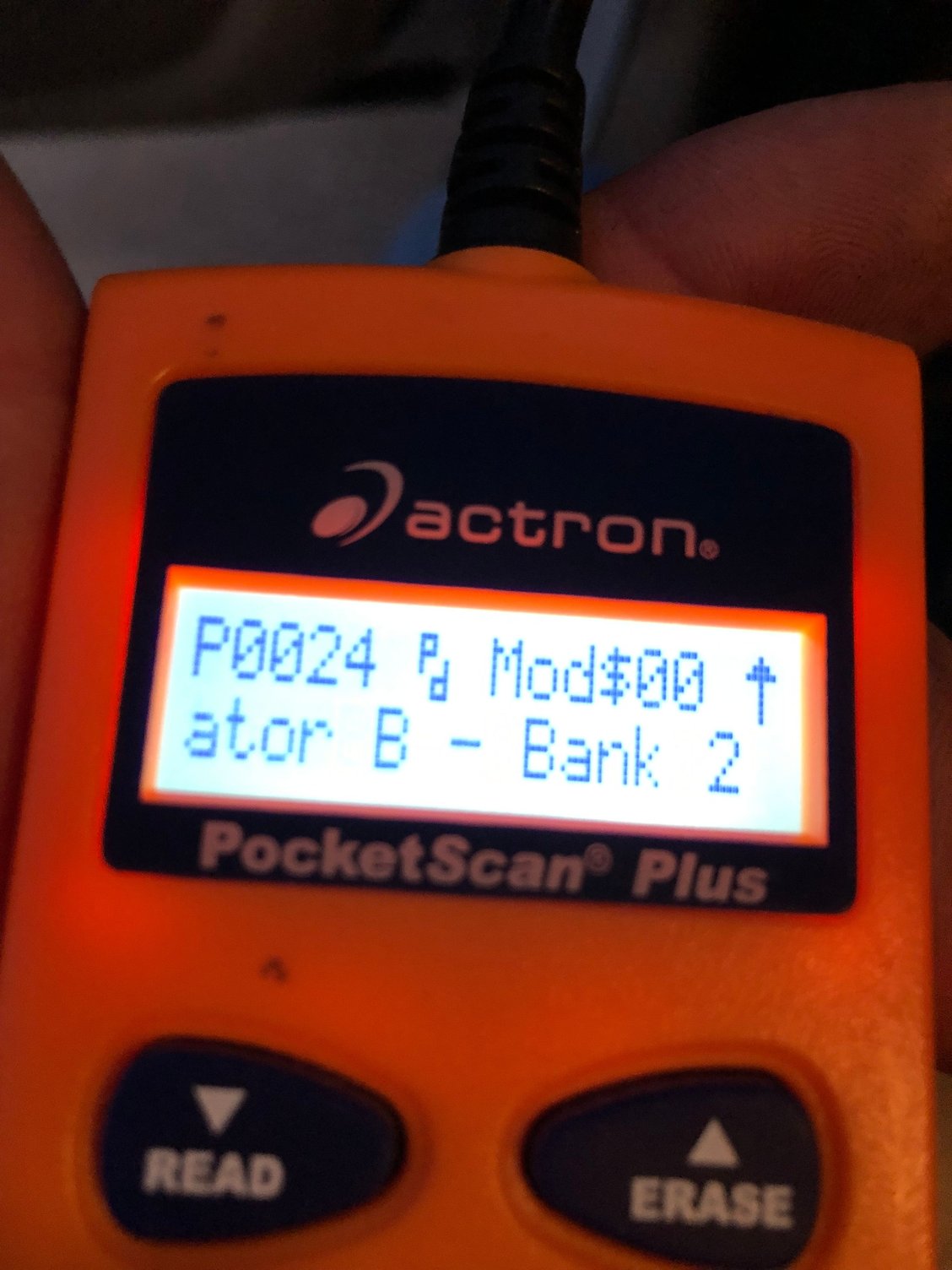

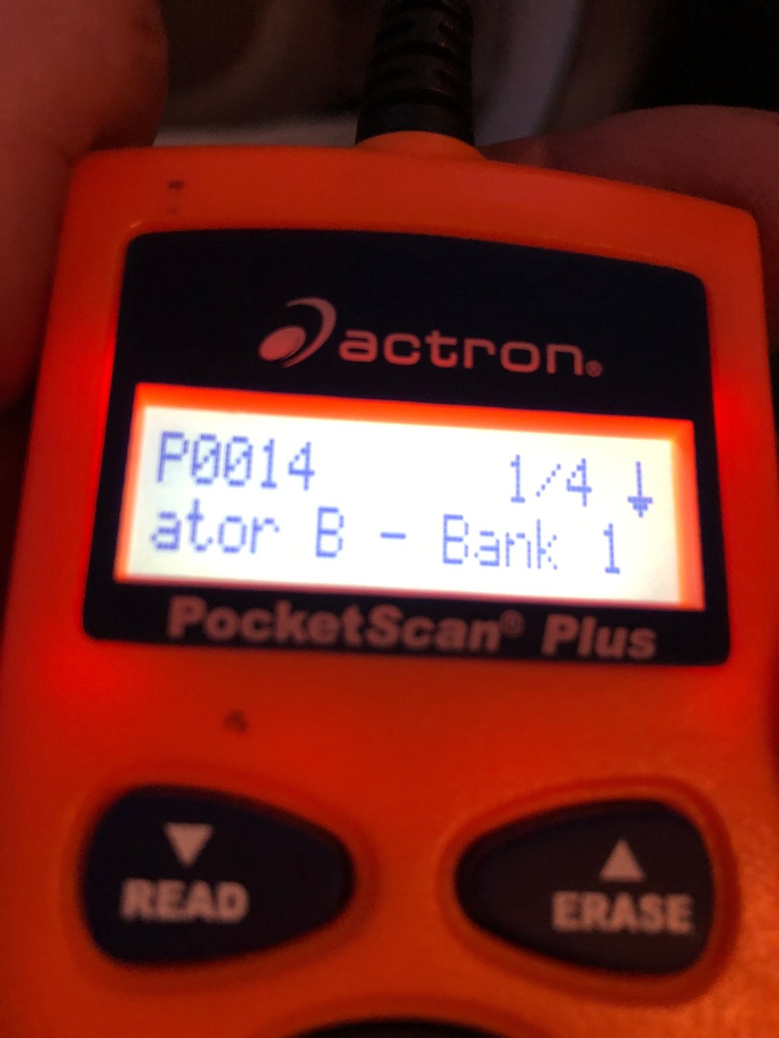

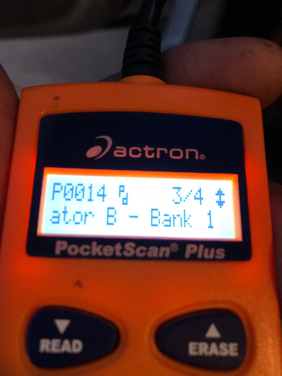

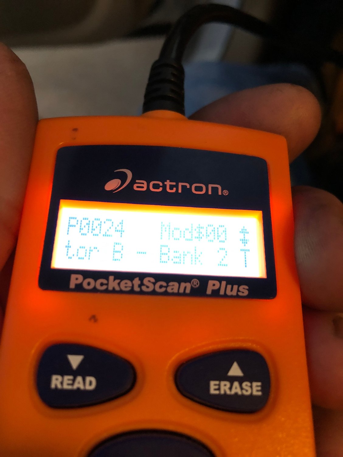

Hey Lt,
I wanted to share the codes that are showing up on the reader…
