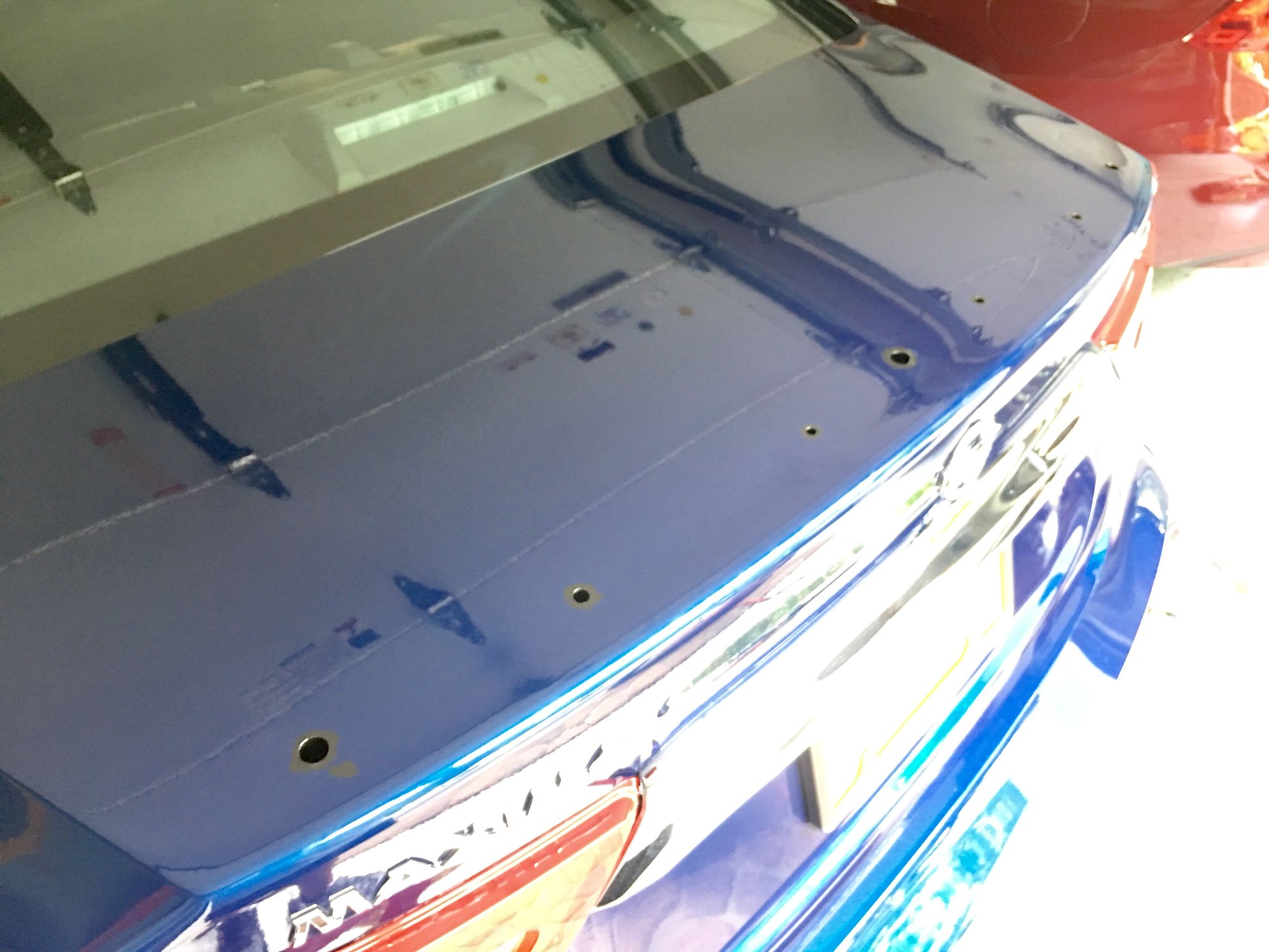

Just installed oem sport spoiler today. Took me about 2hrs.
Ordered on Ebay. Total cost $294.

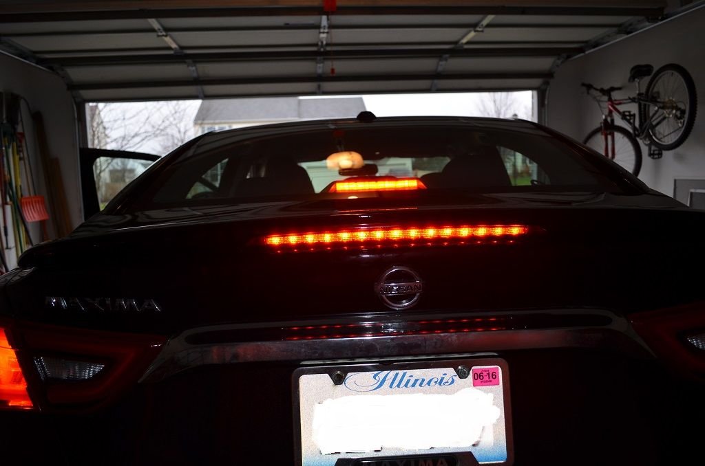

Look sweet on that tail. Are you going to cancel the interior brake light?

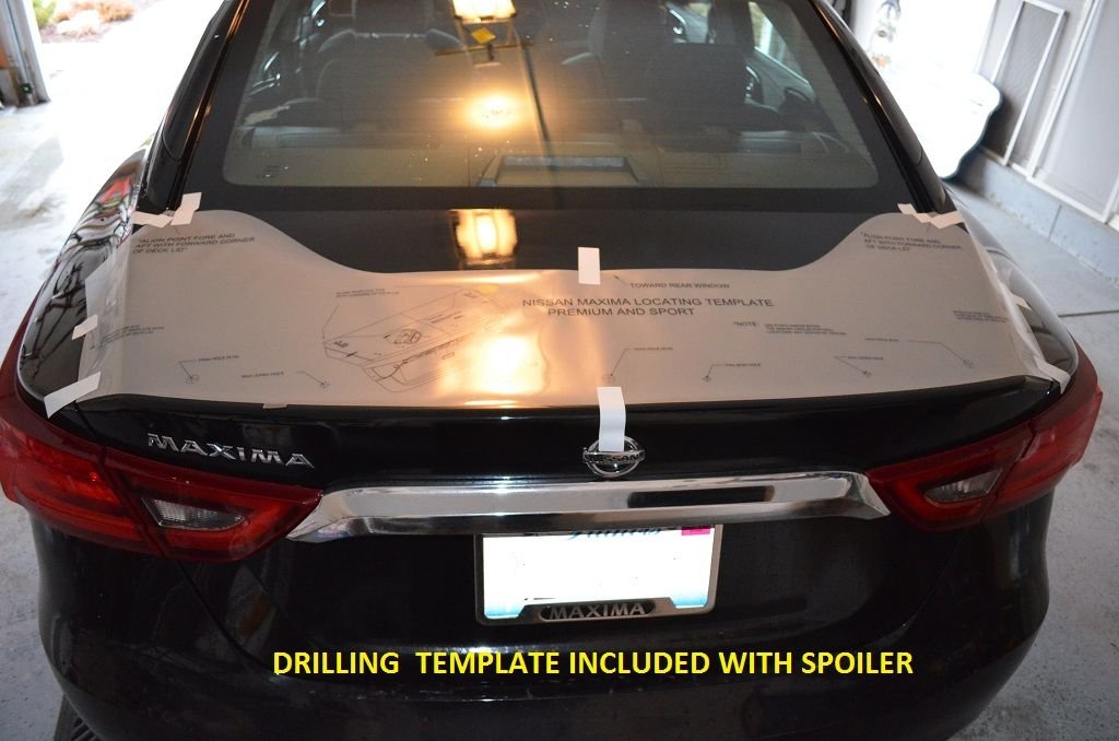

Looks good! What did you have trouble with? Did you have an actual factory spoiler? From Nissan direct it comes with the template you need. Simply line it up, tape it on, drill the holes, paint with a little rust inhibitor, and it snaps in. The wiring is already there, which otherwise would have been the most challenging part. It helps to have an extra hand to line it up and get the adhesive on evenly in one shot. It took me longer to go out and get the right drill bit size. I didn't swap out the torsion bars, you need a Nissan tech tool to do that. I did our 16 platinum and 16 SL. Took 30 mins tops each.

Like somebody else said, the factory spoiler is a piece of cake with the provided trunk template. Using a hole punch and new drill bits, the process couldn't have been any easier. The only hiccup was the metal burs to remove mostly on the inside part of the freshly drilled holes.
