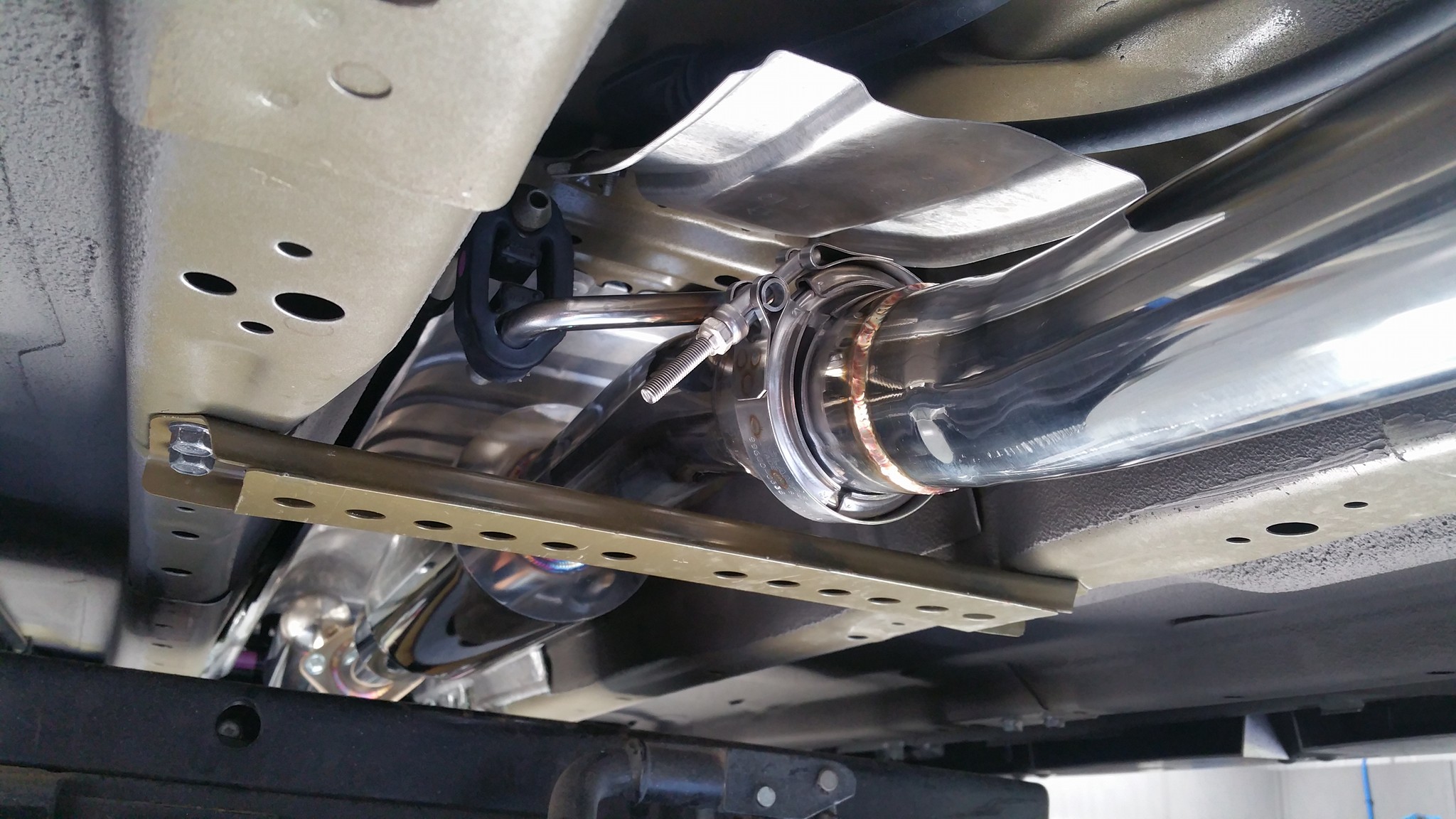

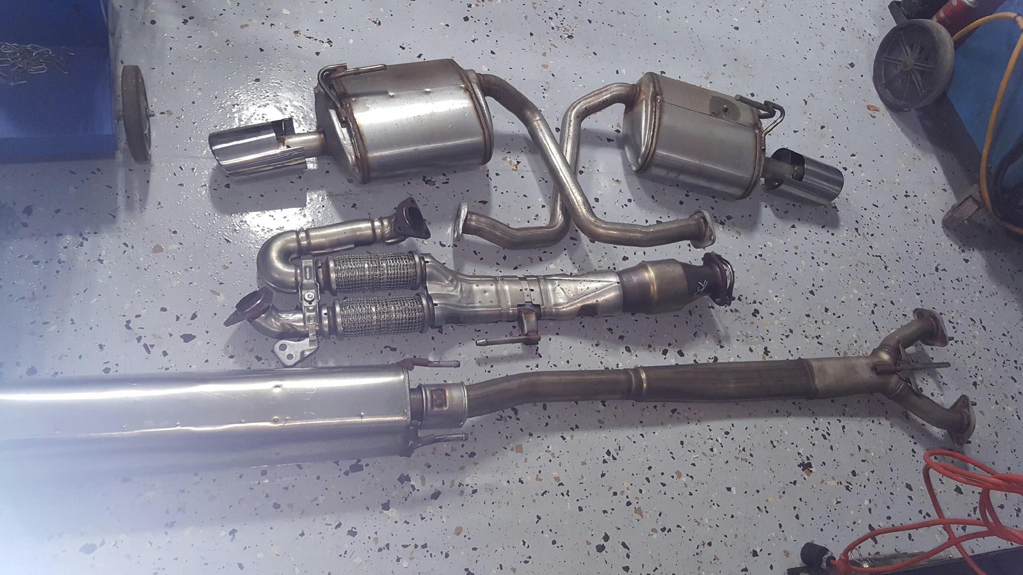

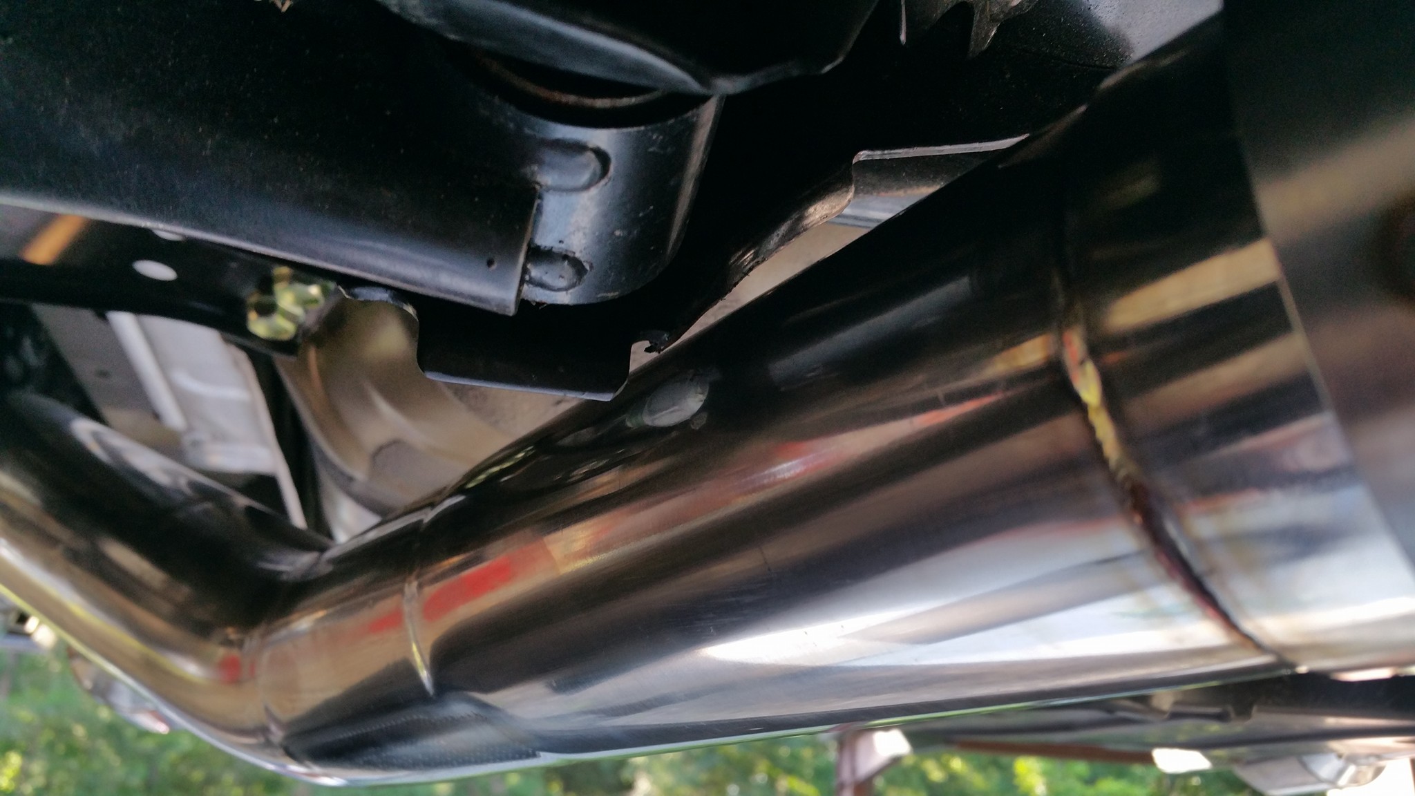

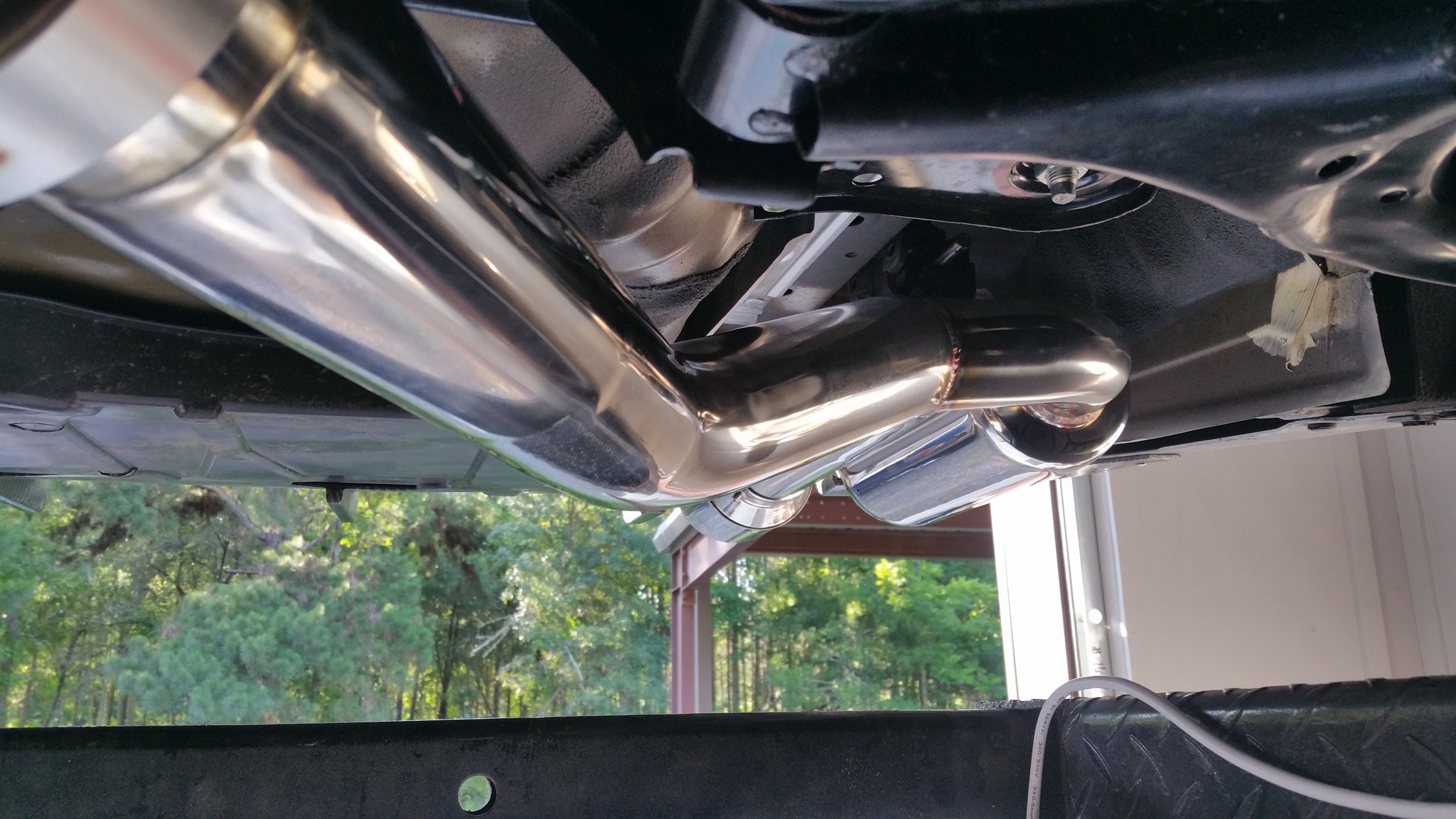

Okkkkkkkay....Tony Motordyne exhaust installed. Thanks to Kyle Hitchcock and Walter Aguilar for their support on this. This was tooled for the 7GEN, but fits the 8GEN with just a few very easy twist mentioned below.
First I suck at writes-ups most every time! And in all reality sound clips will do this NO justice, and you cannot make a determination by a recorded sound clip in my opinion anyway!
Second the install is a breeze even though this was designed for the 7th gen...I see no reason why Tony would have to re-tool this for 8th gen all. You will see in one picture where I have a circle to where you have to trim off that piece or you can actually take a hammer and just beat it back a little bit so it clears the exhaust.
The other thing you have to do is drop down the mounting plate that the mufflers mount to, and just use two bolts to mount up the mufflers instead of the 4 that come stock. It holds them in place just fine. That was near impossible to get a final picture of because of the tightness of that area. And in one picture you will see the gasket you need to buy for the art y-pipe to mount up. I have a picture of the stock gasket laying over the top of the art y-pipe gasket. They do not match up.
Basically anyone that cannot clearly see these two small things should not be installing exhaust LOL
So in conclusion, break out your credit card and call Tony Motordyne and get this exhaust ordered TODAY. Everyday you wait, is another day you will not be enjoying this car to its fullest! This by far is the most awesome sounding full exhaust I have ever had on a car! And by far the best quality I've ever seen in an exhaust! Not to mention their customer service when taking your order is over-the-top! They are truly excited about what they are selling!

Circled area is where you need to trim for this to clear. Takes less than a minute if that.

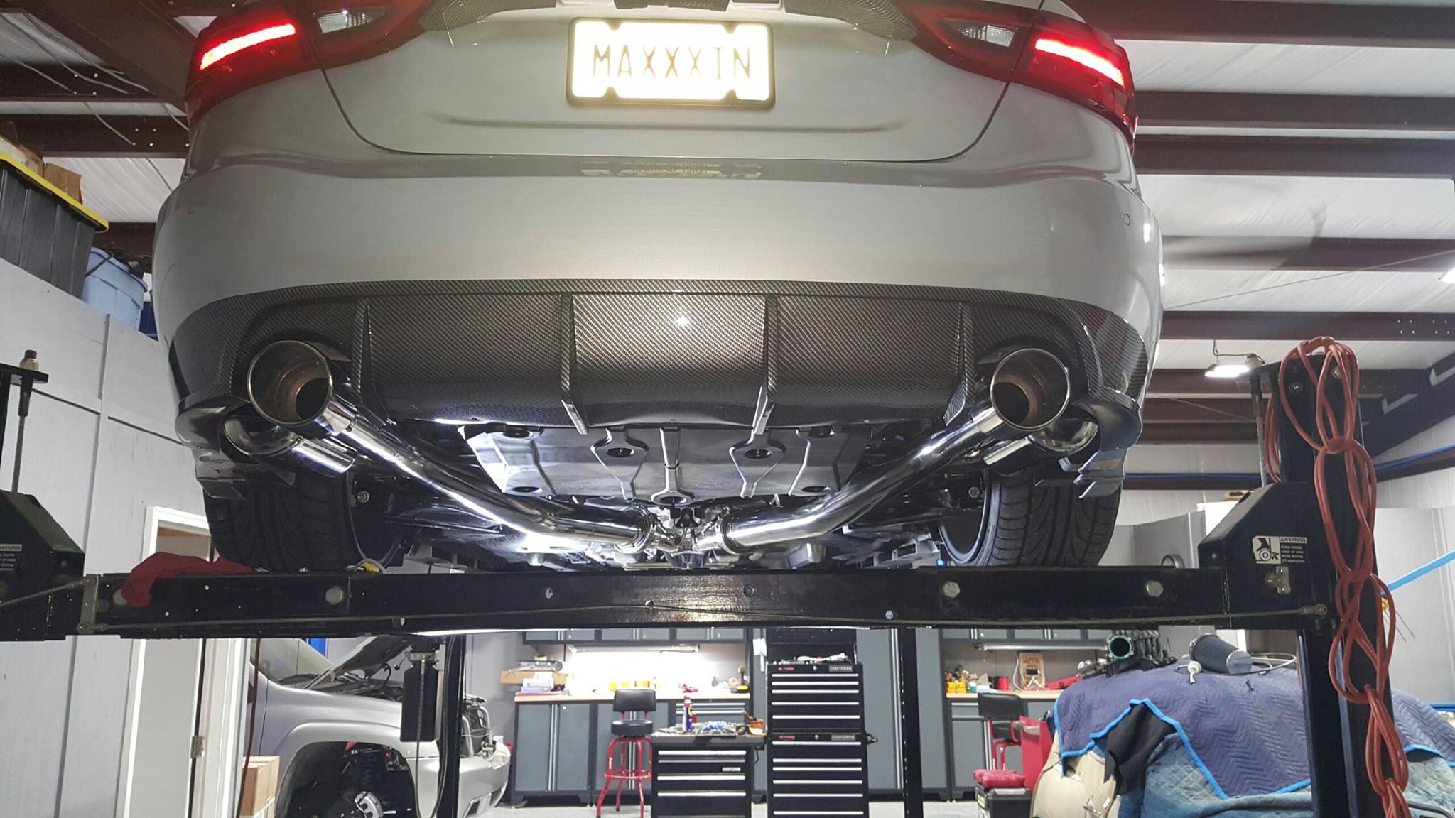

I just have a question, where did you get the lip kit from? Just liked it in the pic #9.

thats the stillen lip - https://www.stillen.com/stillen-2016...r-kb12841.html

Where did you get the diffuser and front splitter? It looks like its carbon fiber wrapped. Looks nice and I'm planning to do the same set up as yours. already bought the motordyne exhaust + ypipe and stillen CAI.

good time to buy a stillen splitter/diffuser. buy a diffuser get 50% of the splitter until 2/16

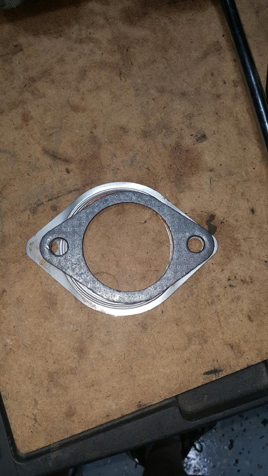

How was your exhaust install? Where did you get the gasket needed from the pictures above? Looking to get same setup for intake and exhaust.

i havent had it installed yet. Still waiting for it to be delivered. The gasket i would still have to look up for it as well but i would have it installed from a reputable shop so maybe they would have it or would give me advise on where i could get the gasket from.

What type of modifications did you have to make to the gaskets? I got a quote of 200 to have it installed, but I think a buddy and I can do it. Do you have any pics of the muffler thing you were describing, not sure I understood that part. Thanks.

The holes on the gasket motordyne provided me did not align to the holes for the bolts in the exhaust. either you make the hole bigger so it properly aligns to the holes or use the old gasket if yours is the same. if you are installing the y pipe make sure you use the old gasket from the old y pipe. One thing as well is the rubber hanger at the muffler area you would have to take off and put on the new muffler before installing it again. you might get an issue on putting it back on with all 4 screws but as the original post said you can use 2 screws instead of 4 as long as you make sure that it is tight. also on the right muffler area you would need to trim I think a part of the frame since it is sticking to the exhaust pipe. you would see it but I guess you can do some adjustment and try to make a gap. I still have not trimmed mines but I did some research and would try different solutions just so I wouldn't mess with the frame itself. ill take picture of it on Tuesday.
my next project is wrapping the stillen diffuser and splitter in carbon fiber then wrapping the roof gloss black and having my windows tinted and installing a roof spoiler.
