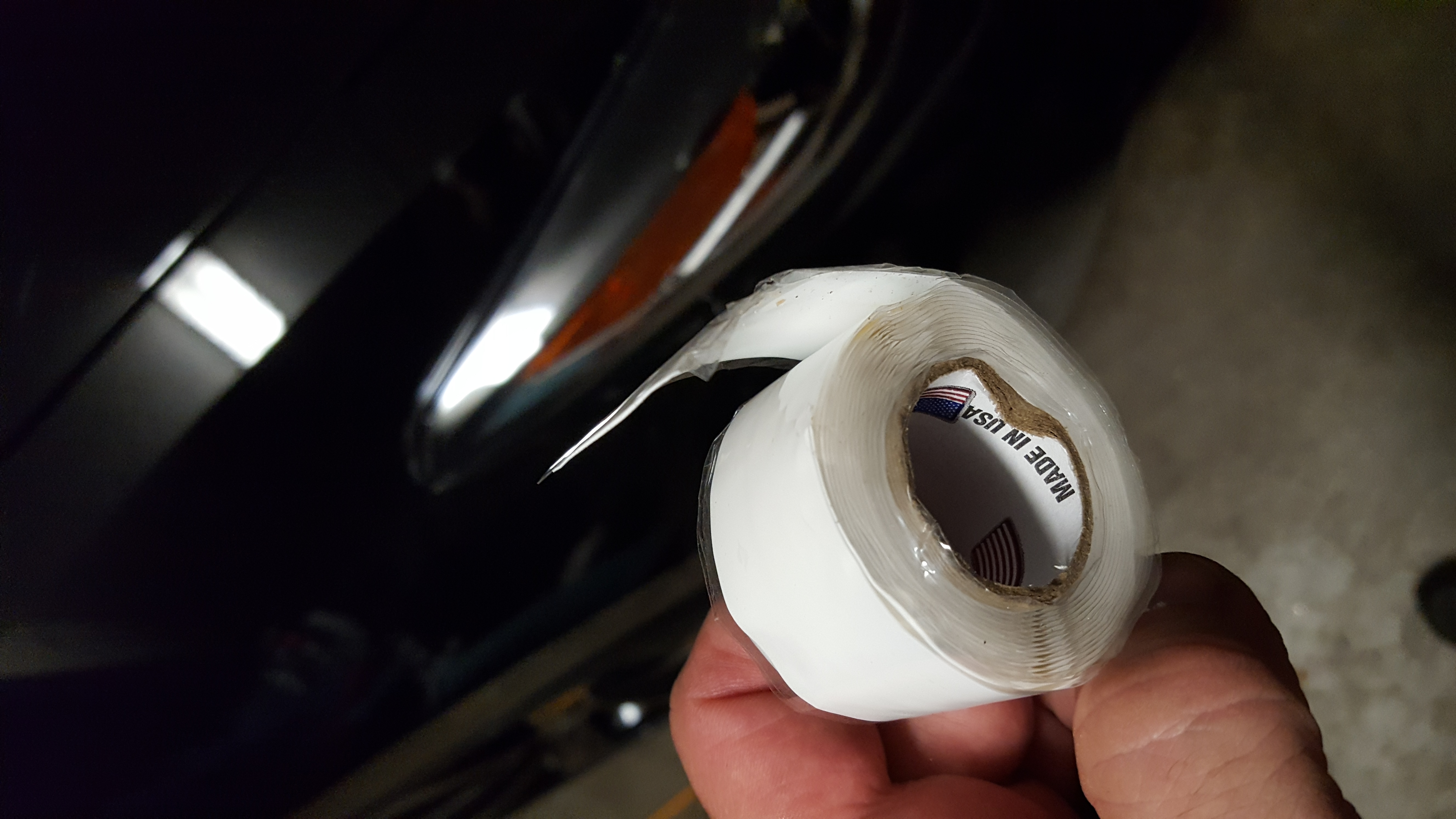

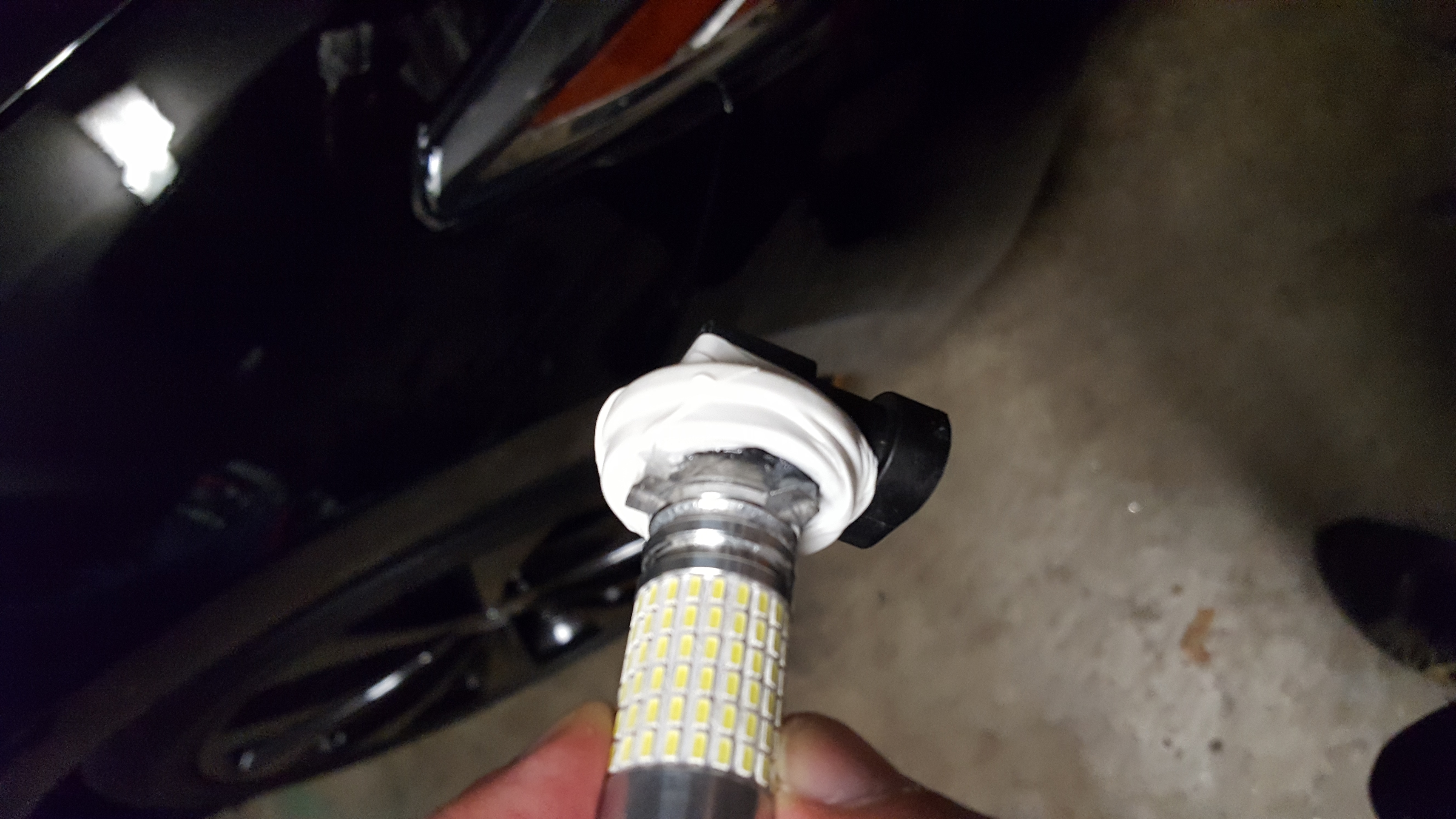

New 2107 SR Owner, of course I wanted to fix the fog lights to match. I have read all the threads and have experienced the Condensation issue. Here are My thoughts and what I have done which seemed to have resolved, *FOR ME*.
Live in the Southeast, Extremely humid.
Installed New JDM fog lights, next day, condensation, only on Driver side. Took Em out, Blow Dried, Compressed air, left open over night. Swapped the JDM Gaskets to Factory. Next day or 2, condensation.
So it seems obvious to me that this is a seal issue. But from what I have read it is only on the Driver Side, but does also happen with stock bulbs that have never touched on the passenger side.
Here is what I think, on the passenger side you need to unplug the bulbs to remove. You cannot even move the outside Bulb without unplugging it first, almost acting like a lock, this is not the case on the Driver side.
So it may be possible some come out of the factory a tad loose, or wiggle lose, on the driver side causing the condensation issue. Of course when we swap out the bulbs, the aftermarker housings may not be a tight fit.
Anyway, I Used some self-adhesive Silicon tape and beefed up the gasket a little on the Driver side Fog Lights, they now fit snug, with a good seal. Of course, Blow Dried, Compressed Air and aired out over night.
I am on a little over a week with no signs of moisture, either side.

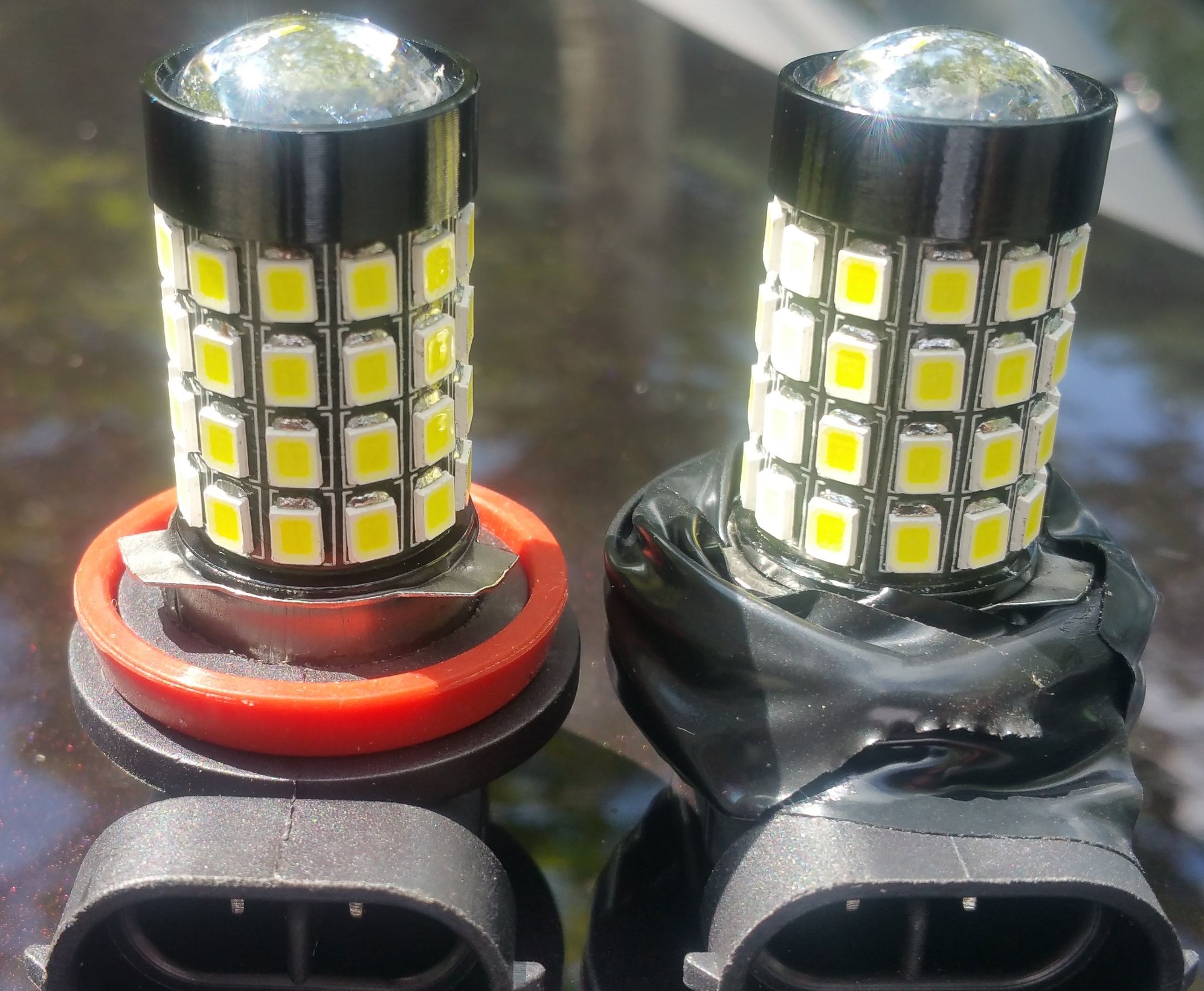

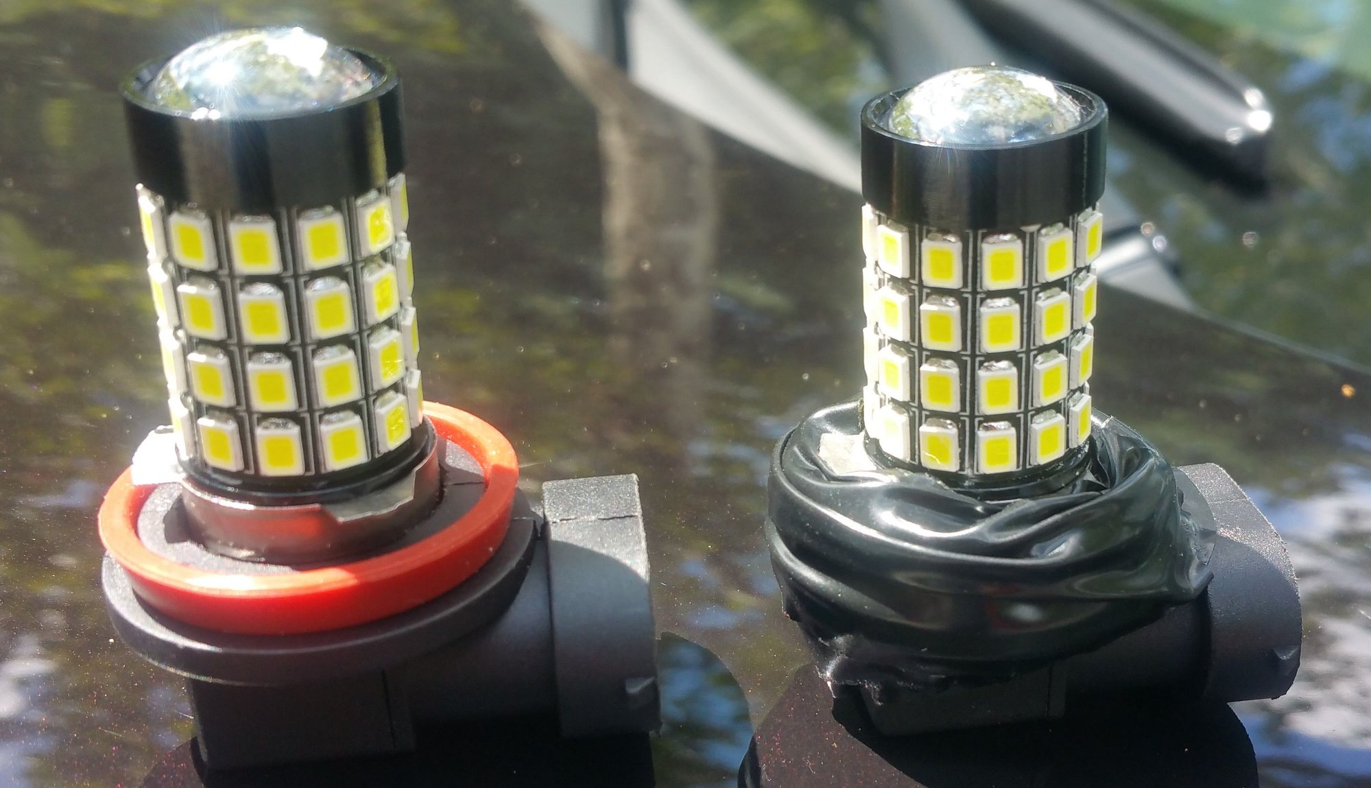

I followed your advice. I added some extra wrap to my fogs. Hoping I have the same outcome as you did with your car. We are expecting rain this Friday. If it doesnt come, I need to go to the car wash anyway. Hopefully, I'll know if I am in the clear by the end of this weekend.
SIDE BY SIDE BEFORE AND AFTER WRAP

There was some slight condensation. Not as much as before... but I was still disappointed.
Thanks for the info and photos. Looking at your tape wrap you might want to wrap the tape so there are no gaps. The way yours is condensation may be a problem still. Hope not. You could take black silicone sealant and patch over some of the "holes" in the wrap.

Thats why!!! ok good point. I was thinking that i just needed to add blockage. I didnt think about a total seal. Thanks Comp! Ill try it.

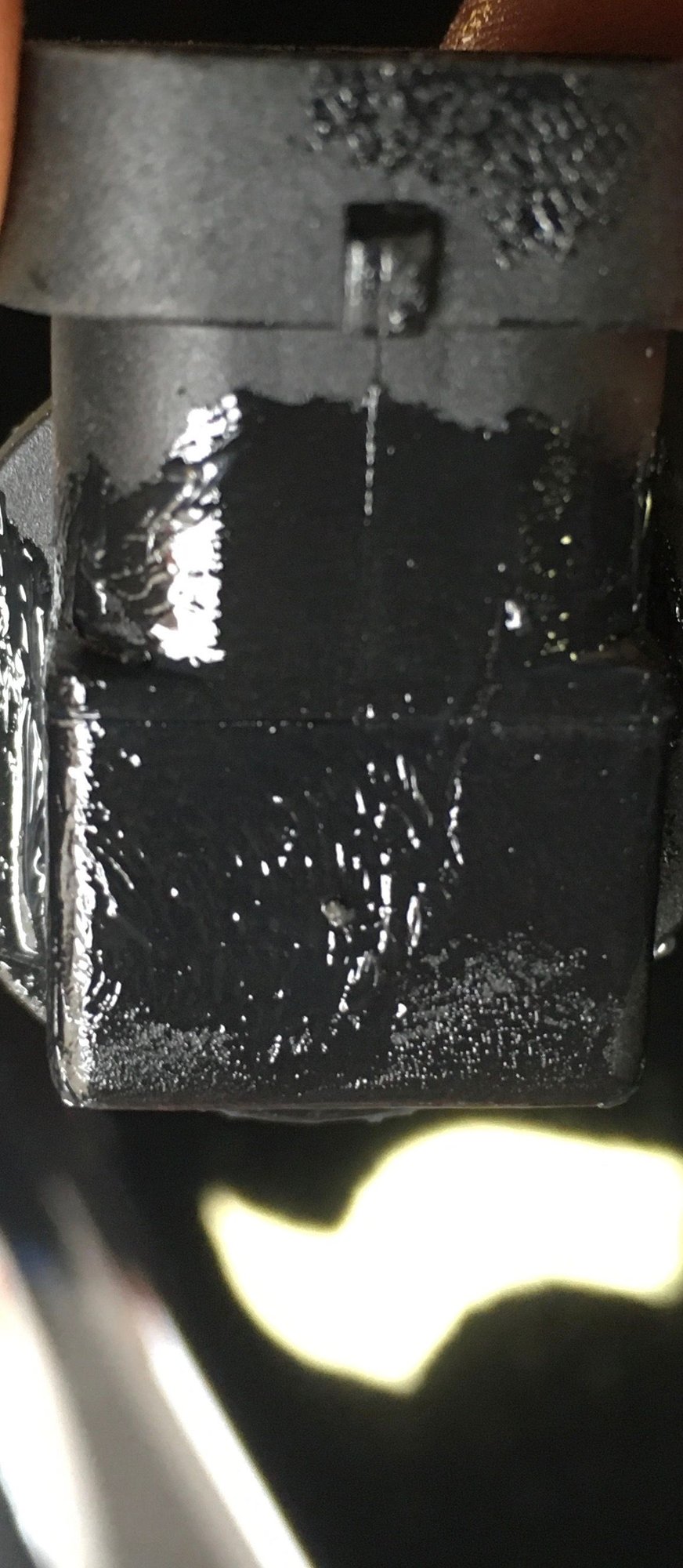

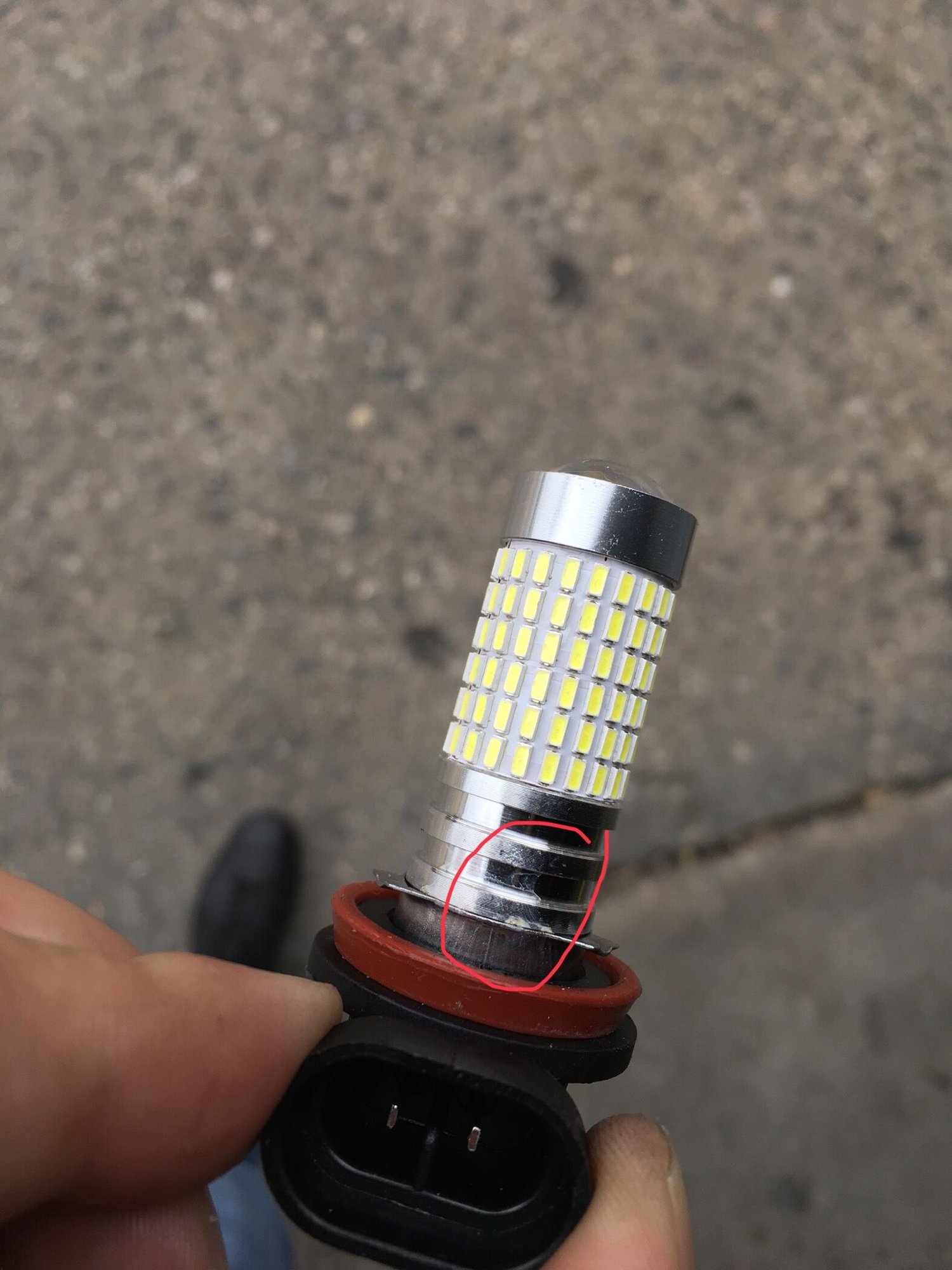

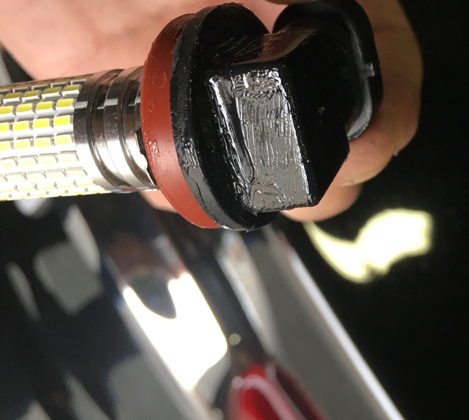

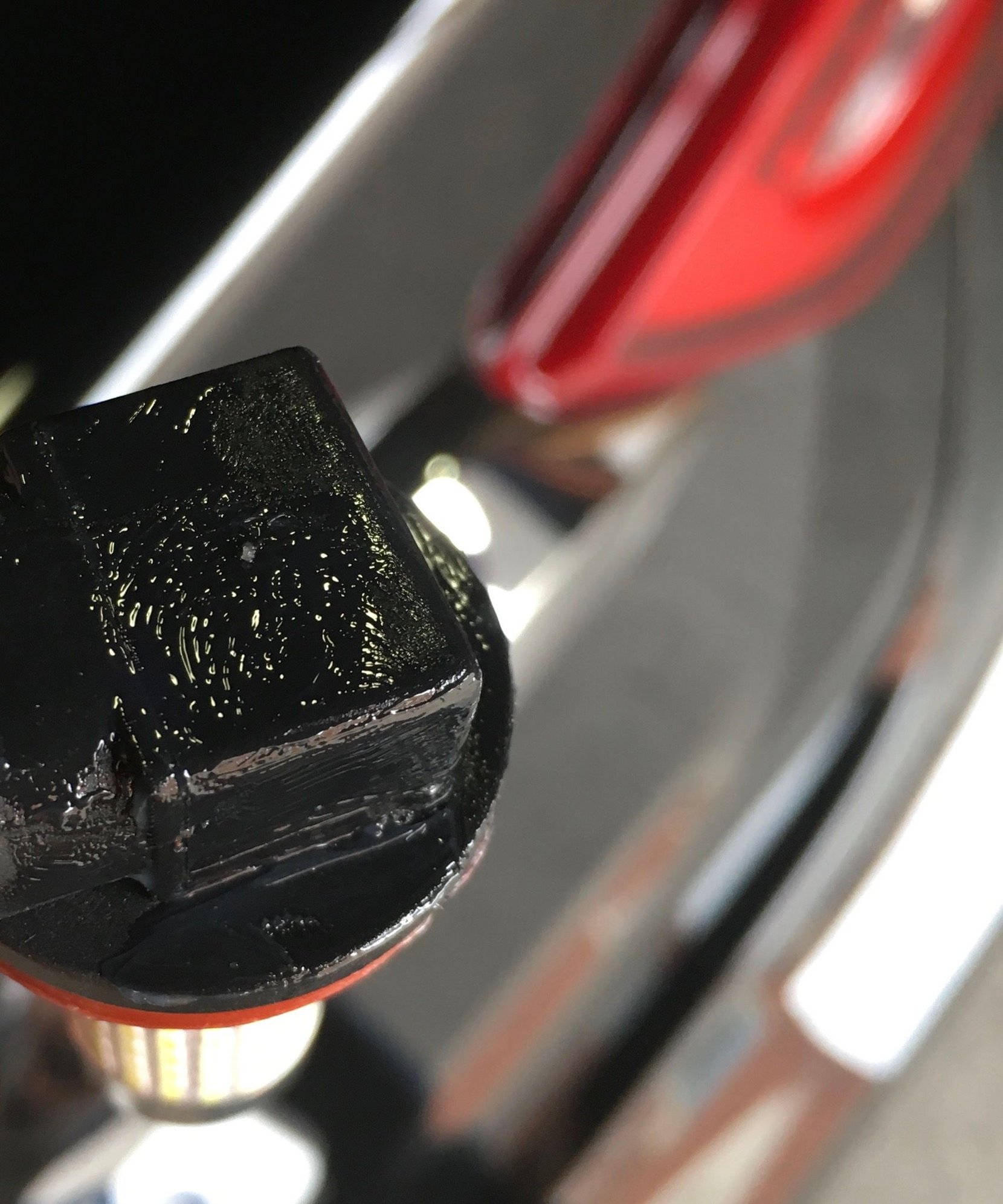

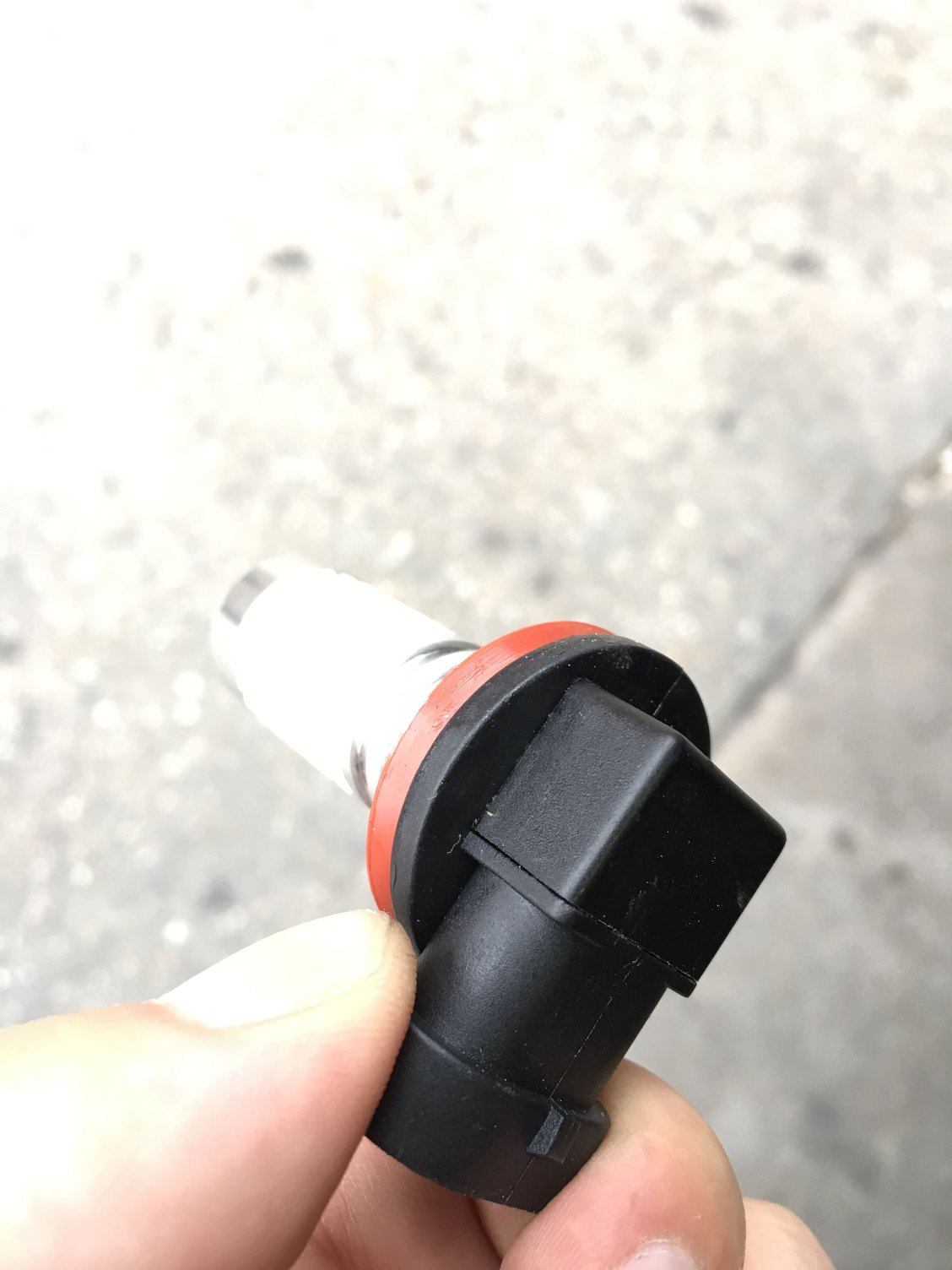

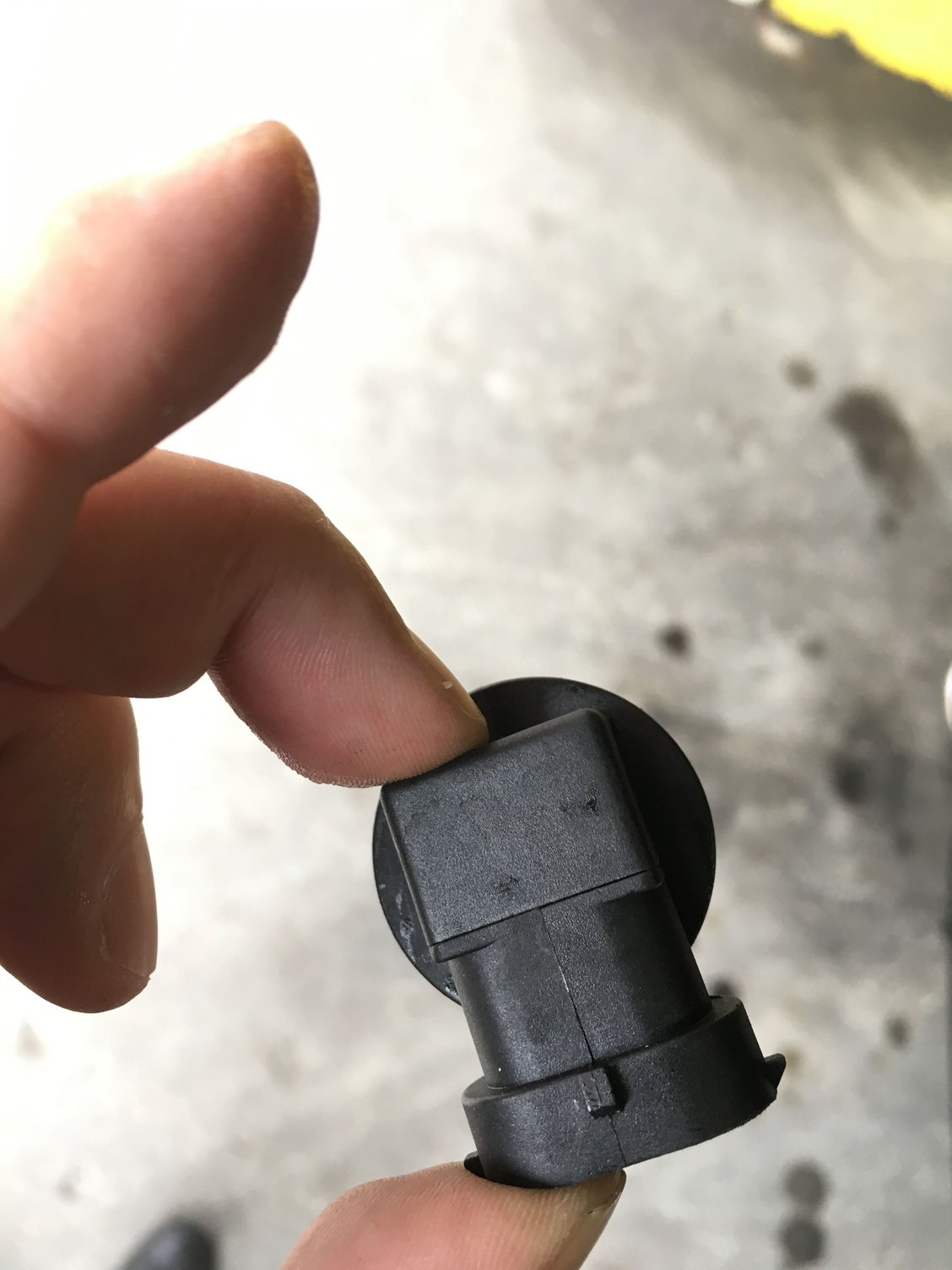

It’s has nothing to do with the seal. It’s the way aftermarket makes those cheap bulbs. The moisture can get through the bulb housing. You need to apply silicone on plastic connector cover. You can see that the gaps. it’s not really sealed constructions. Third pictures shows watermarks and that’s how it’s making it way inside the fog lights housings. BTW those are JDM brand. I believe majority of those aftermarket h16 LEDs made exactly this way.

Awesome input. According to those pictures, I can see how the water would get in that way as well. A silicone treatment sees like a great idea as well. Thanks!
