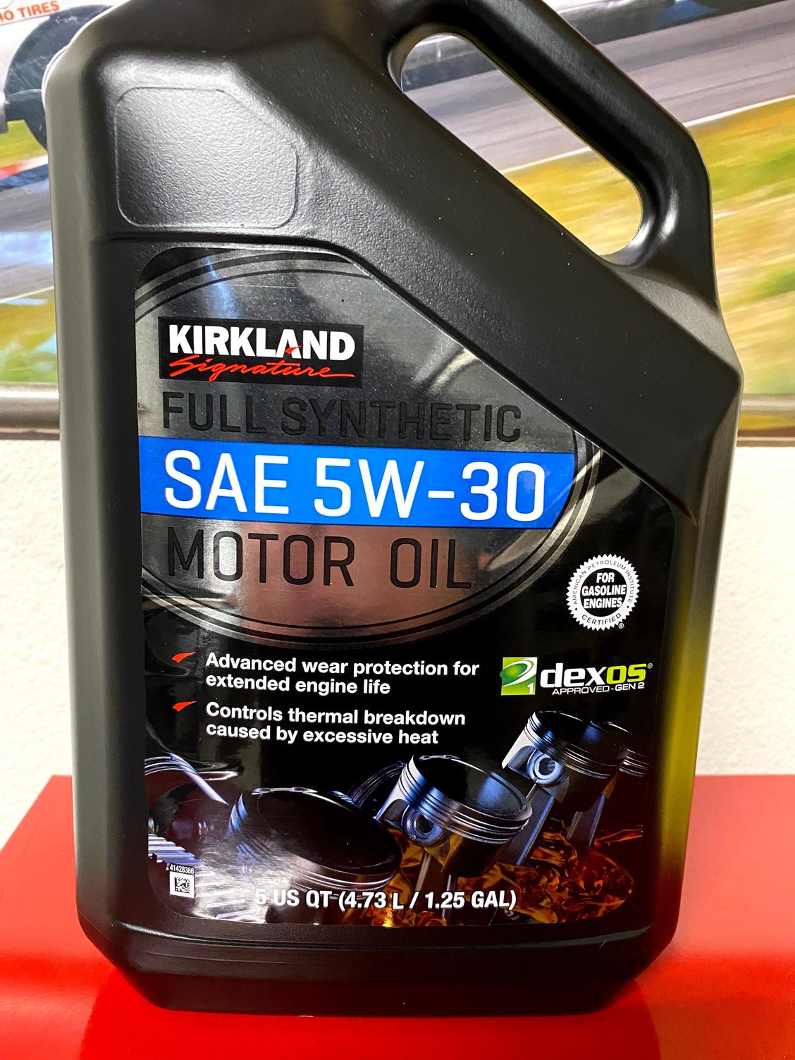

I'd have no problem running Kirkland 5-30 at $2.49/qt all year.
