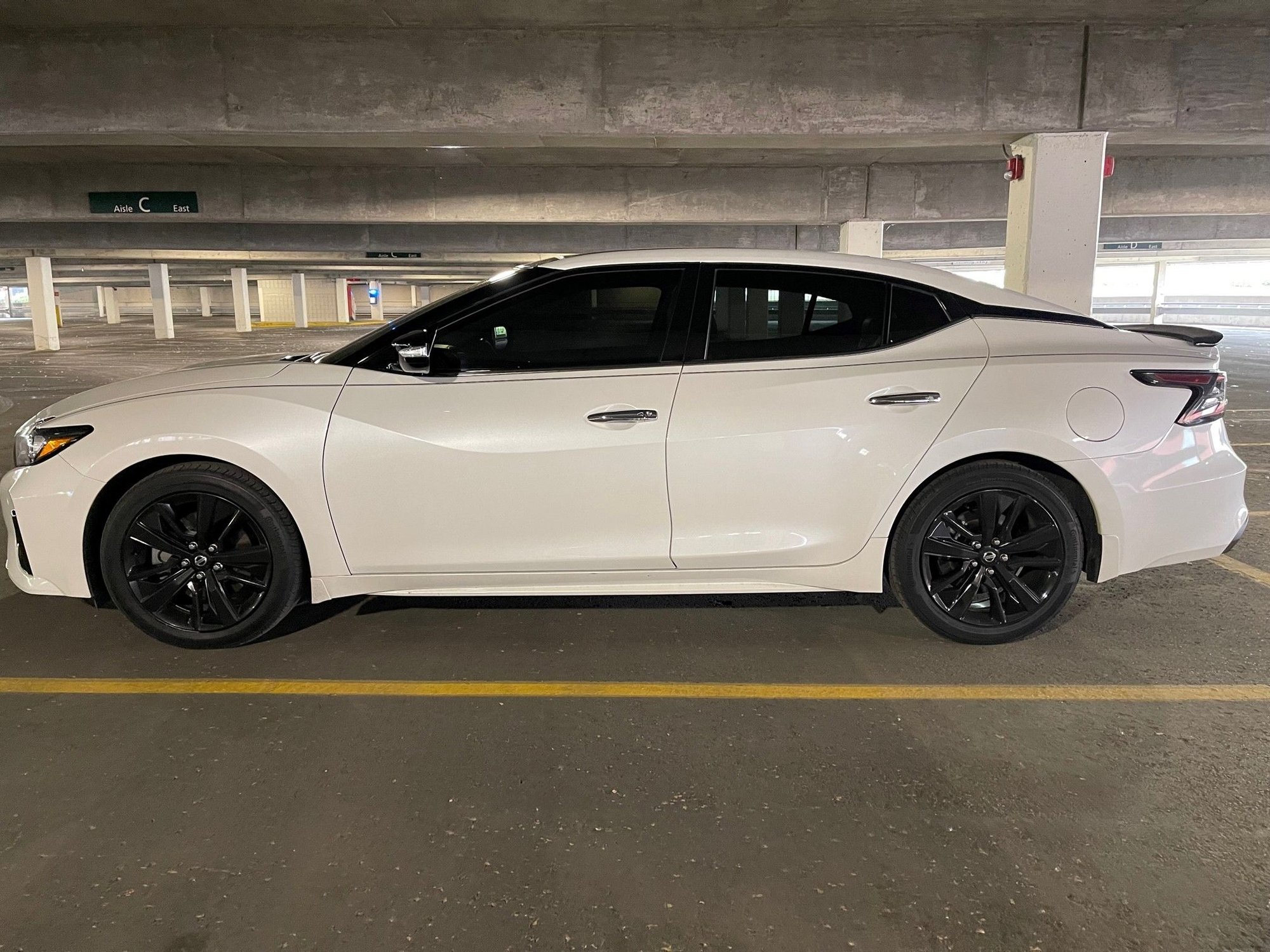

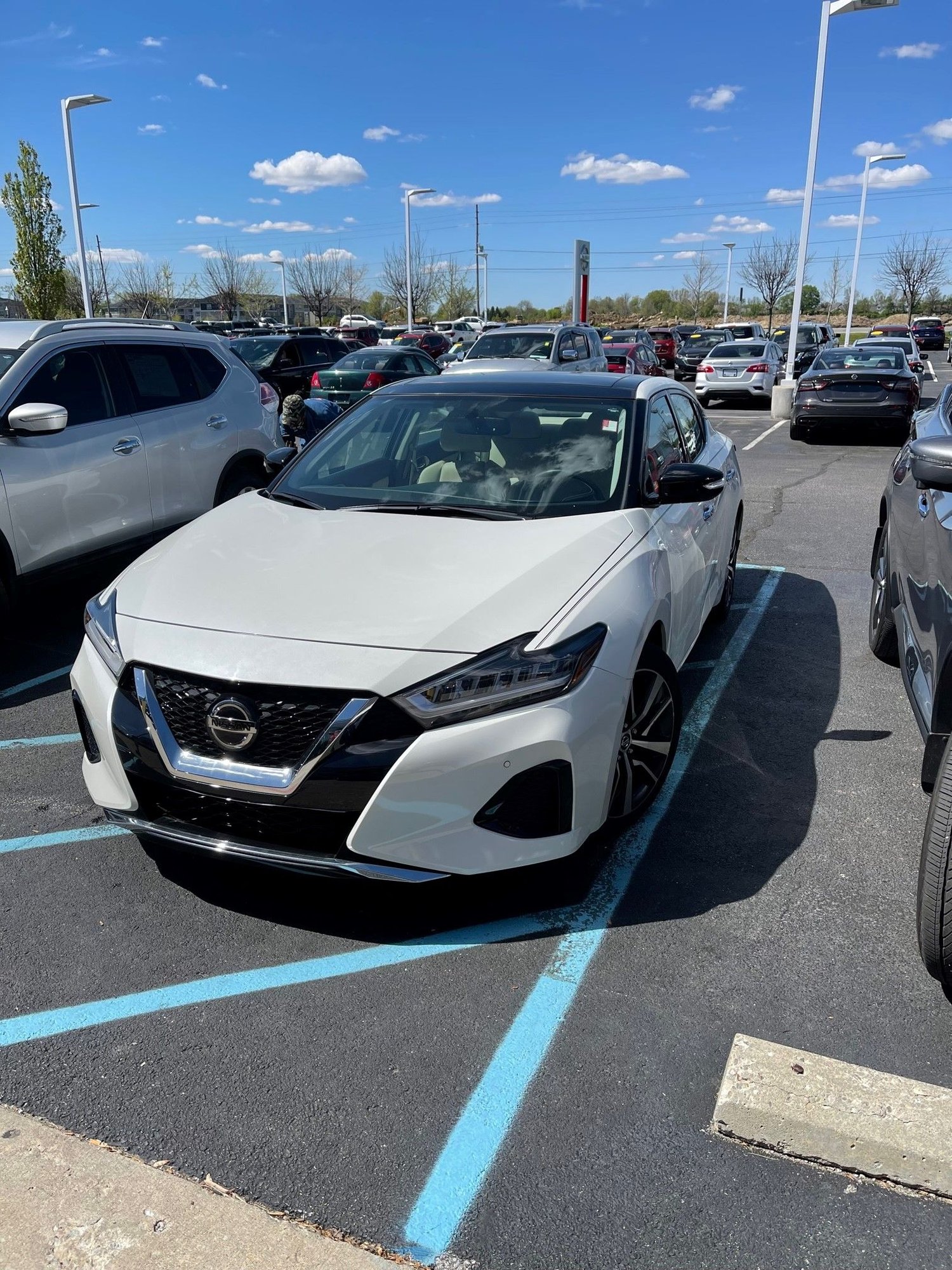

This is my second Maxima, my Coulis Red 2017 SL was totaled 22 months ago. I've included a couple photos' because it's a gorgeous car! lol.
