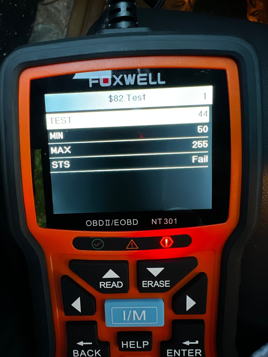

Almost 500 miles later and see Bank 1 readings: scroll up and see P0420 w readings on a fail.. lots of take aways
