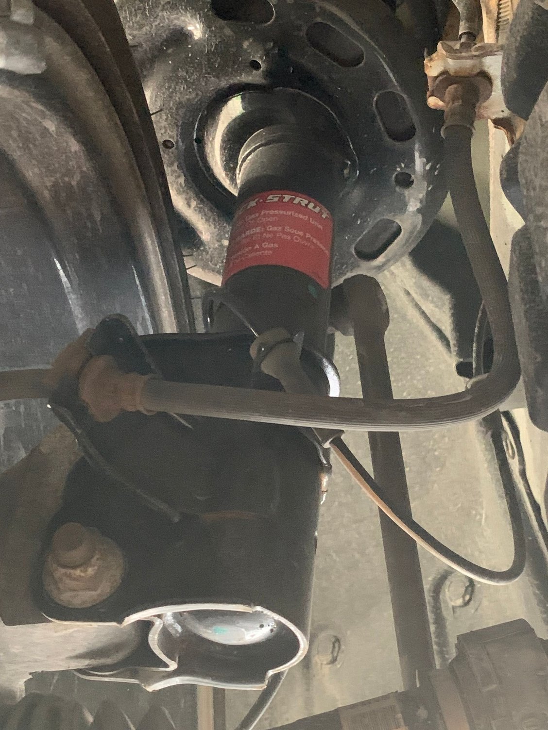

I had my front suspension replaced and had all sort of poor quality issues after that. I was able to take a look under the car today and noticed the struts label said Quick Struts, picture below.
on the invoice it says this.
im wondering, shouldn’t the dealership install oem parts only? Unless this is a OEM part and just doesn’t have any Nissan label/part number on it. Any help would be nice to understand if dealership is ripping me off here.
thanks in advance

Those part numbers are Monroe and can be had for as little as $100-$125 each through online retailers. Lots of people complain about aftermarket quick struts.
Did they not explain the situation and give you options? You needed springs. Were the struts and mounts junk too?

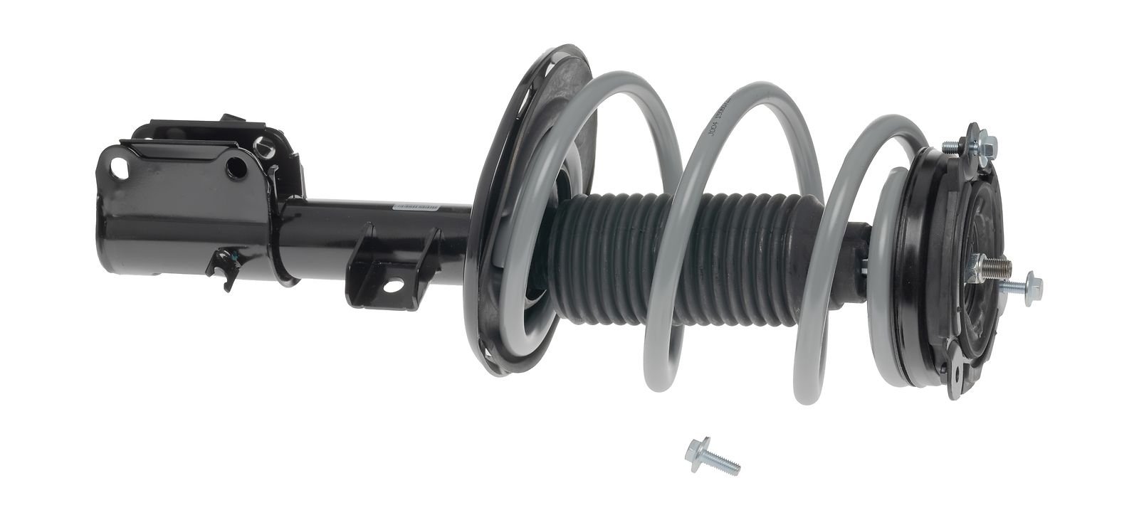

I would think they would install NIssan's Value Advantage strut kit. They have grey springs.
Part numbers are E4C02-4RC2PNW and E4C03-4RC2PNW. The thing is, they may not be any better than the Monroe. It's cheap aftermarket, not anywhere near original quality. The original suspension is tuned specifically, aftermarket is one size fits all.
