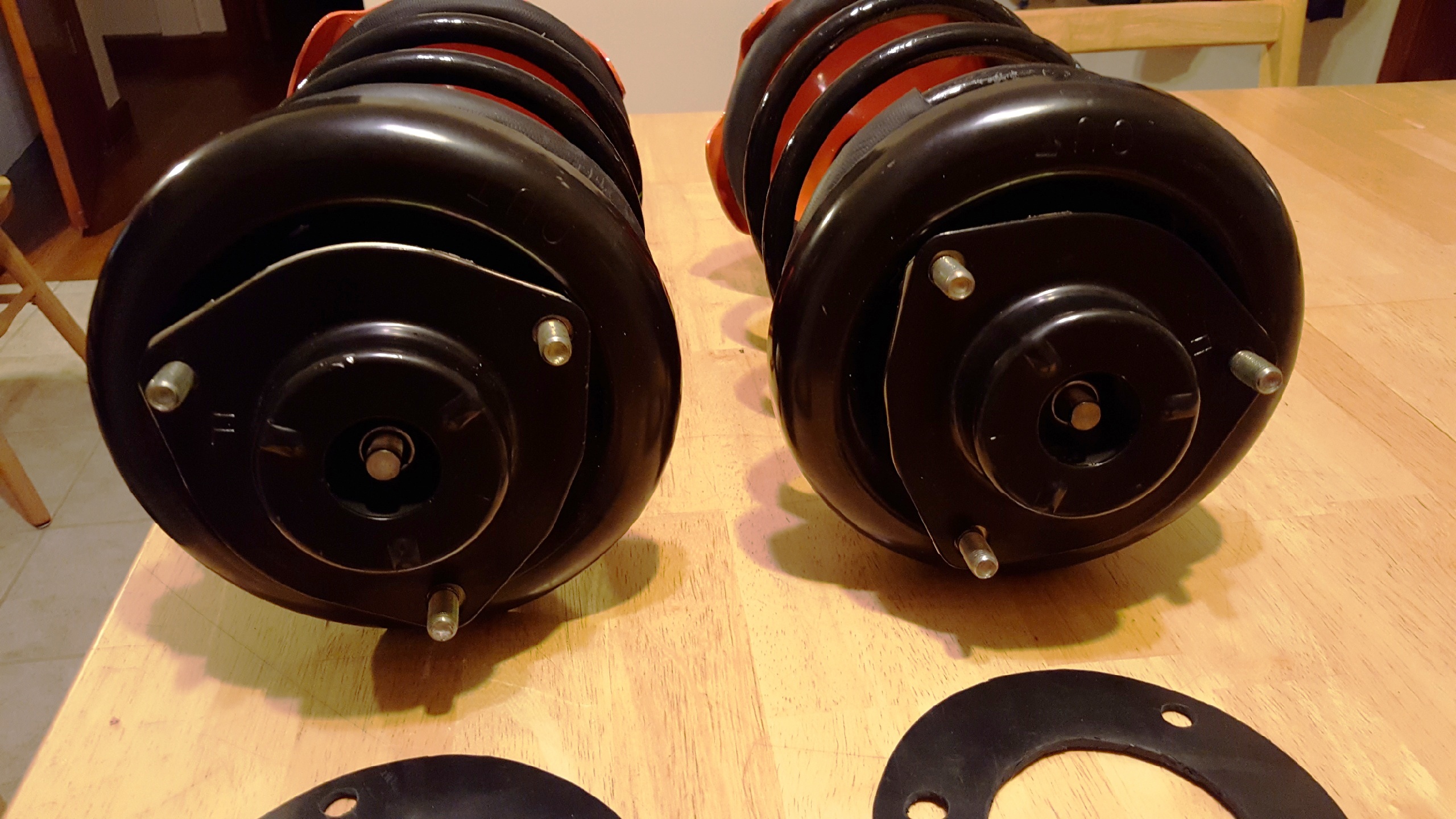

Here you go with those thick OEM SE "Top Hats" .

Twin strut assemblies form different...... Mothers? LOL
