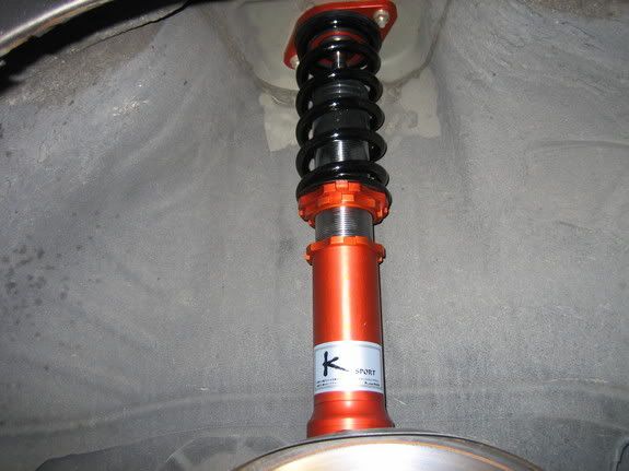

okay i went to do my usual inspection under the car and noticed a very wet rear passenger strut. does this look like its leaking/blown? the brakeline even had fluid on it. the other one was completely dry.
heres the driver side one.
im a little disappointed if its blown. i dont want the other ones to start going too...does anyone know if the replacements are a little different to prevent this from happening?

wow that sux, it does look blown to me...i dunno where else that grease could have came form?
lift up the dust cover on the ksport, and run your finger along the shock body...see if the fluid is coming from there?

Yeah I saw some oily stuff, so its gotta be that....damn. I thought it wouldn't happen to me.

One blown damper doesn't mean you'll have more. You should replace it ASAP though. Are you still under warranty?

thats blown. if you send the whole unit it all they will do is just replace the damper and send it back.

From: houston tx
okay i think i've got a problem.
the rear damper i recieved does not look like my old one, it looks like a front one, the tips are different and theres a slight difference on the top seal. I dont know if they changed the rear dampers and i got a new version or something but it seemed different.
also as far as tightening the nut, the piston would start turning...there was nothing i could do, i just didnt tighten it down too much to where it would spin...i hope thats 45 pounds i knew a torque wrench would turn it for sure though so i didnt even bother.

From: houston tx
They do seem to have made slight changes to the design. I saw the same thing with mine. Don't worry about it.
About the torque spec, don't sweat that either. It really only matters that much for a front coilover because of the camber plate. For a rear coilover, the only thing that changes is the preload on the bushing, and that is highly unlikely to make a difference.
ok whew, what a relief. hopefully this one lasts longer. and hopefully if the other one is gonna die it dies before my warranty runs out in december.
gotta send the old damper back but a thumbs up from me to ksport for the customer support.
