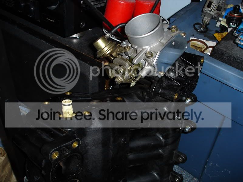

Here is one of StephenMax's images..
See the A32 IACV on teh right?(Ignore the TB Adapter you dont need that if you're using a A33 TB.)
