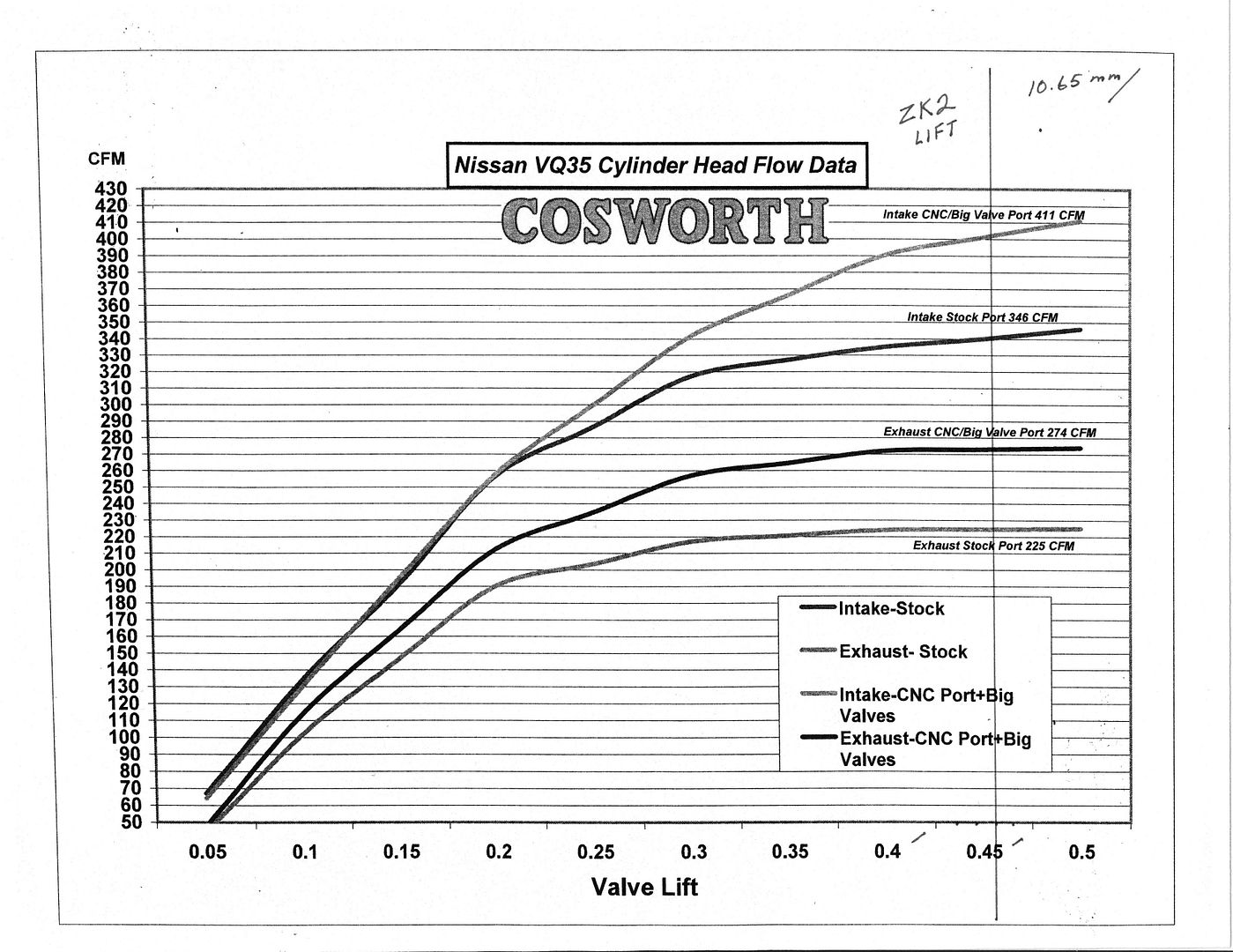

Cosworth CNC heads flowbench graph.
I found the Cosworth chart for the CNC heads. I put a vertical line for the 10.65mm ZK2 cam lift up the graph. That's about .43" lift I believe...

Well knowing not one flow bench is configured the same as another, the % of increase from my heads with the port work and stock valves is around 13-14% increase in flow. Just calculating the CFM percentage of increase. Looks like Cosworth is claiming around a 17-18% increase in flow based on the CFM numbers.
Yeah, flow benches are like dynos - each one is unique. The important thing is how much more flow you get before and after porting. Your porting job sounds like it has good numbers - and that's with stock valves. The Cosworth numbers claim 21.8% increase on exhaust and 18.8% increase on intake CFMs.
The Cosworth heads have +2mm larger intake ports but the exhaust ports are OEM size. I guess that's good, so I don't have to re-work the header ports - and the primary tubes are 1 5/8" already. I've already ported another LIM to match the heads.

Another thing was my CFM numbers I posted were from the heads before getting the M2 serdi valve job, so combining that with the port work I'd say we're going to be in around the same ball park in terms of % of increase in headflow. I got a 3angle cut on the intake and exhaust side. I'd love to flow the heads again with the valve job completed but don't have time, my cars getting resassembled soon.
Yah, that sounds good. Betcha they work well. Do you have a spec for combustion chamber volume? See below.
Cosworth has a page for their head specs here:
http://www.cosworthusa.com/store/pc/...7&idproduct=68
Some details:
# CNC Ported/Machine finished port
# Intake 19% (max) increased flow
# Exhaust 22% (max) increased flow
# 4-angle Inlet Valve job
# 3-angle & radius Exhaust Valve job
# Back-Cut Inlet Valves
# Heads are Ultra Sonic cleaned prior to assembly
# Heads are Serialized and sport a machined Cosworth logo
# +1mm Stainless Steel Intake Valves (1800 degrees max.)
# +1mm Inconel Exhaust Valves (2400 degrees max.)
# Performance Valve Springs
# Titanium Retainers
# Hardened Steel Spring Platforms
# Knife edged port divider
# Combustion chamber volume 58.5cc (OE approx 56 cc)

He set the combustion chamber volume for stock which is what cosworth should have used as well.
That's why I installed 11:1 CP pistons to use with nitrous - the effective CR drops a bit with the larger volume.

The trouble with using the '99 ECU ignition timing is that it can change - I've logged it with an Australian OBDII program, from BlaTz or something like that. Don't know why, but it happens. Of course it almost always goes retarded a few degrees, so it wouldn't be fatal, but....... Yeah, if the ECU would always use the 4th gen WOT ignition curve, then no problem.
So you think that I can make whatever connections that are needed for basic operations and just run the injectors through the EU to control them? If possible, that would be where I start.

Took the time to catch up Harold, this thing is going to be impressive. You prolly said it and I missed it... youre running 11.0 CR pistons, and stock timing correct?
Also, Just throwing this out there... I know there are some disadvantages to it, but if you want to pioneer (I may follow your footsteps ), the megasquirt is independent of the ECU when it comes to timing, etc. One of the reasons I am considering it... you want 19* of timing, you type in 19*. No +/- crap.
By the way, you wouldnt happen to be running the laptop voltage increaser with the plugs would you? I still plan on running one when I get my engine done!

Hi .... yup, 11.0 CP pistons - although the Cosworth heads have a couple of extra ccs in the chamber, so actual CR will be about 10.6:1. Yes, stock ECU and timing.... "megasquirt" , eh? I'll look into this. Stupid timing moves around too much for my tastes. The 'squirt connects to the 3.0 sensors, right?
Thing is, the Cosworth heads/cams are rated to 10,500 RPM, so with the heavily-built bottom end, I can def stretch beyond the OEM fuel cut. Question is, how? Greddy EU? Plus, using nitrous, I'm not sure how high is too high for nitrous. Unknown territory for me... I was thinking about a 8K limit, with a third nitrous stage starting around 6K for that extra oomph at the top end.
I created the "voltage boosta" a while back, and I'm still using it - no problems. Still have a .035 gap with a total 175-shot and no misfires - at 15 volts. For $50 or so, you can't go wrong - check w/streetz.. and others use it, too.
I think next week I can get back to the build....
