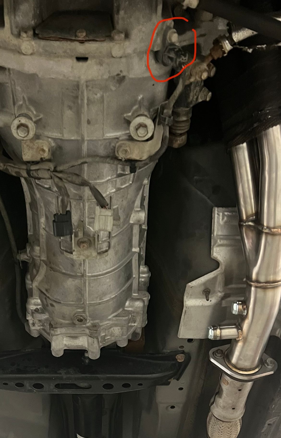

Through some research and looking at my ‘05 G35 I have answered these two questions.
The crank sensor mounts to the upper oil pan structure. This will need to be bolted to the Gen 3 FWD engine so the oil pan will clear the front crossmember properly. Once it is installed the Revup crank sensor could be installed in the correct position.

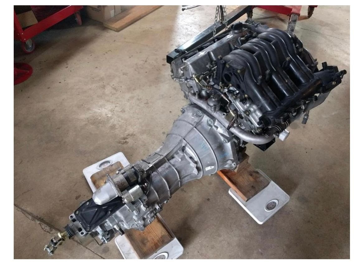

Here is an image of what would need to be done for custom engine mounts to install the Gen 3 FWD block into the front crossmember of the rwd G35 coupe or 350z
Also just for proof another pic of the FWD block mounted to the CD009 transmission from the G/Z

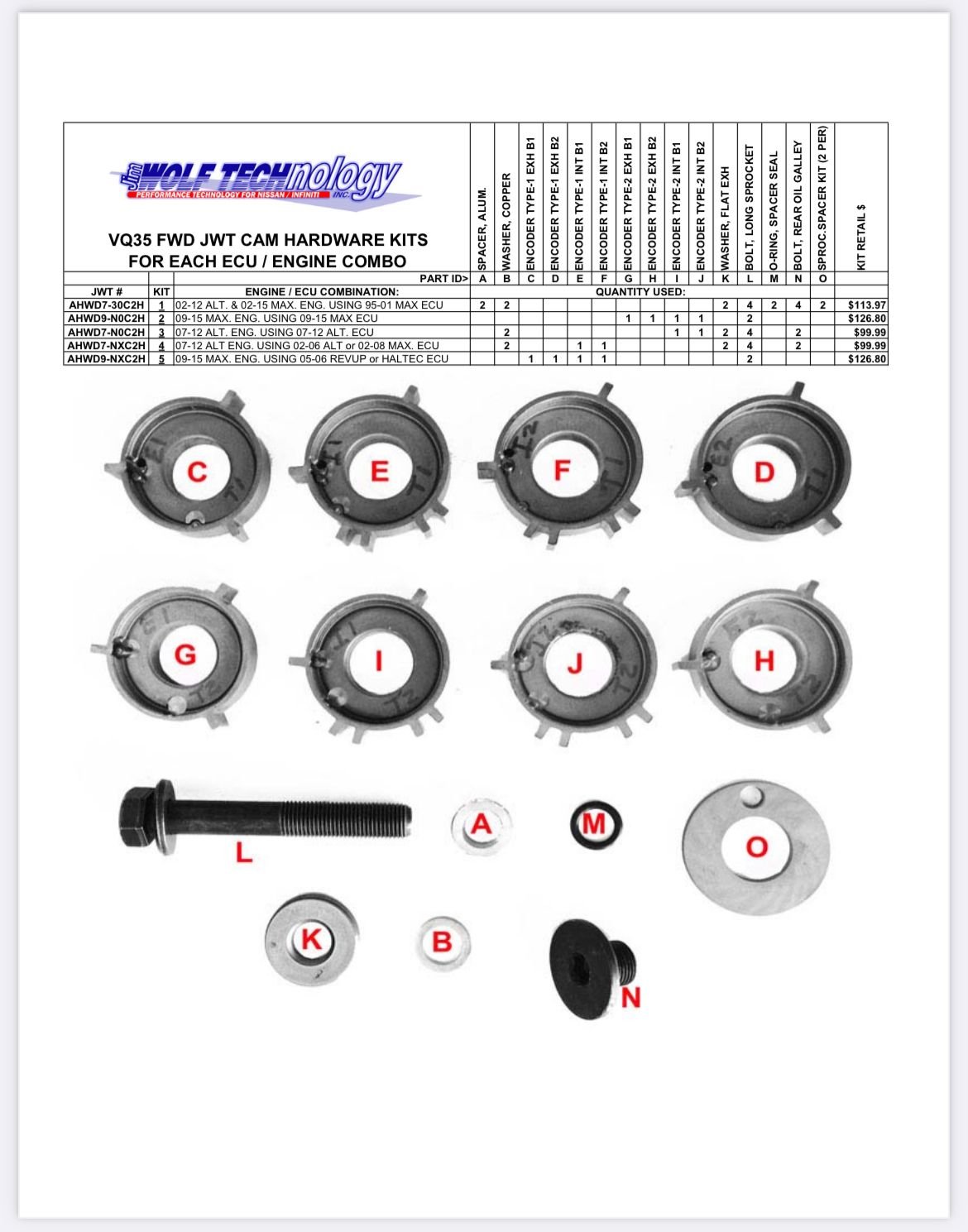

It appears that Jim Wolf has a solution for the camshaft position sensors. They sell modified trigger wheels for the Maxima HR to run off of the Revup ecu.

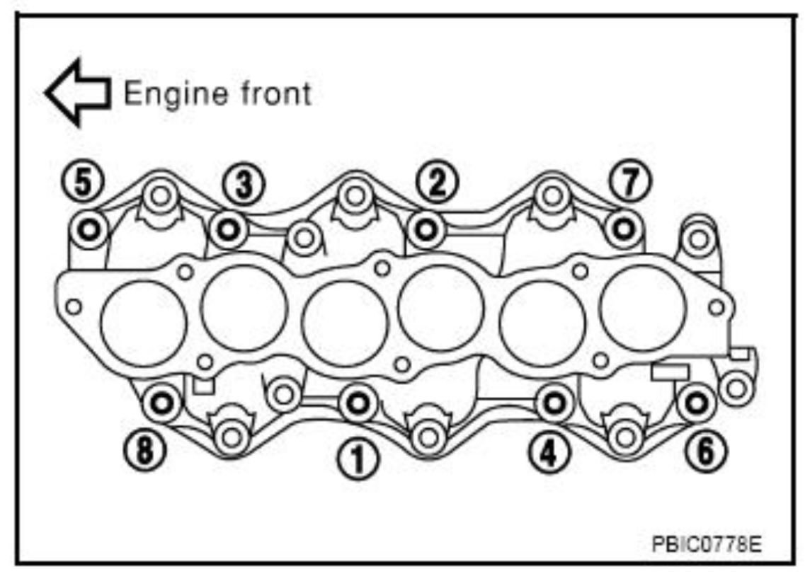

reading this more carefully I realized that the RWD HR lower collected was being used. The RWD HR has a taller deck height block than the FWD HR. This of course changes the distance between the heads. Taking a look at the bolt pattern layouts for the 09+ FWD HR lower intake collector vs. the RWD VQ35DE (350z/G35), the bolt pattern appears to be the same.
If that’s the case, there may be a possibility to bolt the VQ35DE lower collector to the FWD HR heads. This would allow the VQ35DE OEM intake (or aftermarket intakes)to be installed. Should this be true, that would make this swap very feasible. The last challenge would be to confirm the possibility to use the RWD VQ35DE timing covers and accessory drive system.
