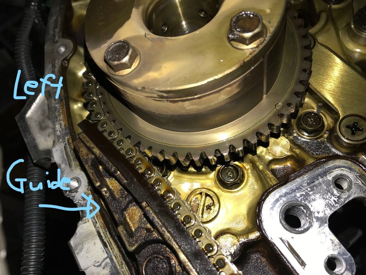

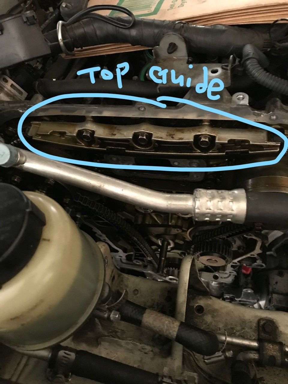

Parts are cheap as you know. The timing chain guide that fails most often is the one on the left. It is made of plastic and metal. I tried to get cheap versions on Amazon. But they don’t look 100% the same as OEM. So I returned them and got an OEM one from my local Nissan dealer. It was $65 in 2020. I also replaced the second guide (the one on the top). That one was cheaper around $30. The plastic from the old one felt a bit brittle after almost 20 years. I proactively swapped it out.
Given how challenging this project was I did not want to risk using cheaper non OEM engine parts. So I spent less than $100 on OEM parts. As fun as it was, I did not want to repeat the project any time soon to save a dollar or two.

Close up of timing chain guide on the left side
Guide on top of timing chain
