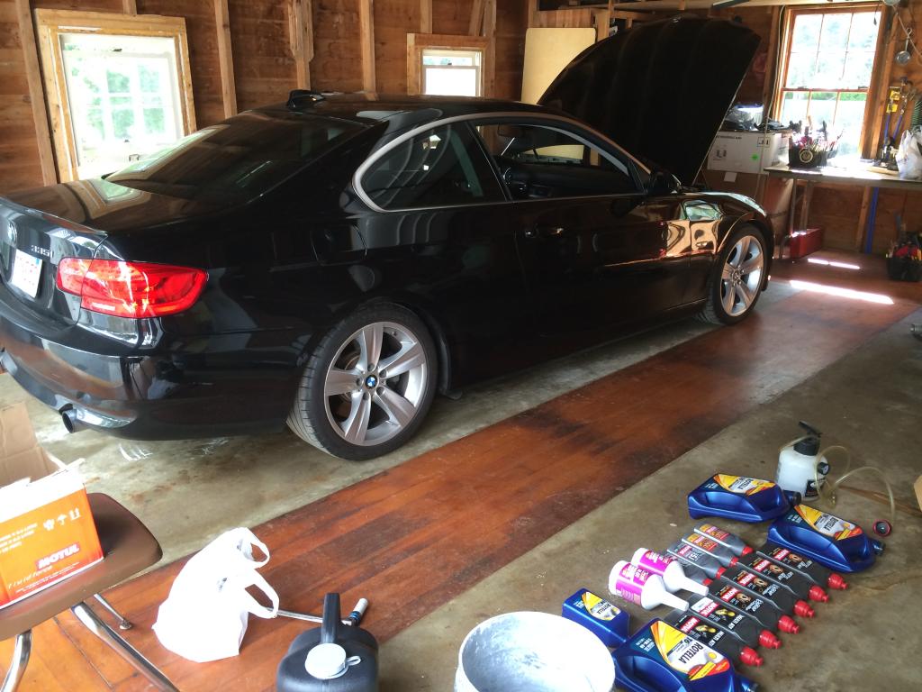

Update:
- Installed Koni/TCKline rear adjustable struts. Found a good deal from Cali with 10k miles. Stock struts were completely toast. When I do the front set, I will be buying spring perches and adding custom rate Swift 60mm coilover springs all around.
- Deleted Clutch Delay Valve (easiest mod, hated this thing)
- Replaced most fluids with synthetic:
- Motor oil: Shell Rotella T6
- Brake/Clutch fluid: Motul RBF600
- Transmission fluid: Redline D4 ATF
- Rear Differential fluid: Motul Motylgear 75w90
The rest of the fluids went in my buddies 335:
Next up: 12mm rear spacers, window trim, and remaining suspension.

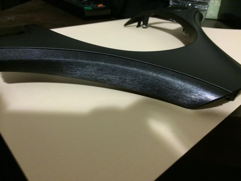

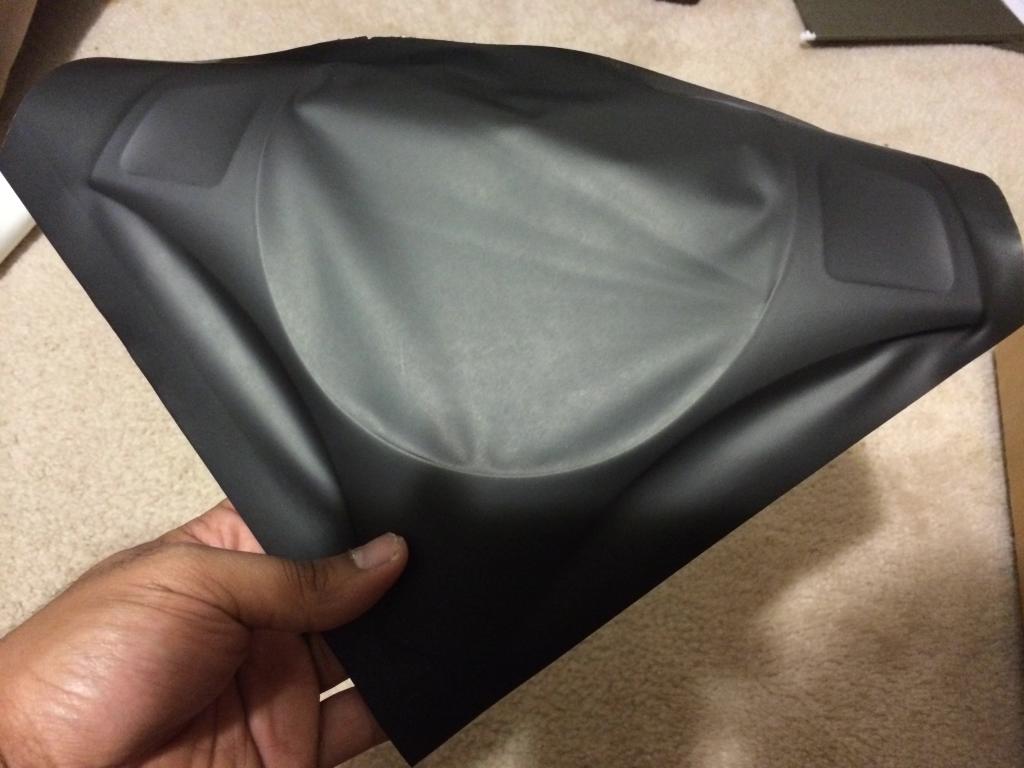

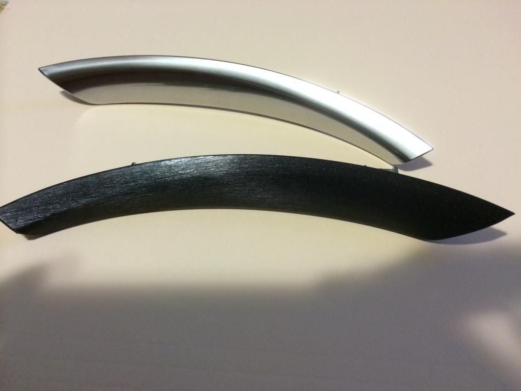

More wrapping.

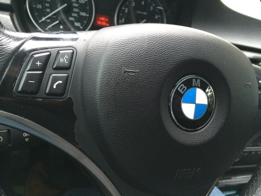

Steering wheel trim failure. BMWs have this soft-touch coating that loves to peel off.
Removal.
Sanded and wrapped in 3M 1080 Matte Black.
3M 1080 Brushed Black for the chrome/silverish pieces to match the dash.
All wrapped up.
Reinstalled.
Old Oct 13, 2014 | 08:19 AM
  #246
Crusher103's Avatar
Joined: Sep 2004
Posts: 54,042
From: Dur-ham NC
ok i might have to do that to my steering wheel. The whole trim piece just pops off with a screw driver or is it screwed in?
Old Oct 13, 2014 | 11:56 AM
  #247
zero2sixtyZ's Avatar
You embarrass me.
iTrader: (30)
Joined: May 2005
Posts: 5,308
From: Malden, MA
It was attached with 3 x T20 screws, and then just have to pry it off around the airbag carefully. The steering wheel control harness was not detachable, so the assemblies are removable with two more screws.

Very well done, Zero! That looks great.
My wife's Honda has the same issue, with some soft-touch coating on the arm-rest plastics. After 6 years, it's all peeling off.
Thanks Rochester!
I actually bought everything to paint the piece, and felt that it would not come out uniform, especially since I'll be staring at it everyday.

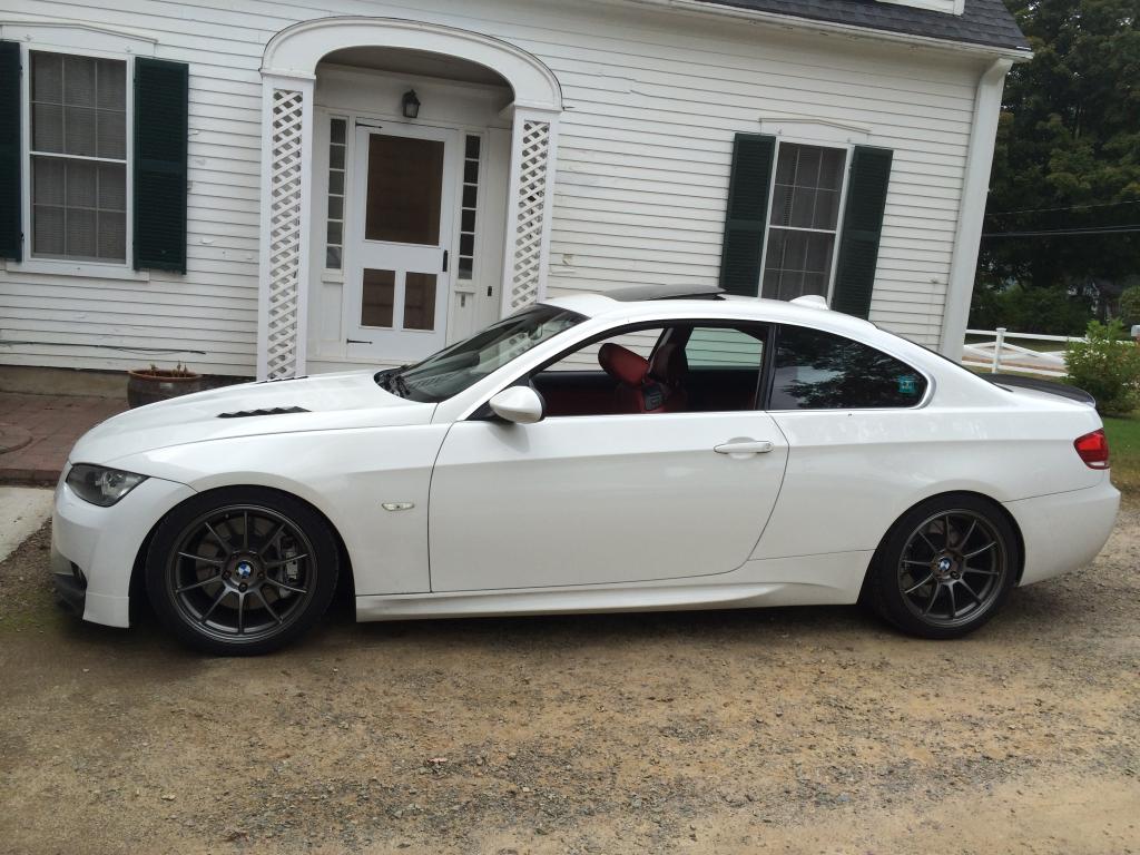

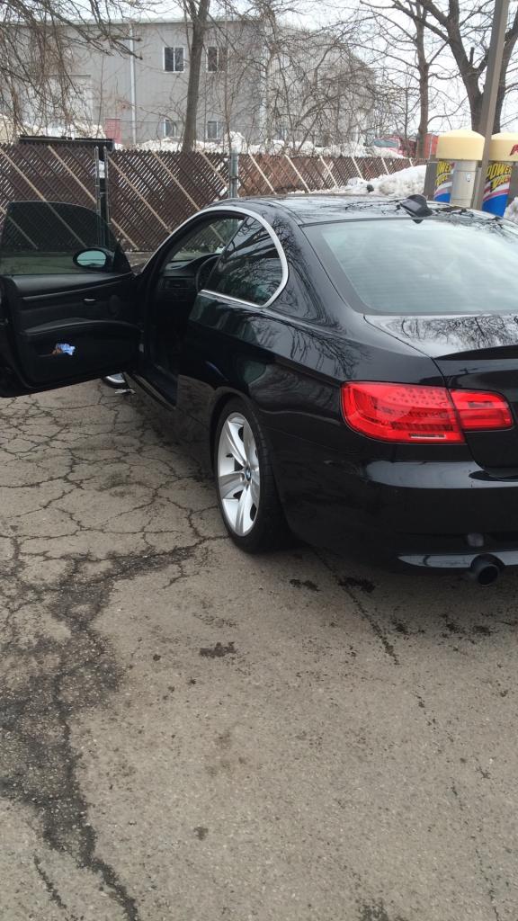

Winter update:
Car is covered in snow right now, but this is what she looked like before the storms hit Boston:

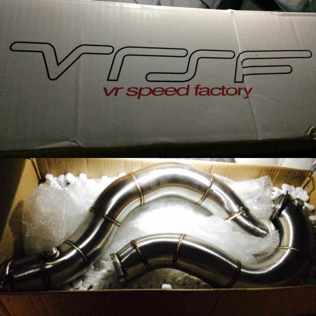

- Ordered 3" SS catless downpipes from VRSF on Black Friday. Waiting eagerly to get these in:

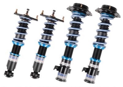

- Last talks before ordering these: Fortune Auto Series 500 Coilovers
-- w/ Swift coilover springs 8k/12k, custom valving to match
-- Koyo radial bearing and AMSOIL syn. shock fluid upgrades.
- Whiteline rear subframe bushing inserts
- Manzo rear toe arms
- Powerflex poly rear upper strut mounts
- OEM M3 rear camber links
I'm going with the 335 setup in the front, and the M3 setup in the rear to match with OEM M3 camber links. This should reduce the deflection designed to work with the factory runflats. They will take a month or so to be built.

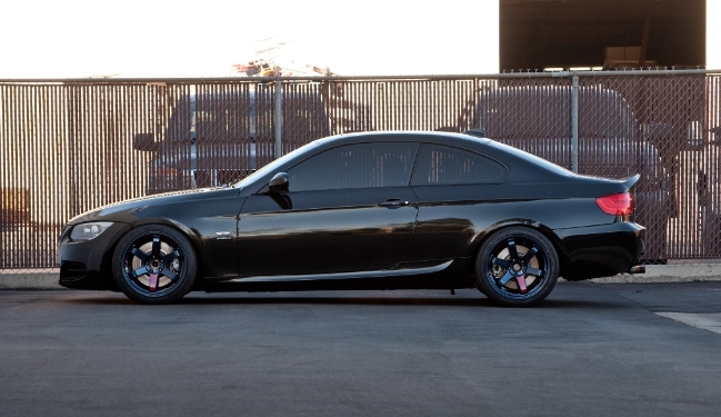

Ideally, I'd like to go with some simple, concave TE37s but the suspension is taking a good amount of the budget.
