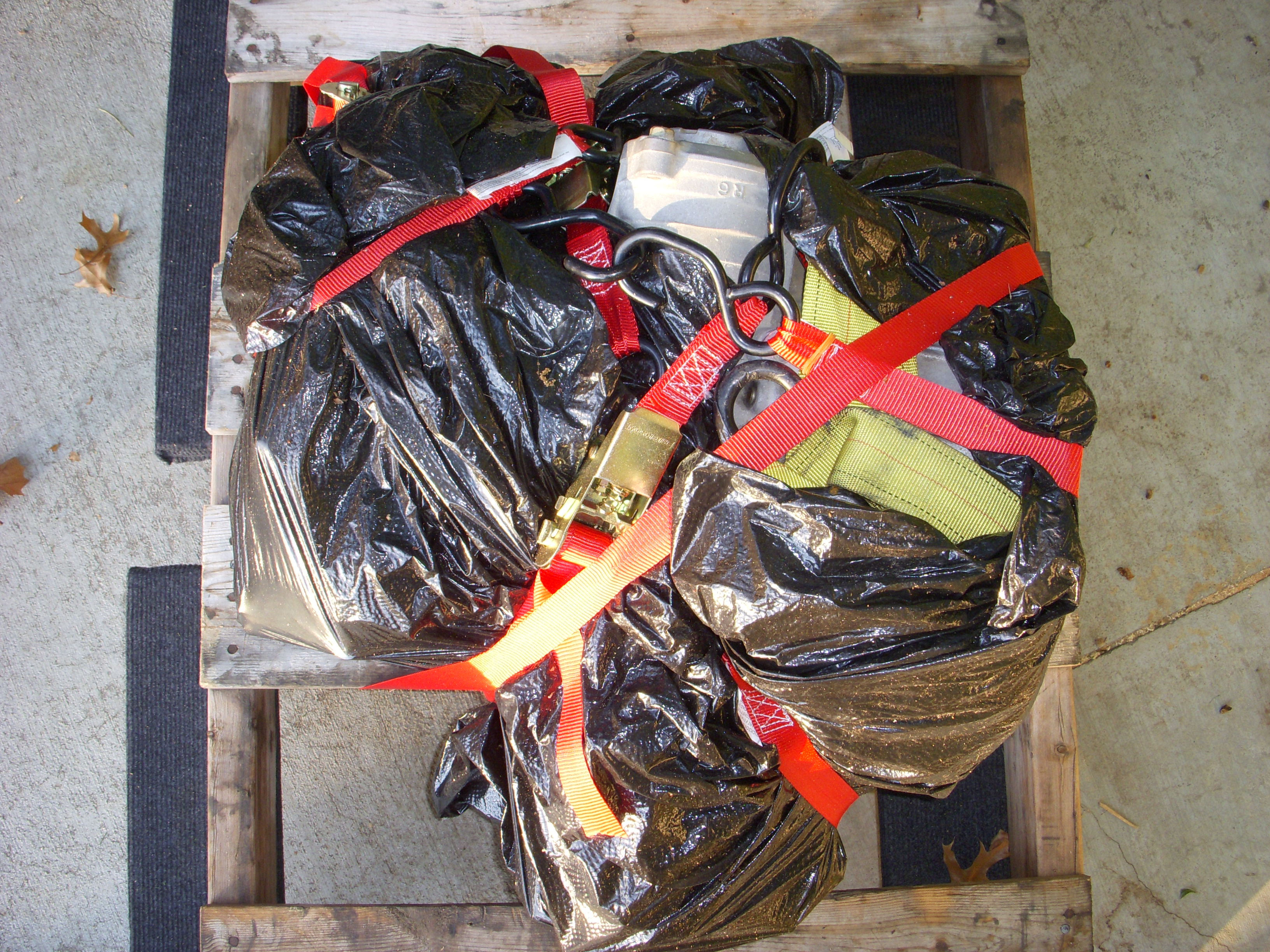

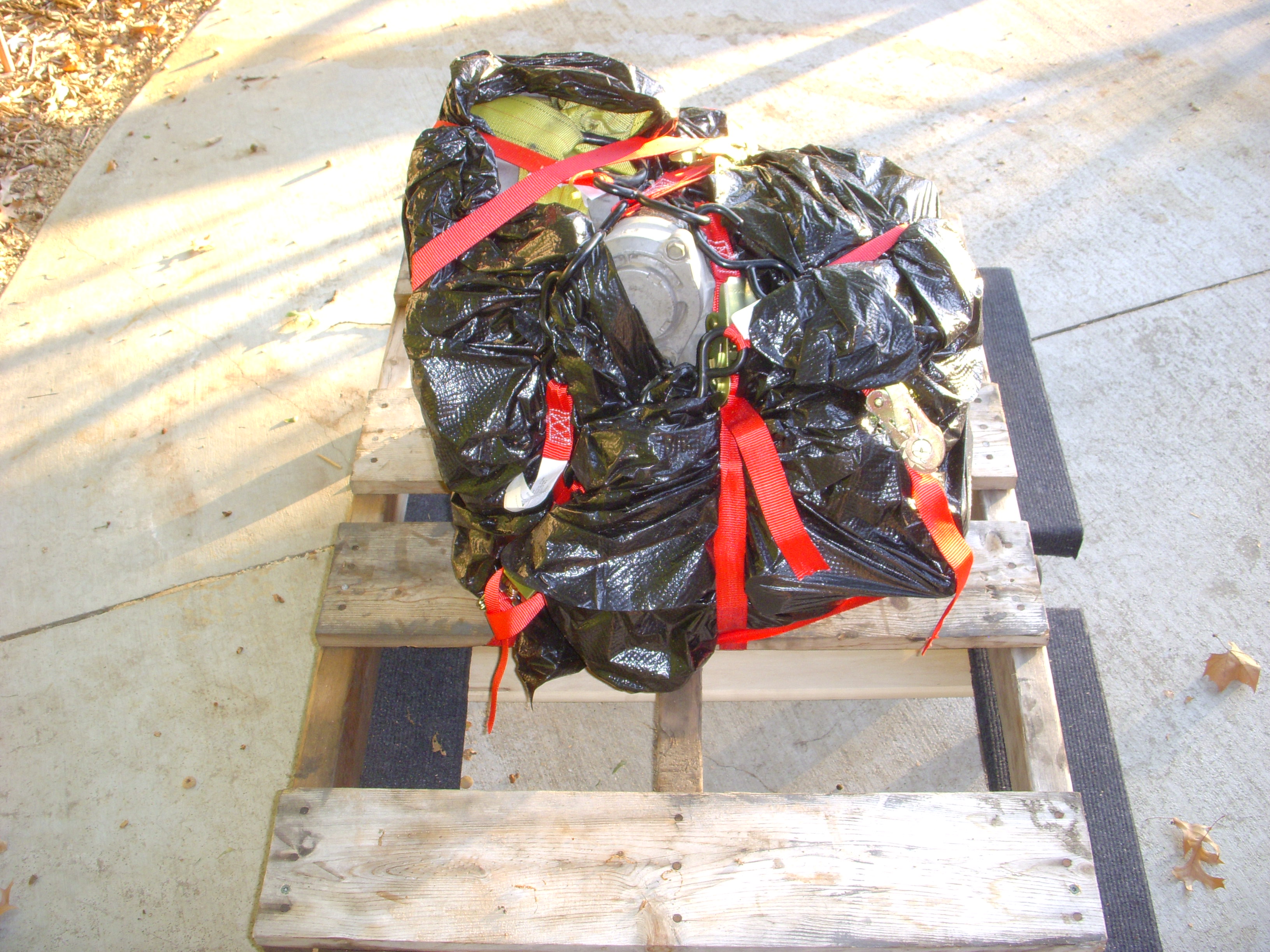

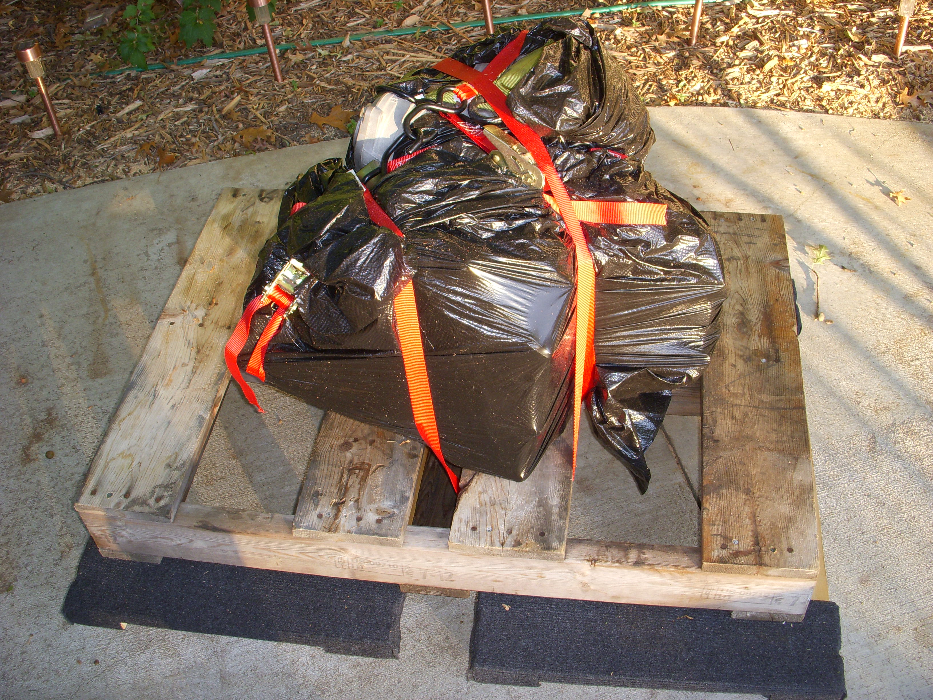

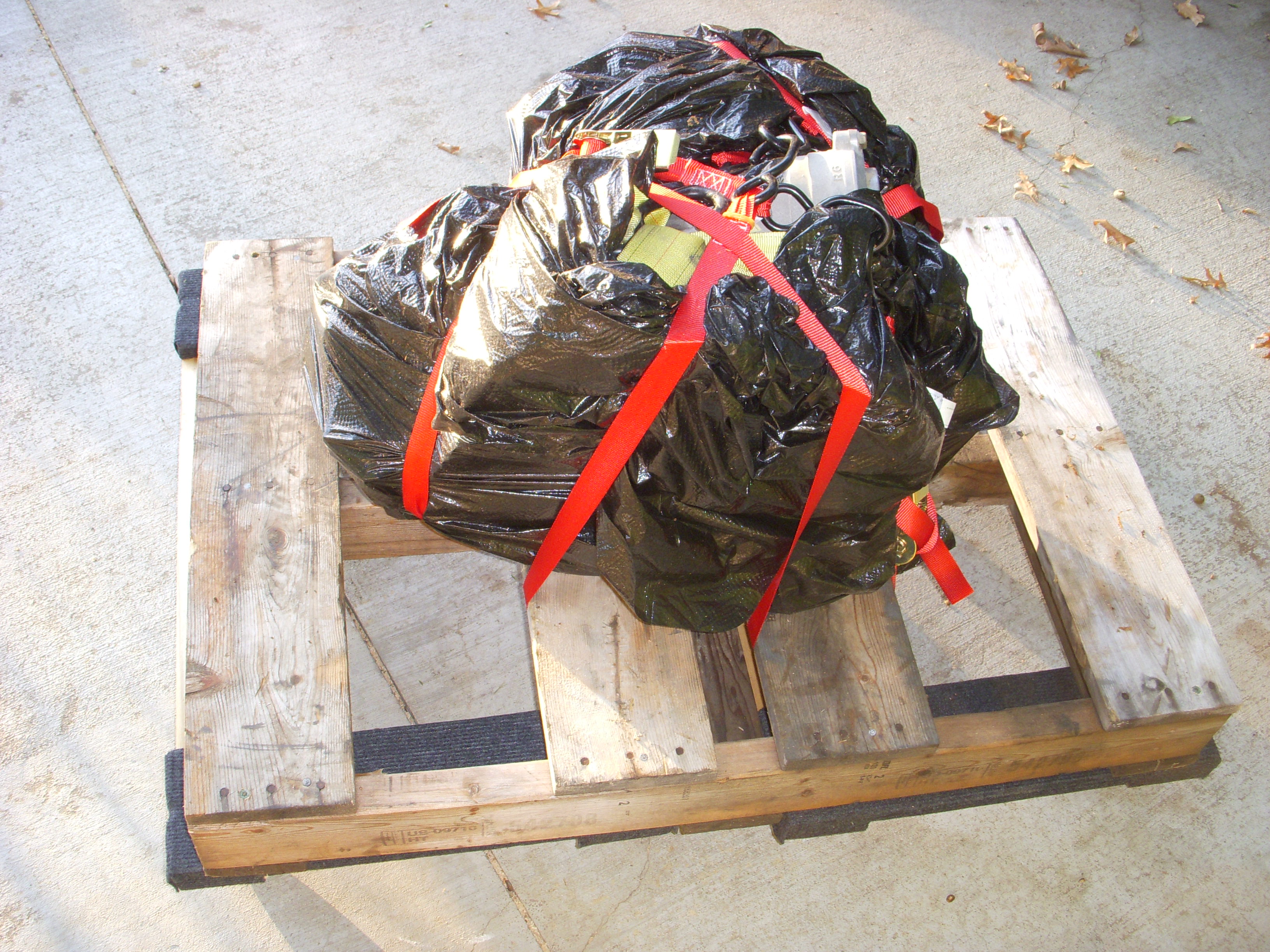

Altima tranny on a pallet
I took the dipstick tube (and dipsdtick) off the Altima transmission, tightened all the bolts on the Maxima bellhousing, blocked all the external tubes/holes on the transmission with Gorilla Tape, left it with no torque converter (don't need a stock one) wrapped it with two 1.5mm trash bags (the strong ones) hoisted it up on a pallet that was sitting on two HF furniture dollies, left the hoist straps attached, then strapped everything down with four 500 lb ratchet straps. Pallet is reinforced with many deck screws in addition to the original nails. Whew.
Funny thing - the normal speed sensor is missing on this transmission - there is a factory blocking plate where the sensor usually goes, and the differential has the gear for it, so I'm guessing that the 2006 Altima 2.5L computer doesn't need tis sensor to calculate vehicle speed. When it's installed in my car, the old sensor will go in the hole.
I'm going to Email my guy at IPT (with pix URLs) and check on the next step on shipping. I'm ready to do this thing.

I hope this is enough strapping for a transmission on a pallet.

Looks good to me!
My engine that I just put in my car was shipped to me on a pallet secured with old seat belts tied together for straps haha. So you should definitely be fine!

Originally Posted by krazy6
Looks good to me!
That's kinda unusual, but I was really thinking about using a couple rolls of Gorilla Tape to hold the tranny on the pallet. That would have been even weirder. I didn't want to give the trucking company any excuse to refuse the shipment, so I used the ratchet straps instead.
Your sig picture is a nice tribute to the KCIR drag strip - I miss that track. At least I was there for your appearance at KCIR... good times.

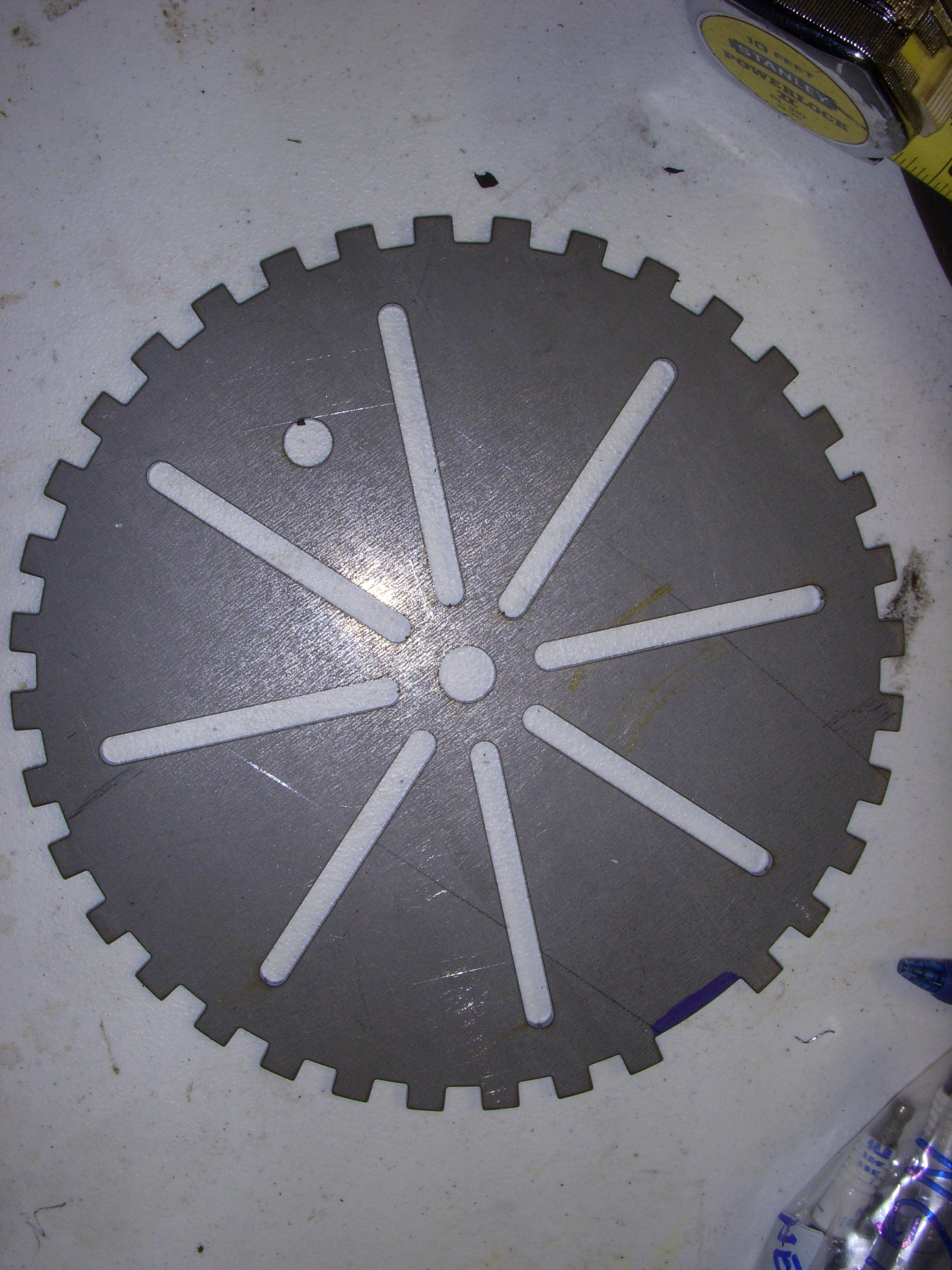

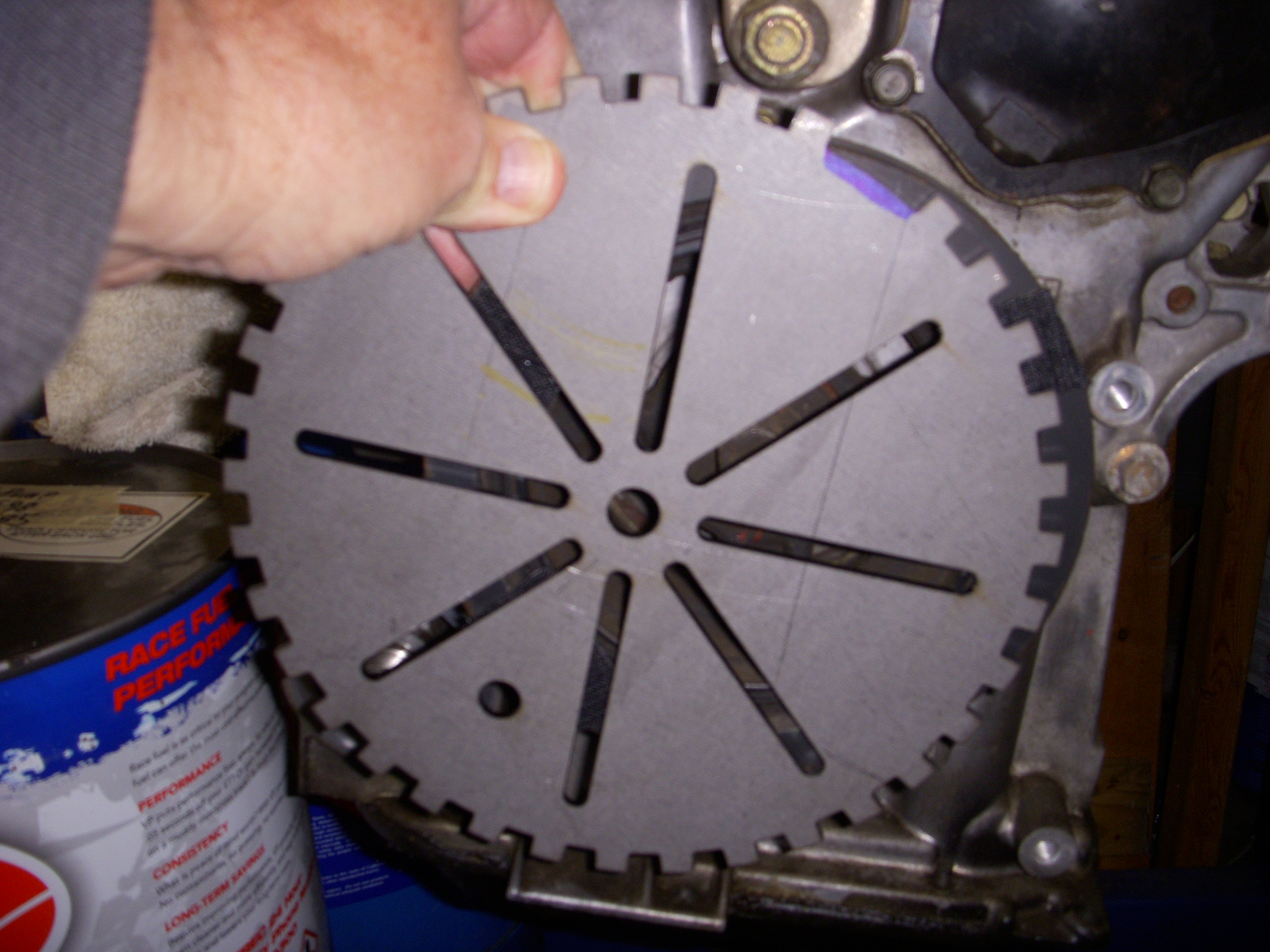

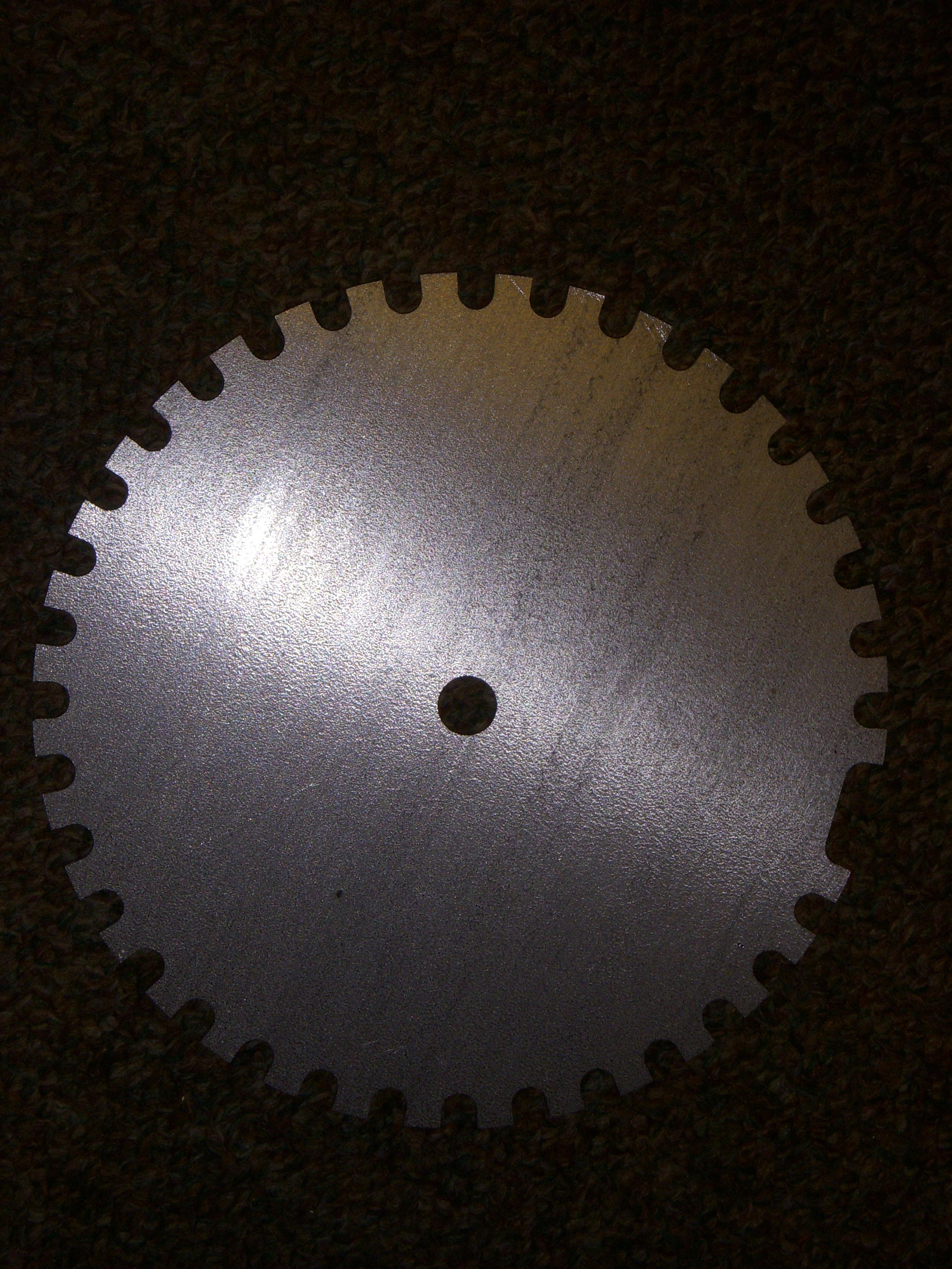

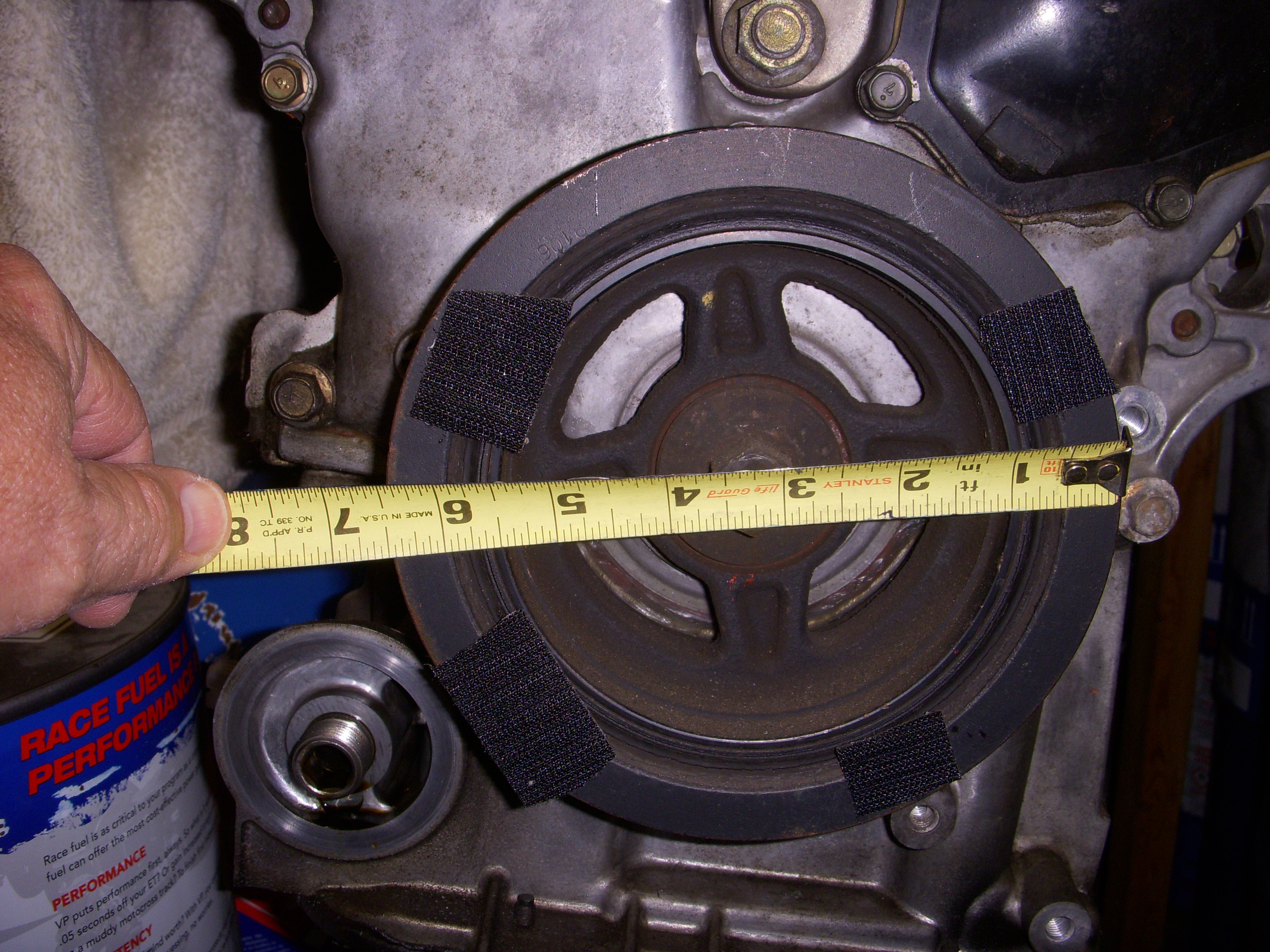

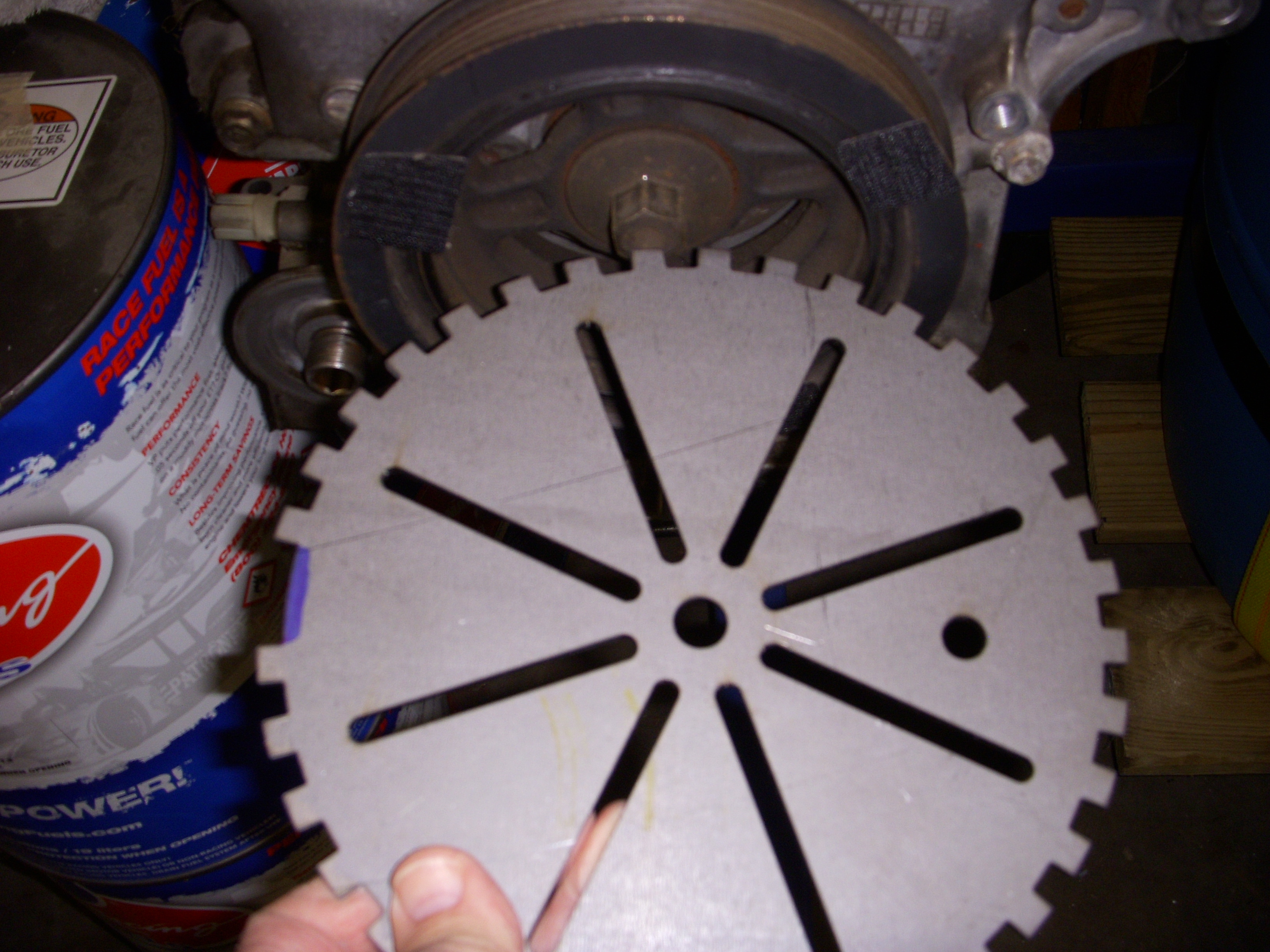

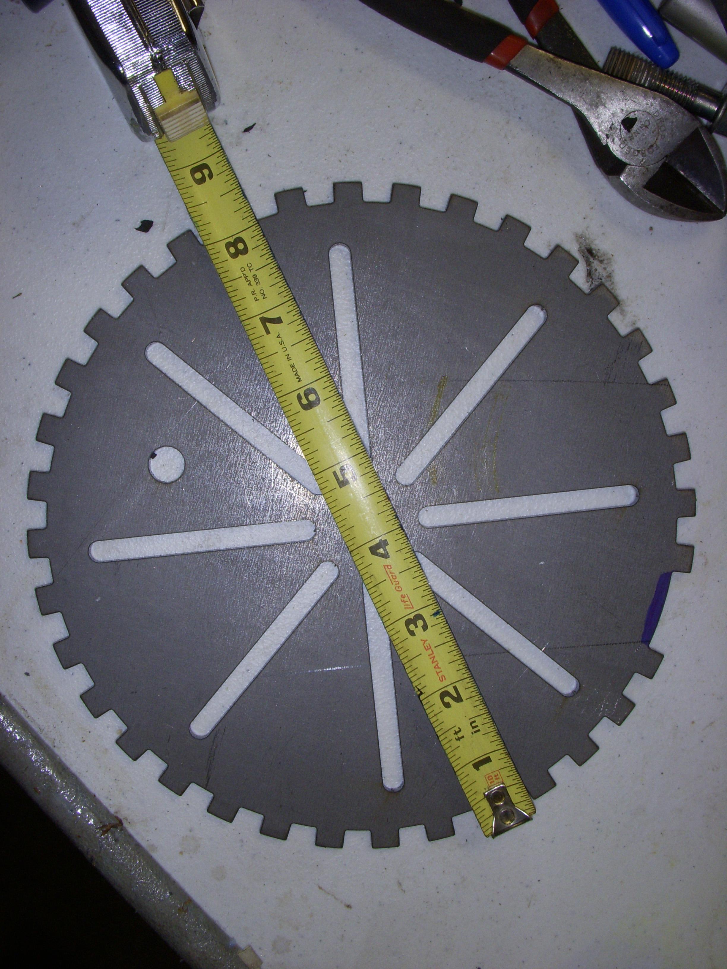

Haltech Sport 2000 Possible?
I have been trolling to find out about Haltech ECUs and installation. This might be possible. That particular Haltech is quite advanced, and is capable of operating independently of the factory ECU. It has sequential fuel injection and sequential ignition, especially coil-over-plug triggering. To set it up to control ignition and fuel, it needs crank and cam triggers to establish timing. My 3.5 has the 2003-2006 cam sensors reading the Cosworth cams. These sensors only need 12 volts in to give a 5 volt pulse out. The crank sensor can be a 36-1 trigger wheel. (36 teeth, one missing) The Maxima crank pulley is 6 1/2" diameter, and I have located and purchased a 7 1/4" 36-1 trigger wheel for experimenting. Something clever will be required to adapt the timing wheel to the factory pulley, but parts-in-hand are required to do that.
In addition, the 2000 ECU will require Haltech water and air sensors, their trigger wheel sensor, an O2 sensor input (from my PLX wideband), and connections to the OEM coils and my fuel injectors. Won't be cheap, but if I can come up with a way to mount the trigger wheel, it will be possible.
Extra bonus - it will be possible to switch back to the stock ECU if needed, since everything else remains connected. I don't know how unhappy the OEM ECU will be if it's not wired to fuel and ignition, but that's for the future. I REALLY would like to push this 8,000 RPM engine with 10,000 RPM valve train up to 8K - wonder how the IPT transmission will like that?

I have two different 36-1 trigger wheels on order now - one's 7 1/4" in diameter and the other is 8 1/4". I'll need to come up with some way to mount one of them once I have parts-in-hand. I think the 8 1/4" wheel may hit the oil filter, but that's what parts are for. I'm tempted to mount a 7" 1/4" steel round plate on the pulley with a MIG weld then drill holes to mount one of the trigger wheels on it.
I also still need to find a 2002-2008 Maxima engine harness section that has the two cam sensor plugs attached. It's a small piece of cable but I haven't found one for sale anywhere - yet.

trigger wheel number one
Got the 8 1/4" 36-1 trigger wheel. This one is balanced and has plenty of adjustment slots. The second wheel is still on the boat from England. The big question is still how to fasten one wheel to the pulley.

This trigger wheel came today - from England
The 7 1/4" trigger wheel was delivered today. It's another 36-1 wheel, thick and heavy - 1/8" thick steel...
Now if there's some way to mount one of the two wheels on the crank pulley...

Somebody used to make an aluminum pulley for the FWD 95-2001 Maxima that had a ring with the four timing tabs for the 3.0. There were both an undersize and regular size pulley available. Seems like this pulley had a nice smooth front area where a timing wheel could be attached, but I need to search for it.
EDIT: Unorthodoxperformance is the maker - it's on ebay, but the front of the pulley appears to be too lightweight to attach a steel trigger wheel. They only list the underdrive version, which also means two different belts for accessories. OBX makes one, but 2J Racing says they've broken two of them on a racing Sentra. They gave up on OBX.
Anyone know if the stock damper has a rubber ring inside? I think it does, but... ?
