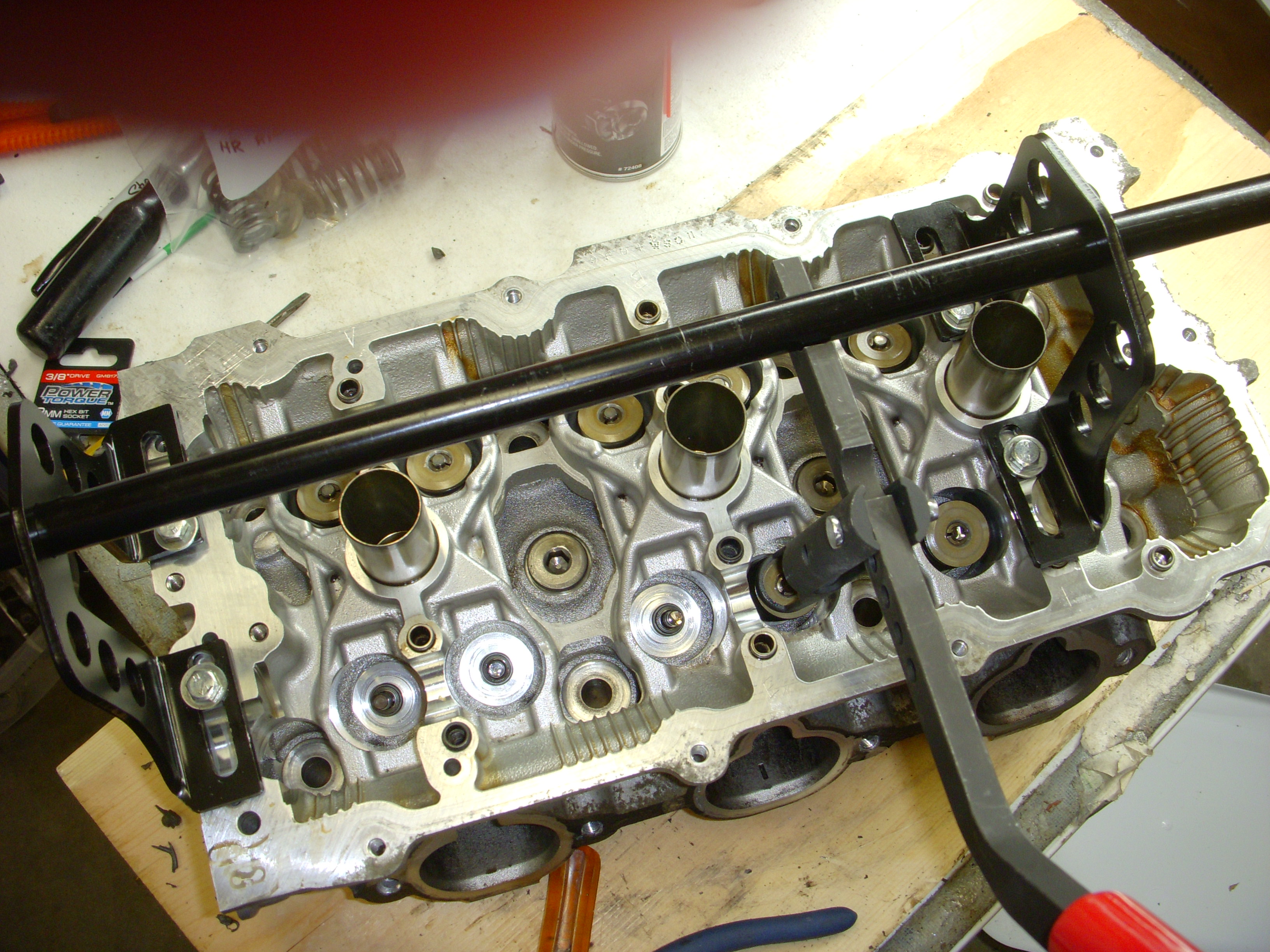

How I'm removing the valves and associated parts from the heads...
File Type: jpg

HR Valve retainers ??
Car is sitting on my trailer in the storage yard, but it has company. Looks like a Donk in the background...
I was thinking about ordering Titanium valve retainers for my new HR heads, but there's some considerations. The new JWT cams have such high lift that the new HR valve springs must be hand-selected so they don't bind - which means I can't buy just any brand of spring. The stock HR valve retainer is aluminum, not steel, so Hmmm let's buy a digital gram scale and compare the HR aluminum retainers to the Cosworth titanium retainer weight. Went to my storage unit to look at some engine parts...
What's inside:
Titanium 5.6 gms.
Aluminum 5.06 gms. Stock HR...
Cosworth dual-springs, +1mm Ex valve, titanium retainer ( rated to 10,500 RPM )
Stock HR spring and some weak springs to degree in the cams...
Long story short - the HR retainers are about 1/2 gram lighter than titanium ones !!

Today the FedEx truck dropped off the new custom cams, a couple of bags of hand-selected valve springs, timing specs (written on a piece of yellow note pad !!) and four bumpy cams ground and drilled for the 3.0 timing setup.
Head with machined intake grooves:

The heads go to the machinist tomorrow for a light decking cut, and general cleaning of oil passages. This is gonna be fun !!
