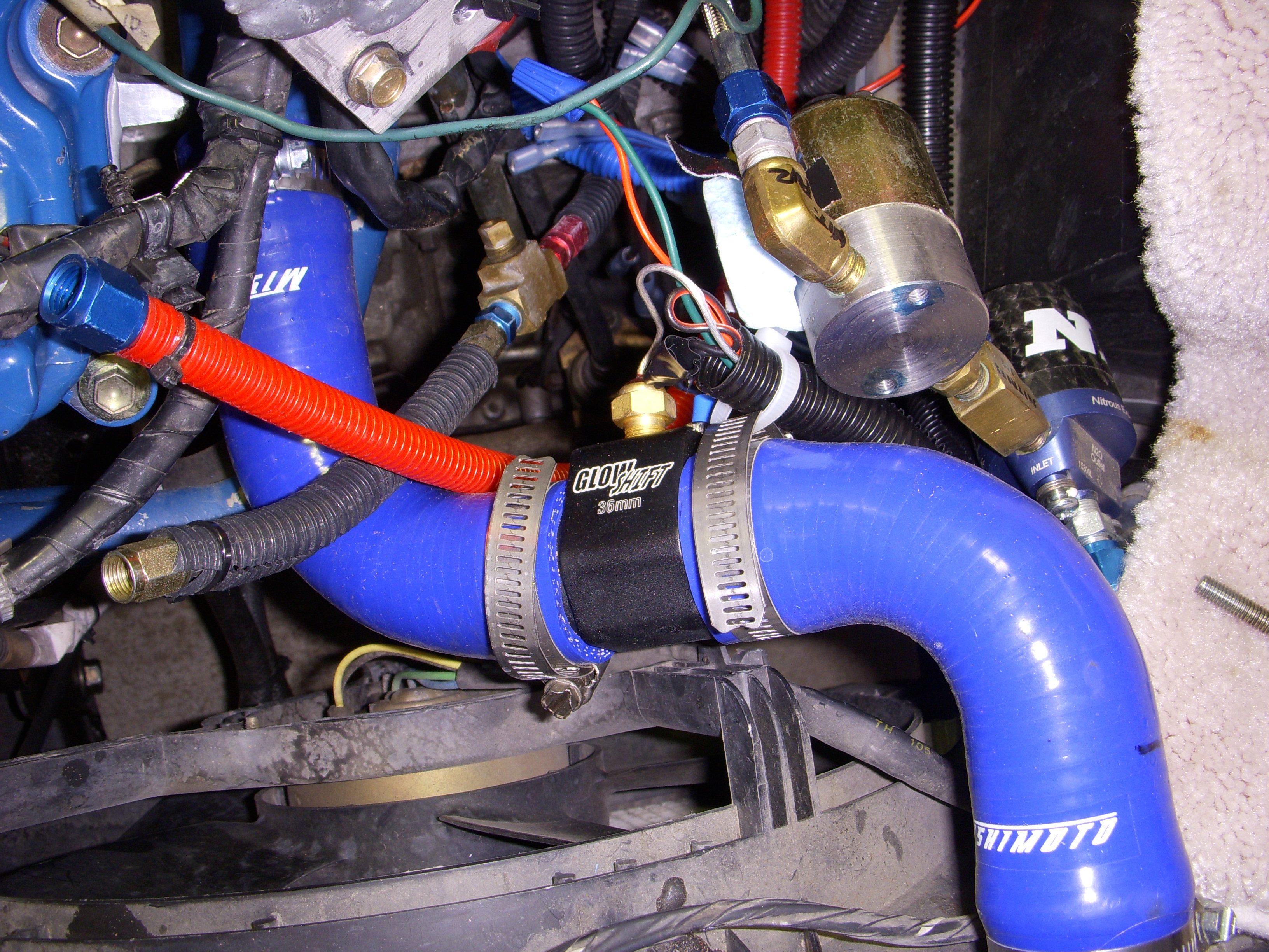

Second - I mounted the three temperature gauges in the center of the dash and hooked up the water temp 6-wire cable that was left over from the old PLX A/F gauge. I wanted to test it so I connected the sensor ground to the common ground of the relay switcher ground wires. When I went out for a drive, the water temp would display and increase as the engine warmed - but the display would cut in and out. What the hay? I woke up at 3AM and realized that the 3 relay ground wires weren't grounded - no 4th wire - so I grounded them and poof! everything worked normally - temp gauge AND relay switching of nitrous stages, and the big bog was gone. I did build contact adapters for the tranny and engine oil temp sensors, since I see no good way to get the sensors into the fluids.

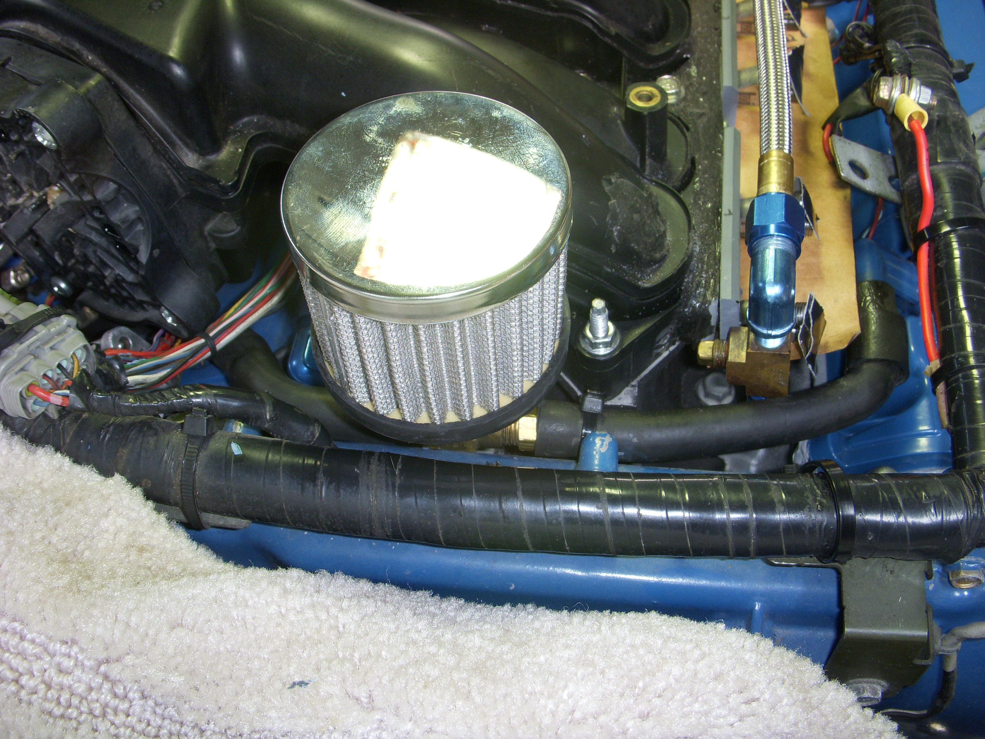

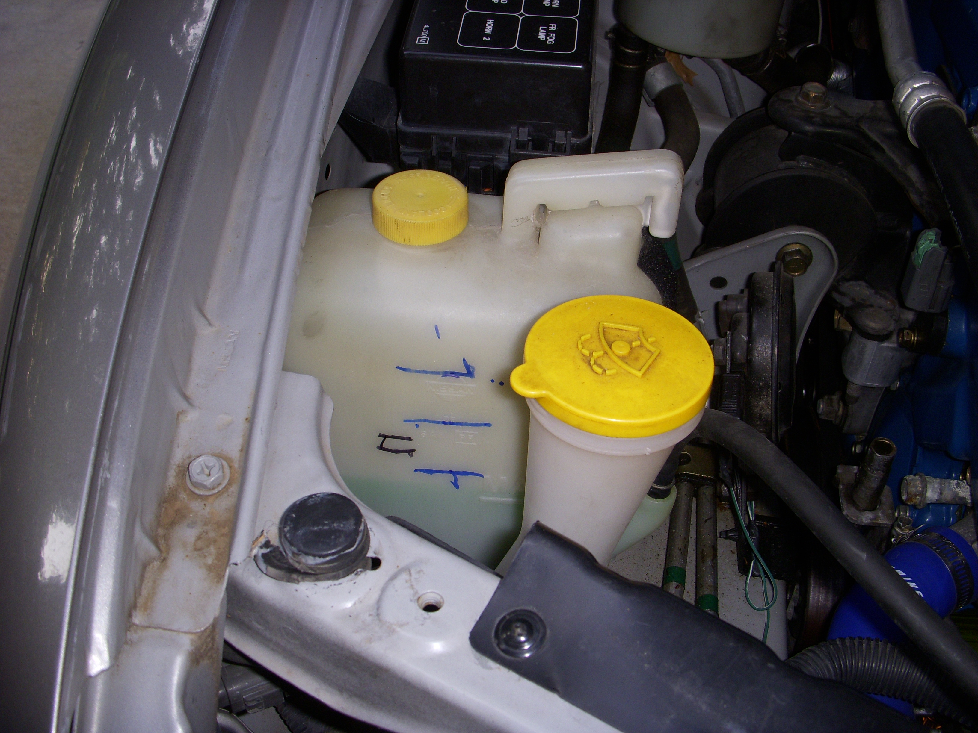

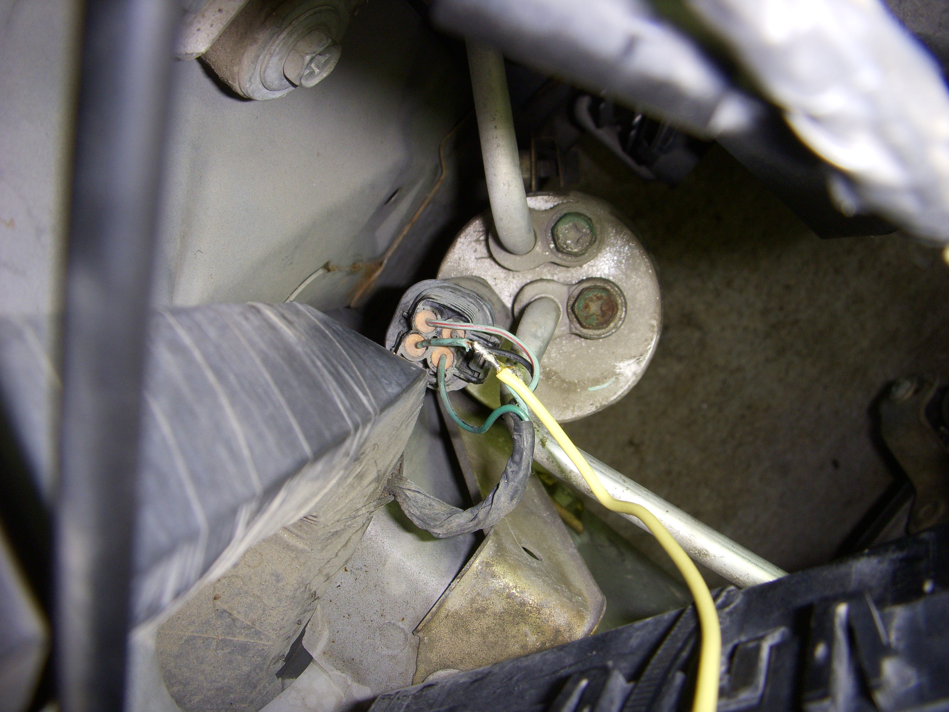

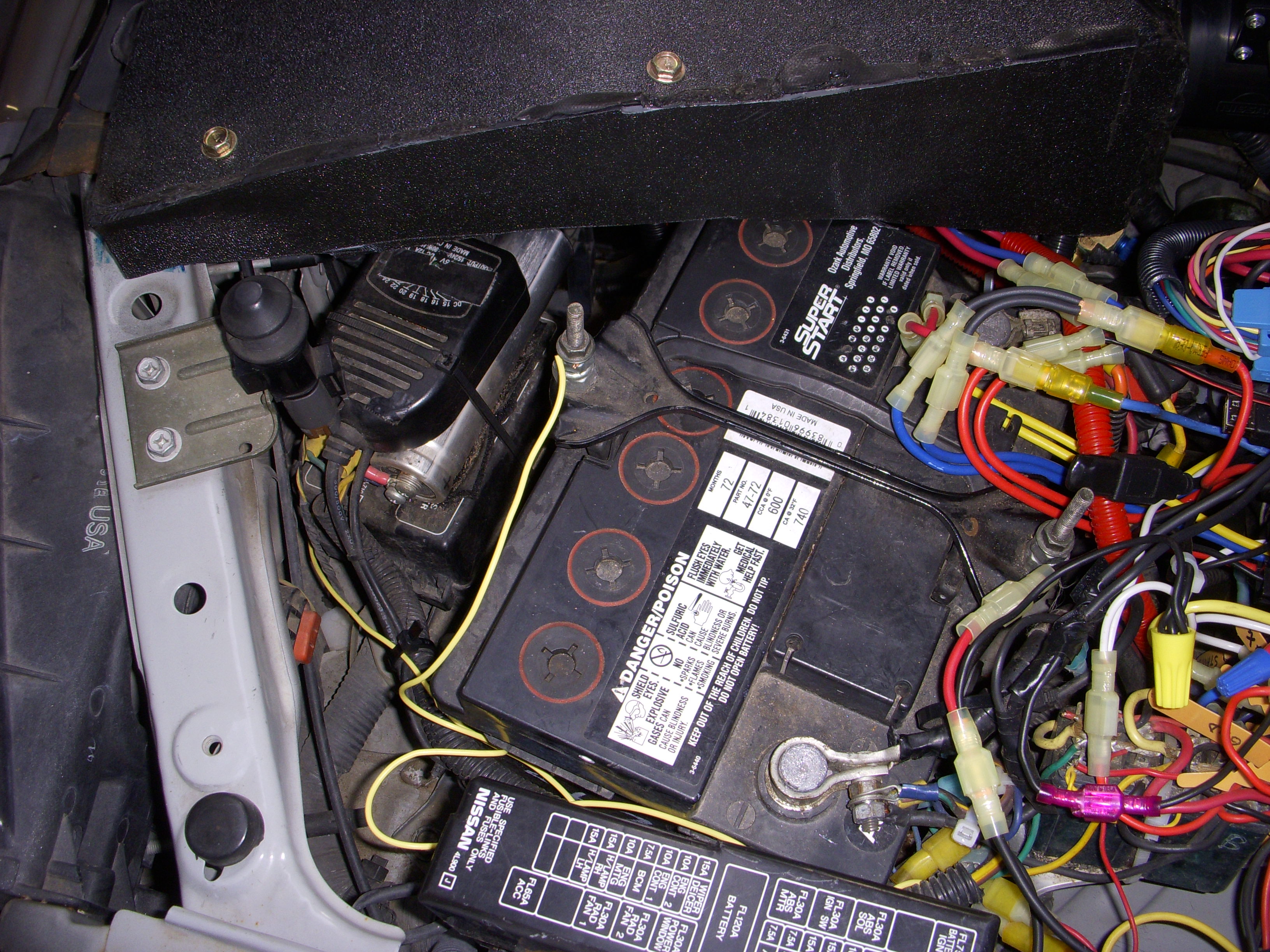

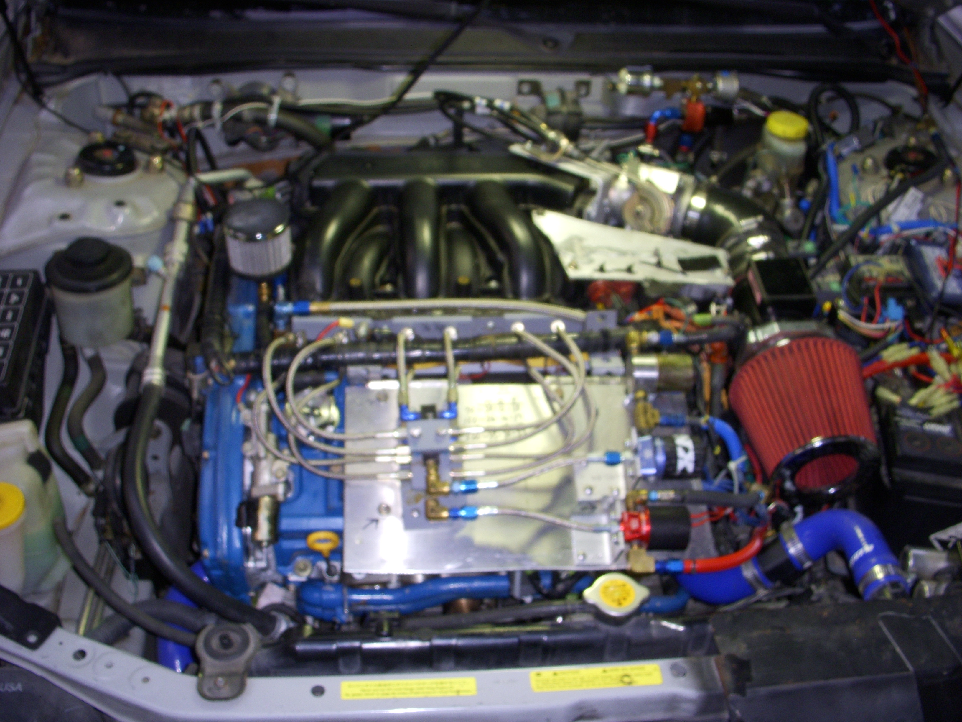

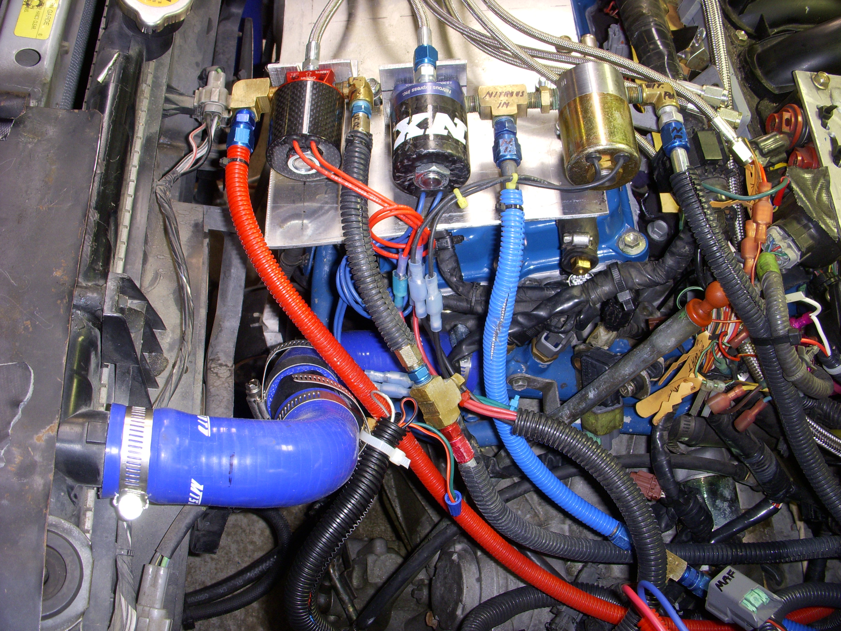

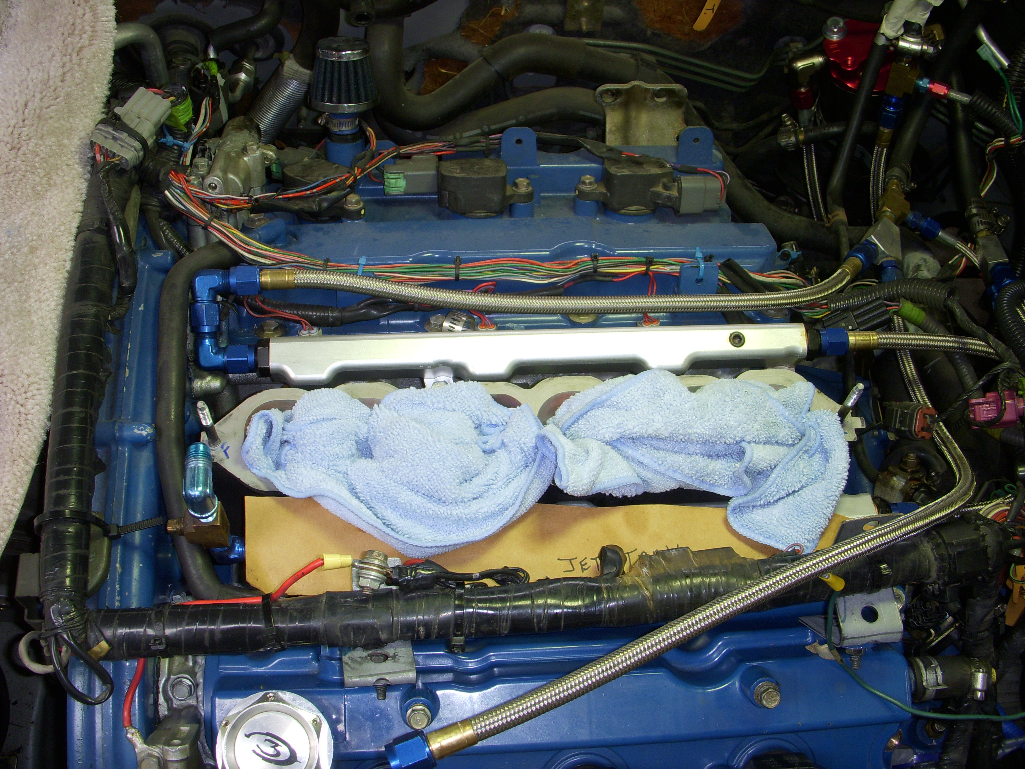

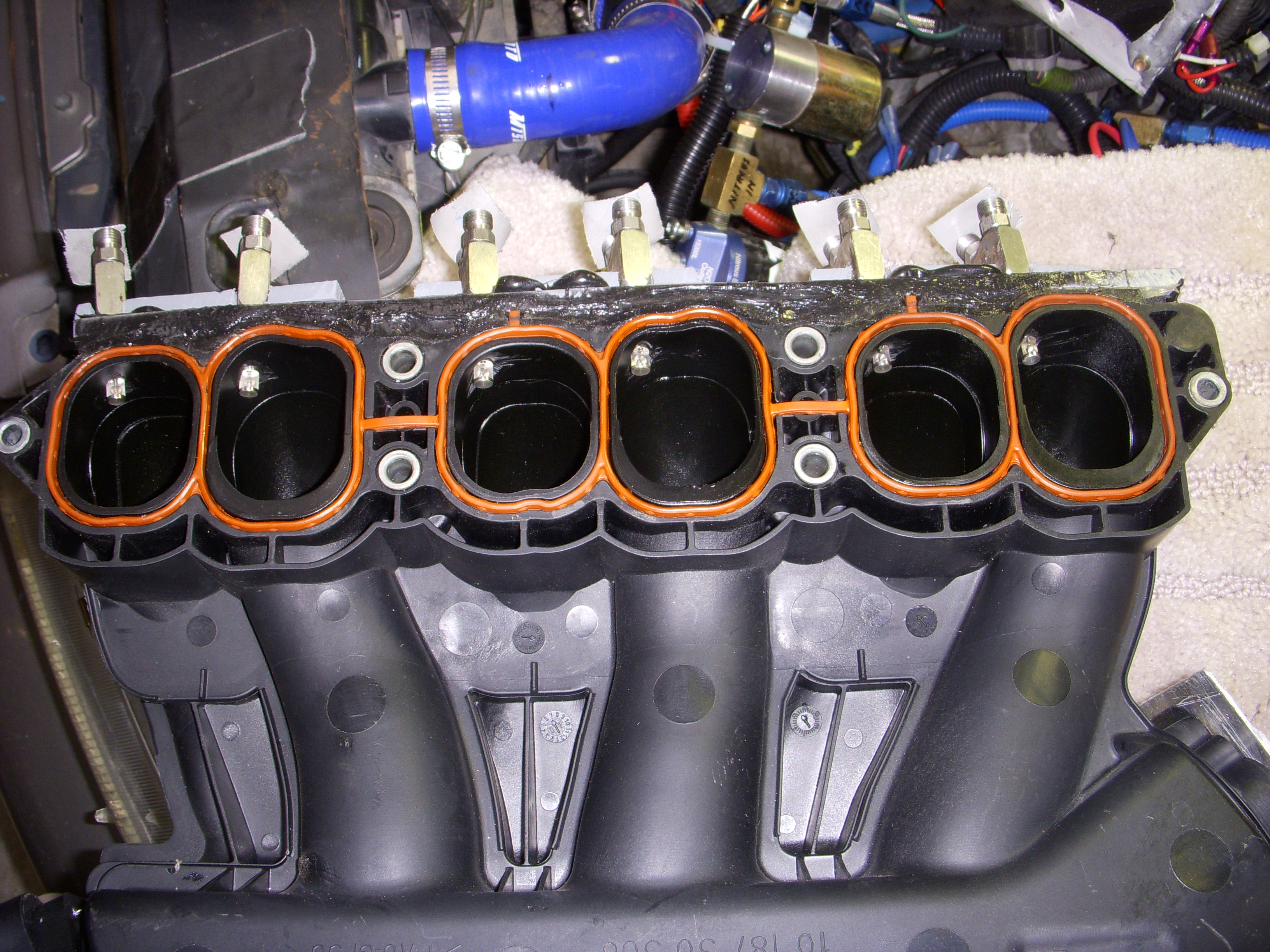

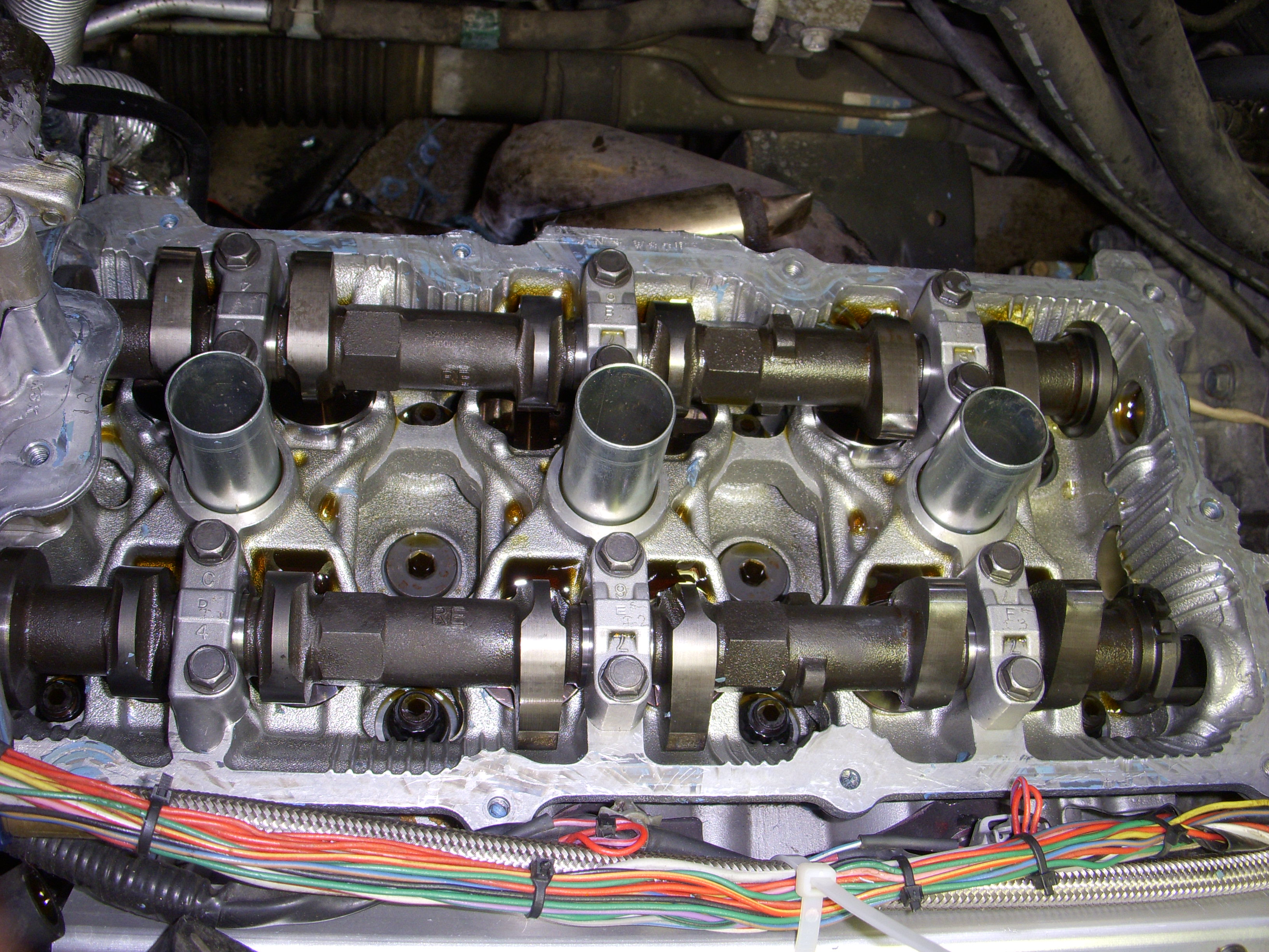

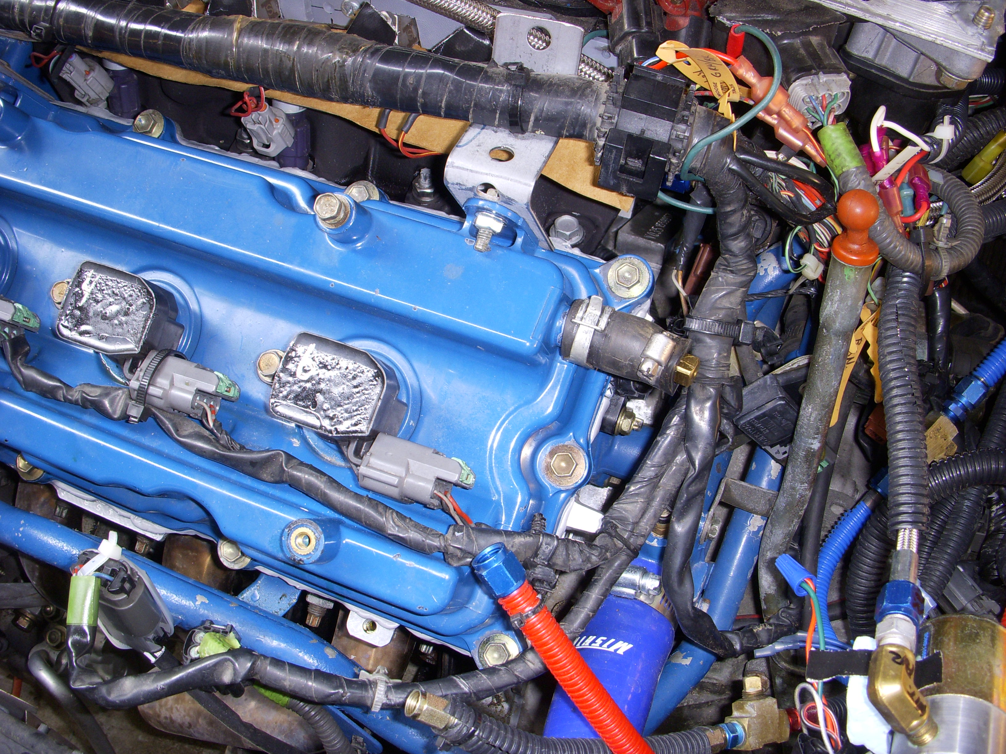

More changes, cleanup, and new fuel solenoid

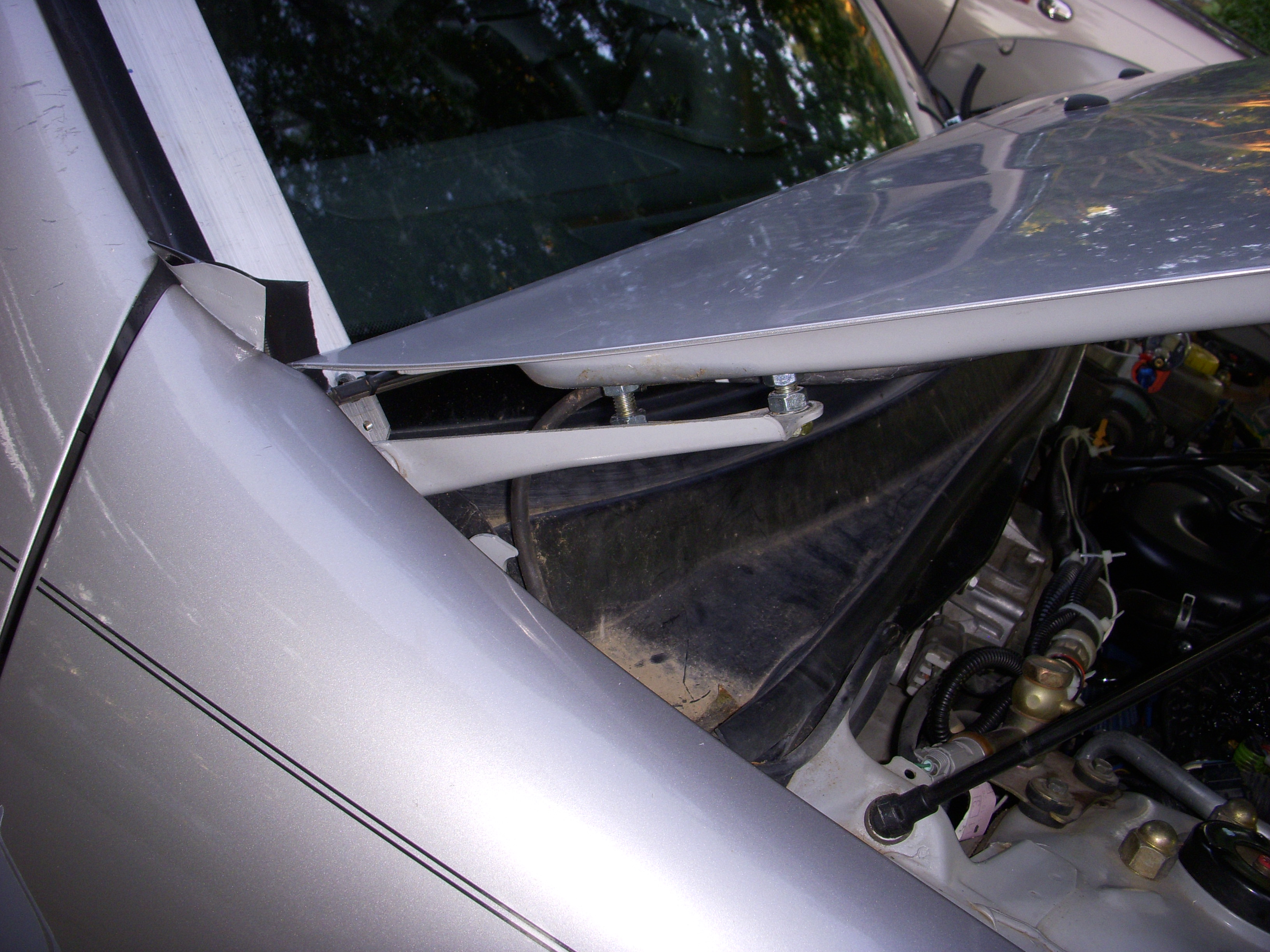

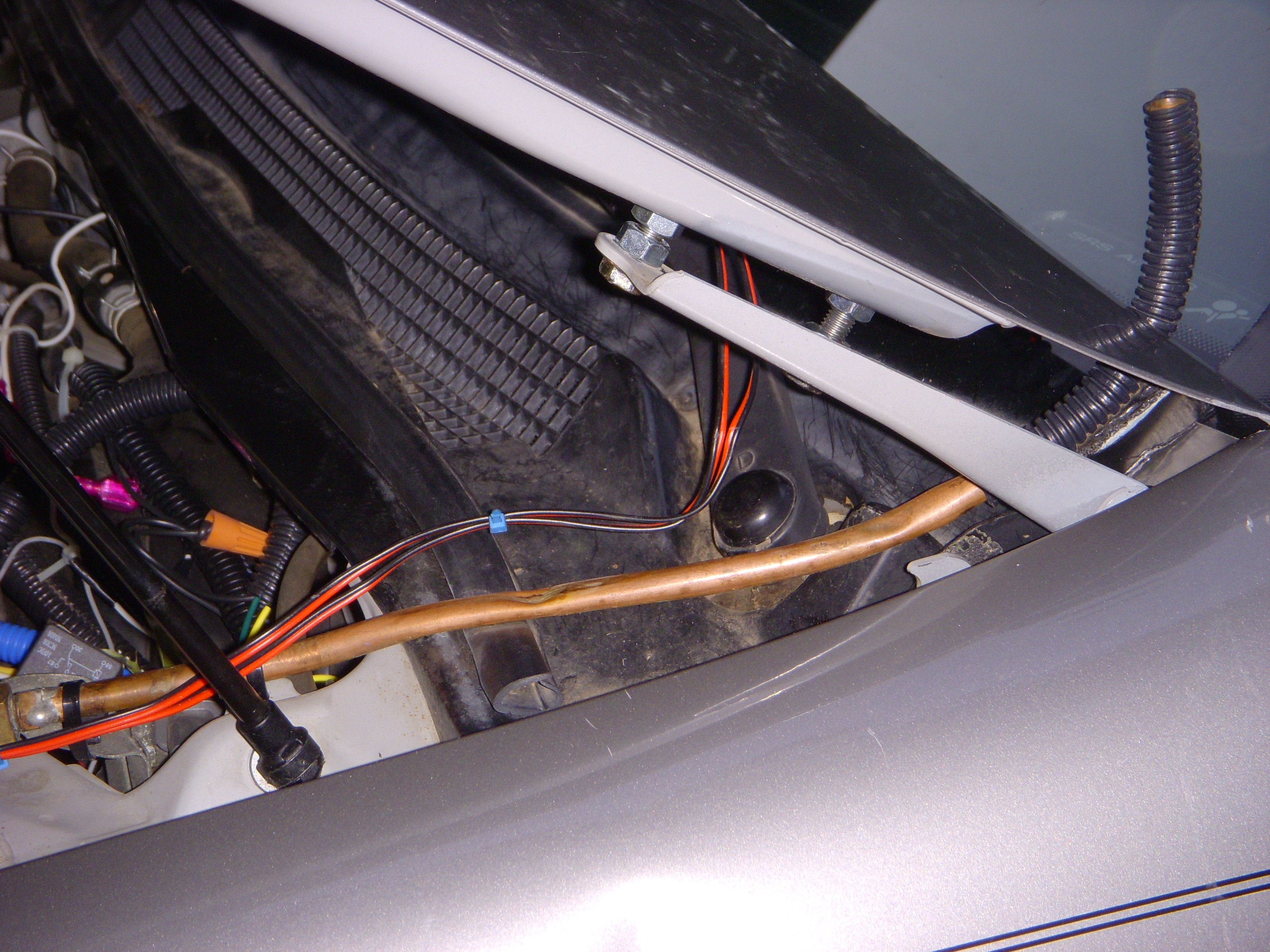

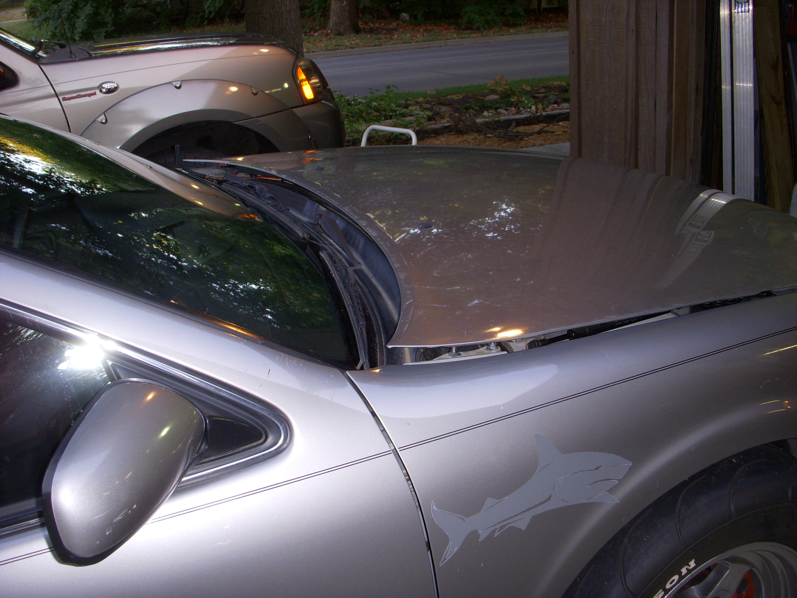

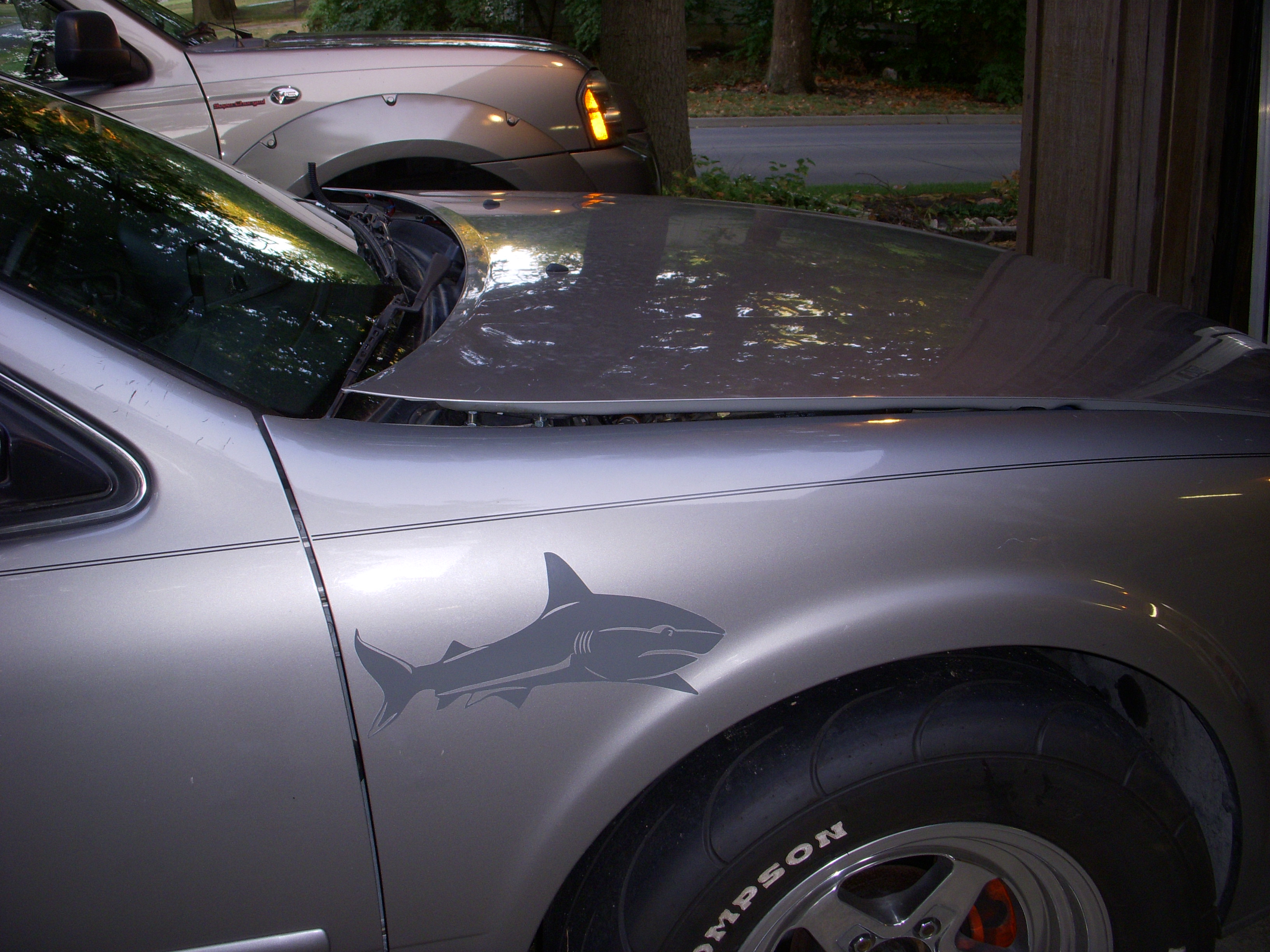

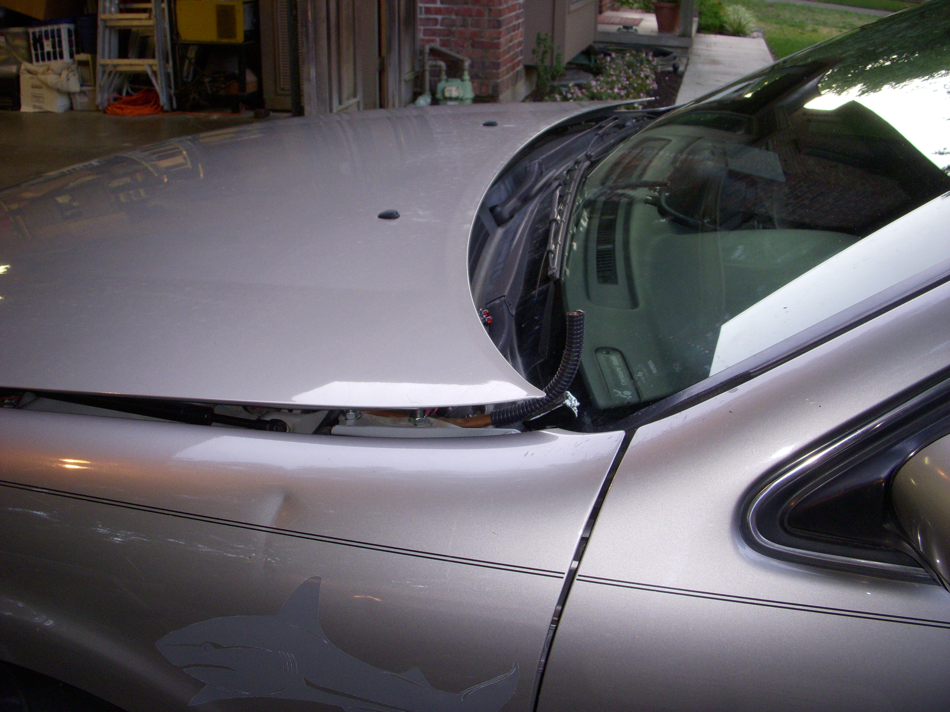

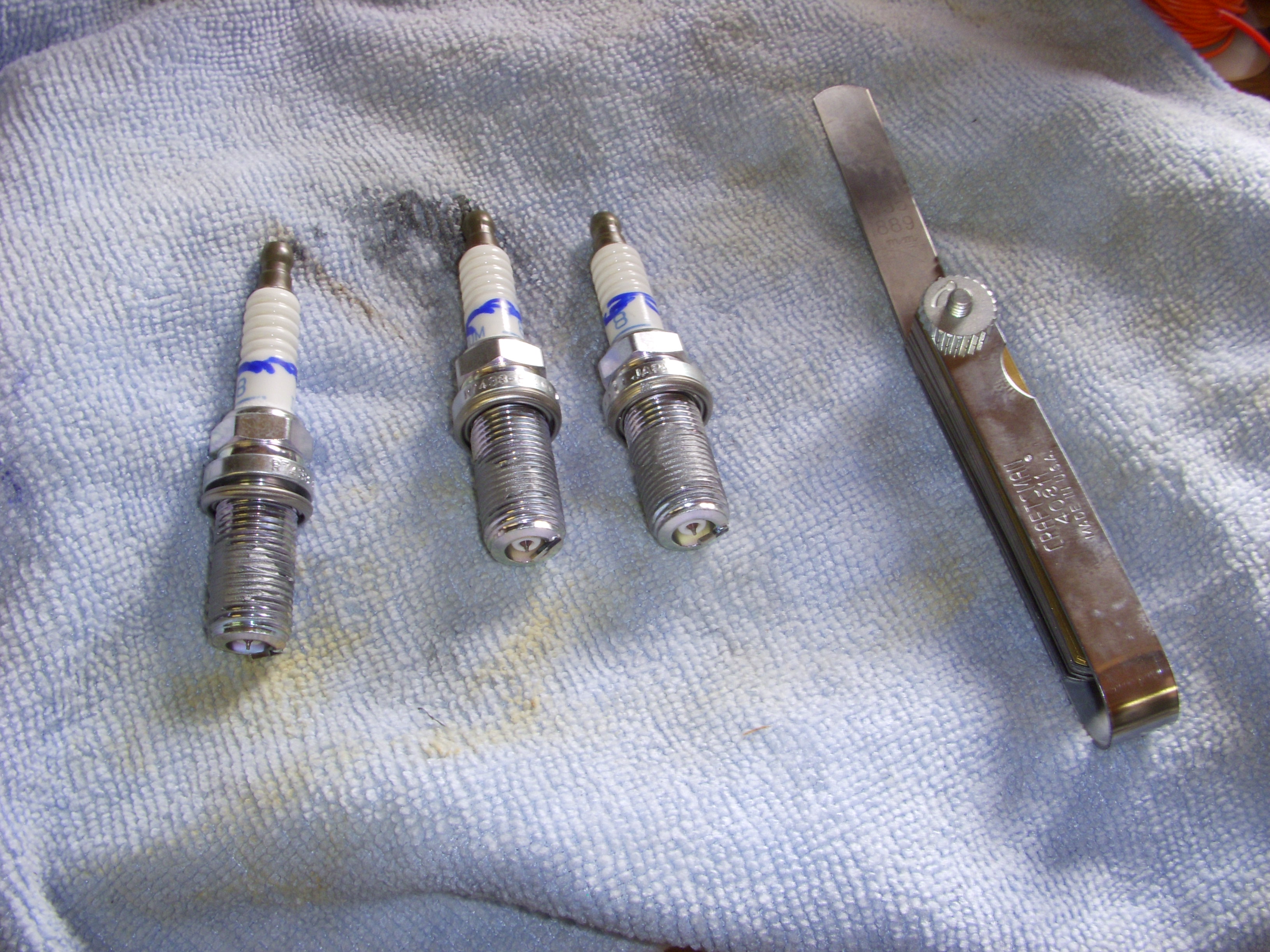

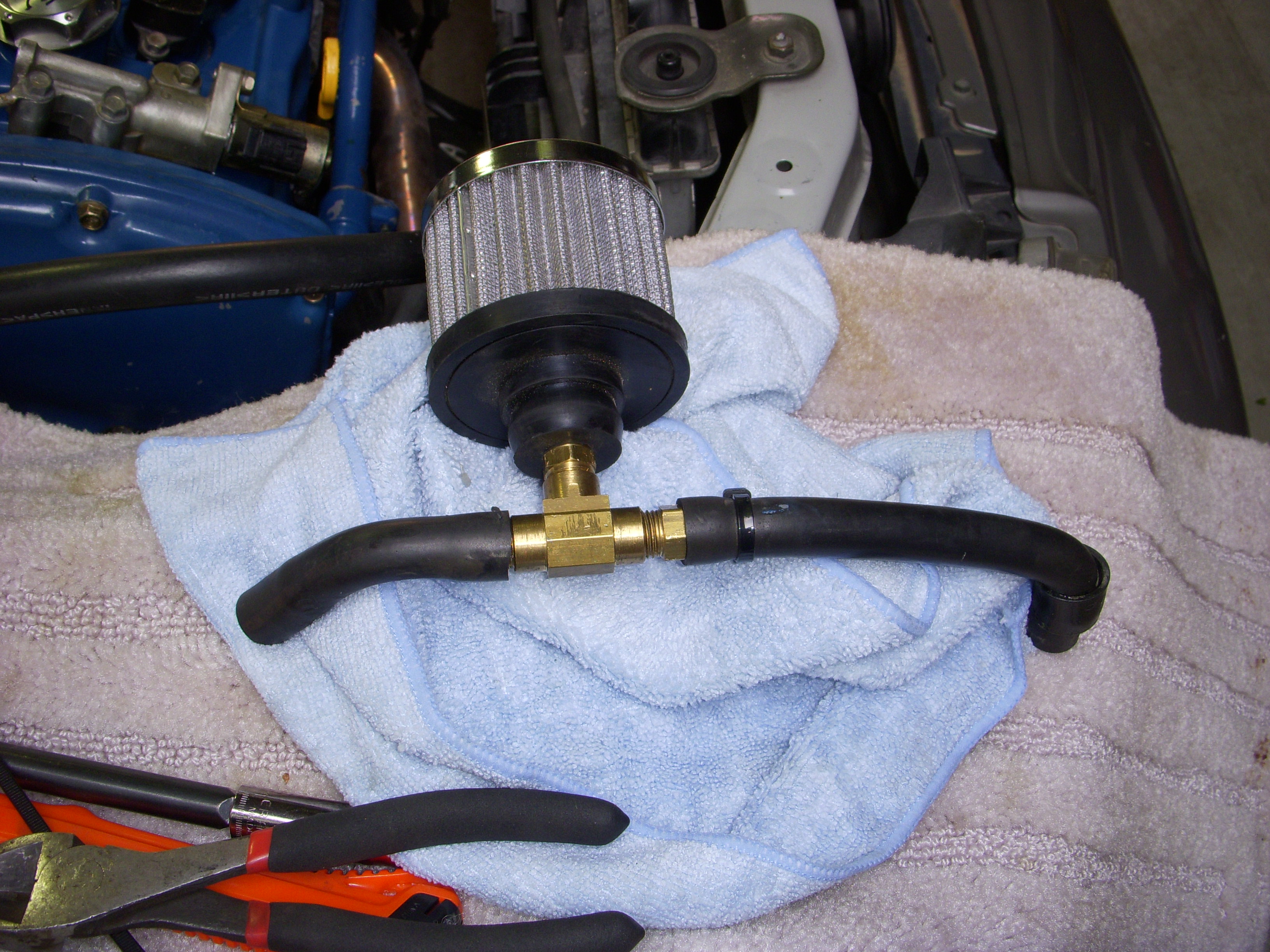

I've torn down the valve covers to replace the gaskets using Permatex grey Minute Gasket goo. It took two cans ($28.00) but so far no leaks. I also found the little breather filter on the front cover had broken off its hose and there was oil spewing out onto the transmission - another mess. I thought about it a while and came up with a nice way to put a larger breather filter on, fed from both banks. Looks good, fits good, gotta breathe good, right? I also found a vacuum leak on the 08 Altima UIM - a plug had started to leak - and replaced that. I installed the NGK race plugs, gapped to .035 and the car starts and runs very well. Lambda is back to normal at idle and WOT - N/A only tested so far. Going to a test-n-tune tonight for some tests with a 100-shot on the M/T DRs, to find out how things are working. If everything is back to normal, then it's time for the E85 conversion.

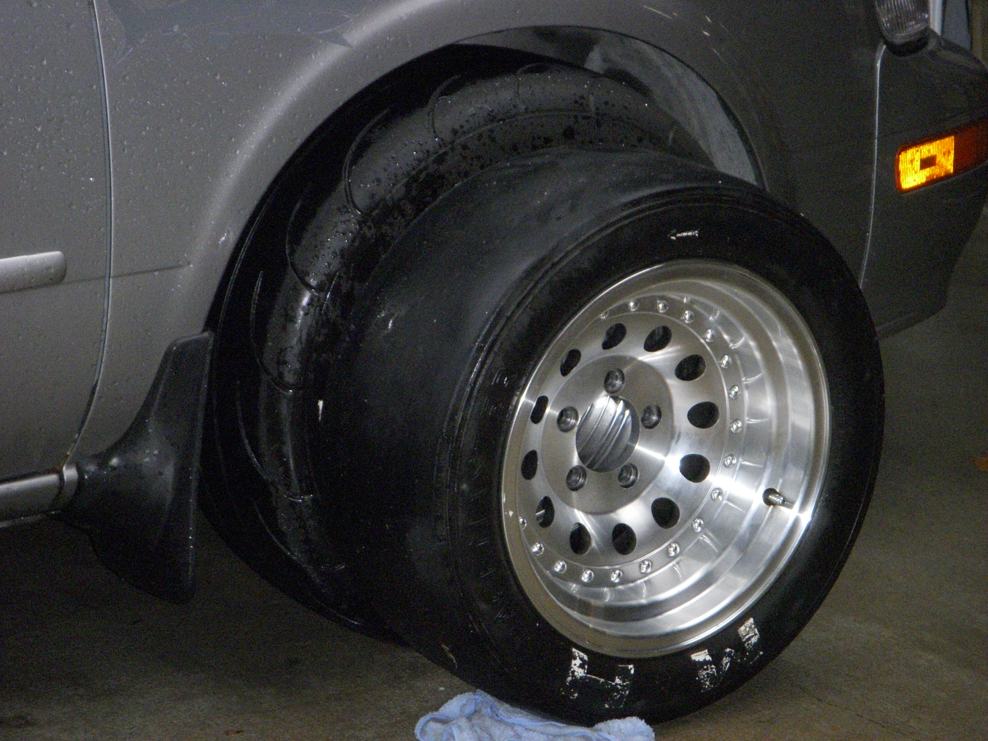

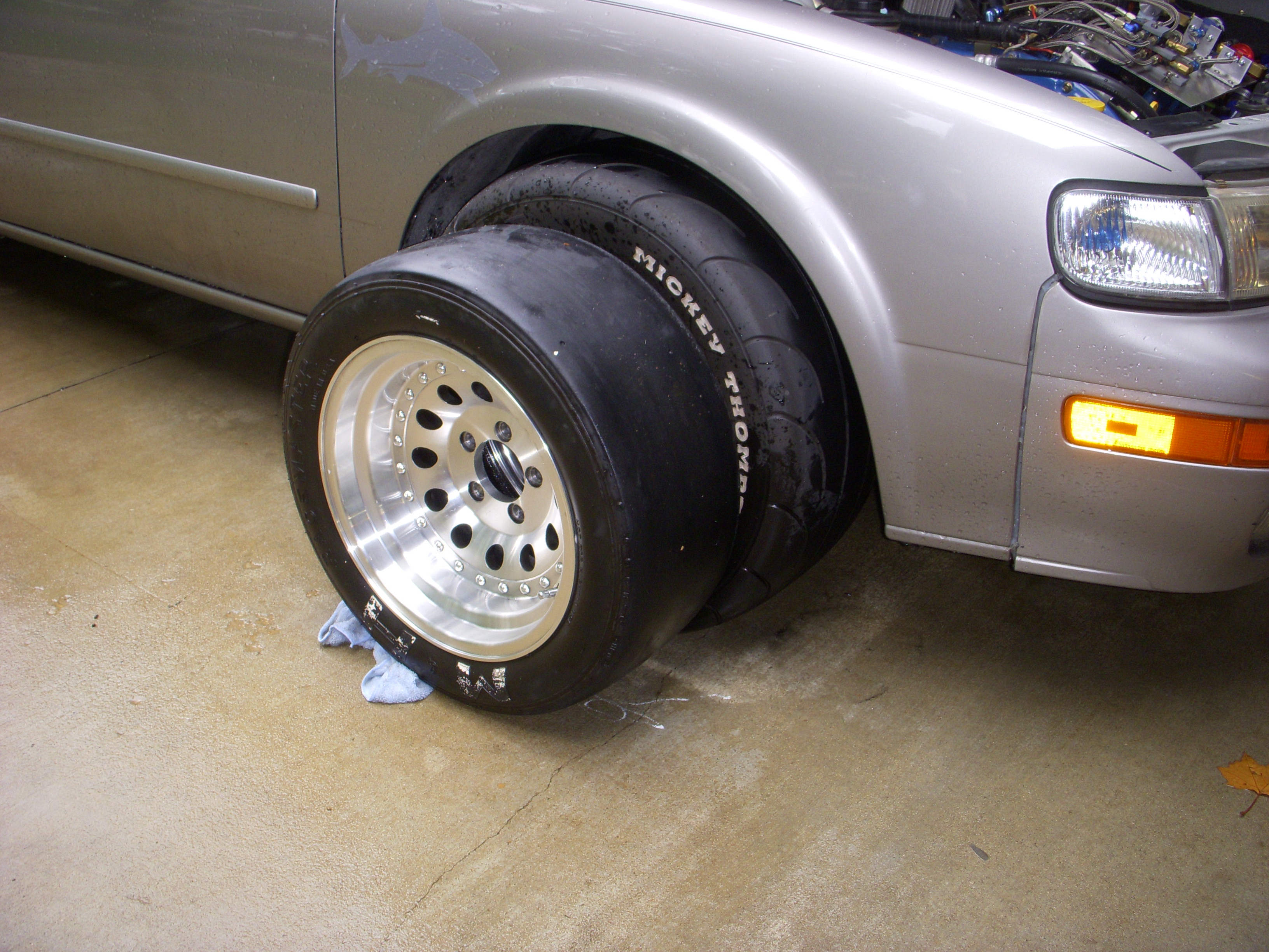

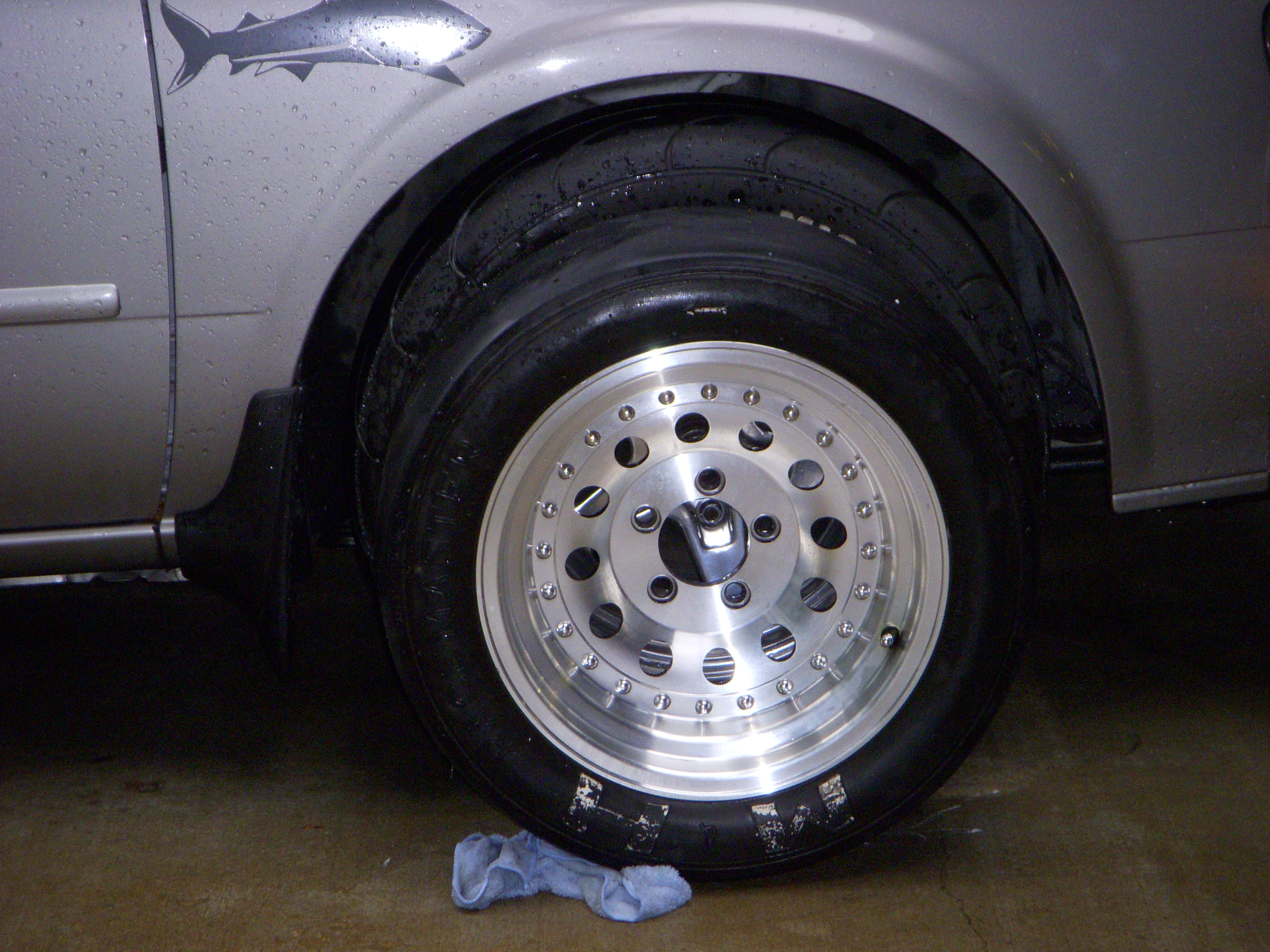

At this point, YES! I just ordered nitrous refills and three more cans of VP C85 ethanol. I've got to finish testing the Sunoco GT100 in the tank to be sure I can tune A/F (probably tonight). Then it's "drain the tank again" and installation of the 440cc DW injectors and start-up on ethanol. Then some more street nitrous tuning with E85....
I think I'll start with the 23x15x8.5" M&Hs on the front and the 24.5x15x8.5" M&Hs on the rear, because the slicks are much lighter than the DRs. Plus, this should confuse the tech guys even more than the DRs on front and rear! "is that car AWD?"

Yeah I'll be going! I would run the 24.5s. You might even need a 26x10 slick on the front! Have you thought about going to some skinnies on the back?

The reason I was going to put both sets of slicks on the car is because I don't have any skinnies - 'cause they're fugly - and the rear slicks can be inflated to 30-35 psi and roll real easy.. This way I can switch them front-to-rear if I want to try that.

A few pix of the M&H 23" slicks next to the M/T DRs, which are 26" diameter. The 24.5" M&Hs are kinda in-between. Yes, it was raining at the time... it's still raining off and on.
I know either slick will give me a lower first gear, helping with the launch. Kinda makes up for taz's shorter 1st gear, right?

Originally Posted by grey99max
Yeah, he needs a crash-box, the way he shifts. PFF... (Pretty F*ck*n Fast).
I would really love a faceplated transmission. That would be awesome!!!
The synchros are what slow me down.
I would run the 24.5s. You'll probably spin the crap out of the 23s.

Hodd mods

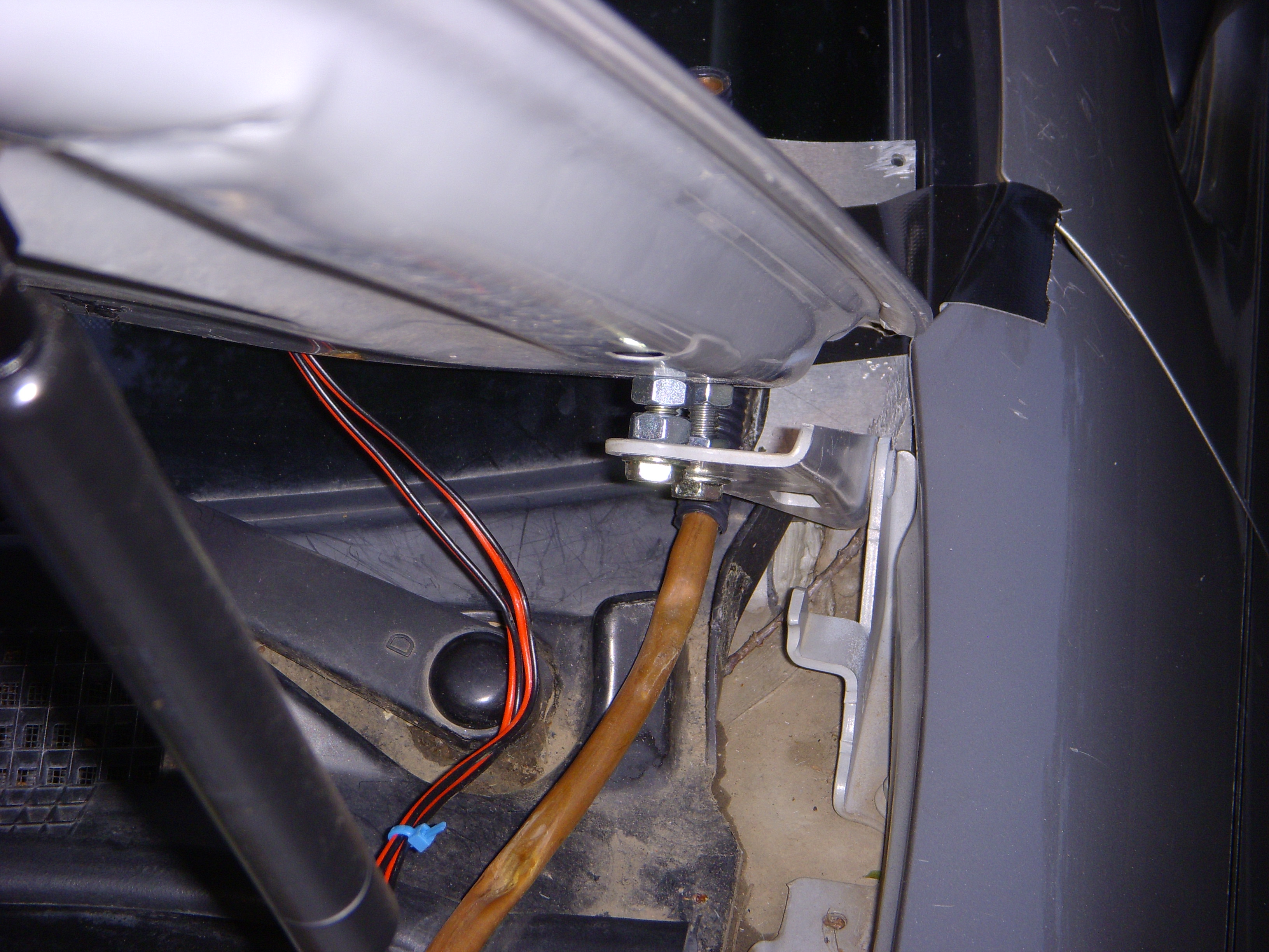

I decided to raise the rear of the hood for (hopefully) better air flow out of the engine compartment. Did it, took some pics, went out for a spray job, and just got back. The lambda is 7.3-7.4 while spraying a 150-shot - but the engine didn't heat up as much as last time. And - the hood is still attached - it passed the over-100MPH test.
Marked overflow tank - before...
I used some 30mm and 40mm 8mmx1.25 bolts and nuts to do the rear-of-the-hood-lift. As least I feel cooler...
Oh yeah - in some of the pix there are aluminum plates and Gorilla tape showing - that was to protect the windshield from the hood in case it got away from me.
Just at the lip of the hood, on the driver's side, you can see two little super-bright red LEDS which flash with the fuel and nitrous solenoids. It's always nice to know what's working - this time...

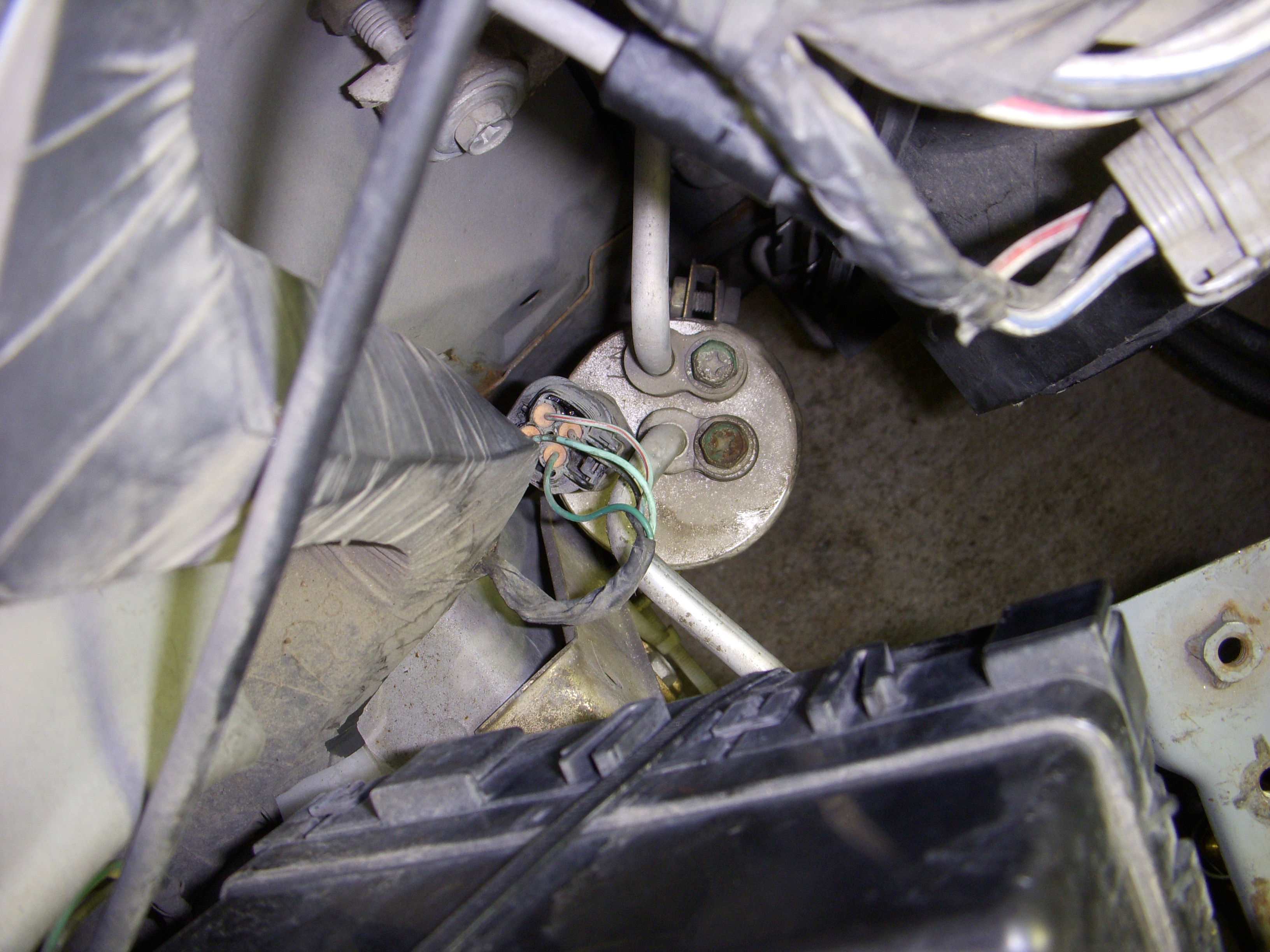

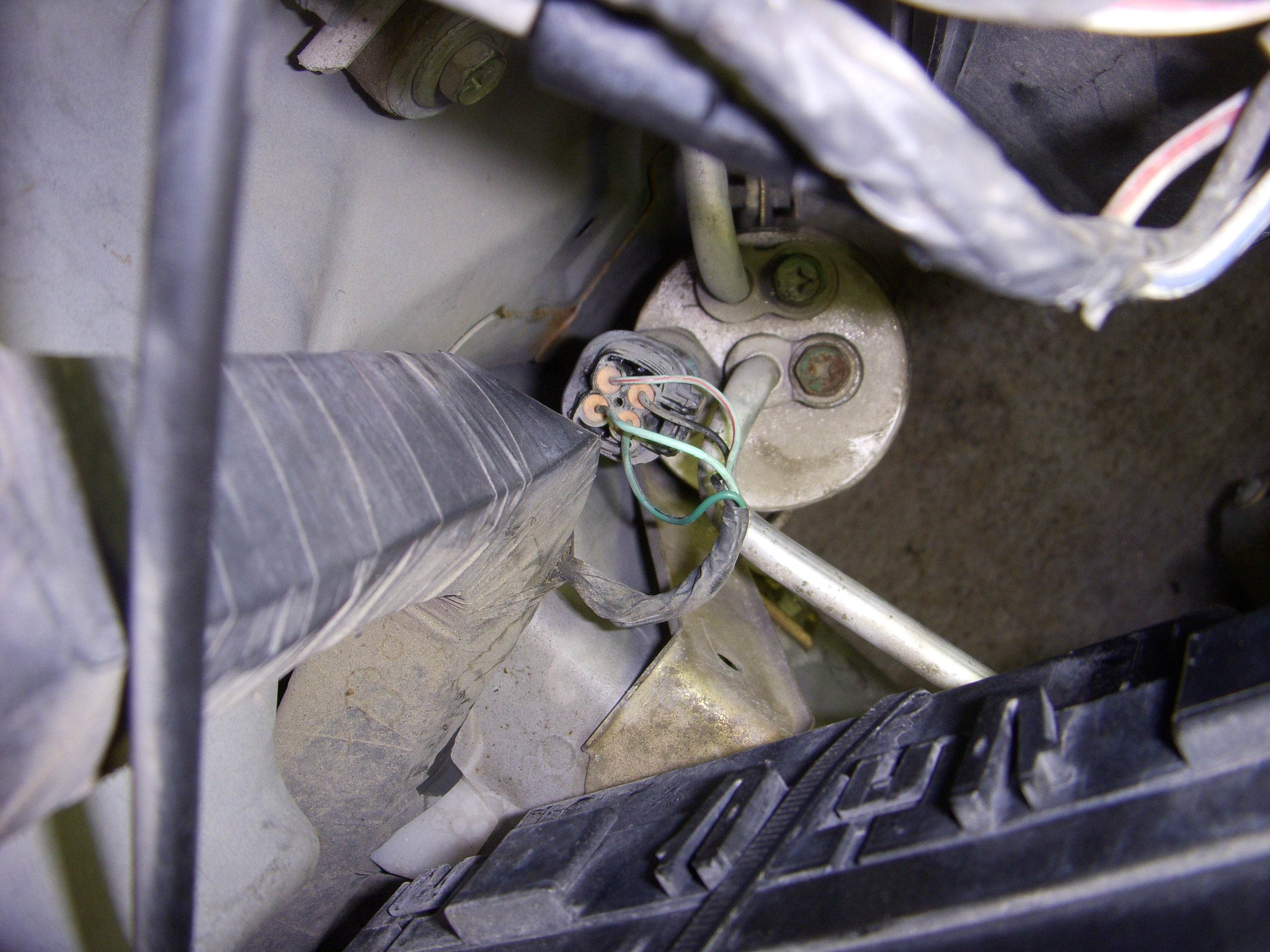

I need to do that for my car. Gotta figure out the best place to tap into a switch-to-ground control. Yes, the 4th gen has two-speed fans. Fast and FASTER! Heh...
Studied the FSM today - and found a convenient place to control the radiator fans - there's a fluid A/C "liquid tank" up by the driver's side of the radiator with a "Triple-pressure" switch that controls the engine fans. Its' connection is shown on FSM EC-11, over by the fan relays. The diagram on page HA-43 shows the wiring colors, and for a '99 you want the Light Green wire located. The connector and tank is on HA-56. The manual warns about NOT taking off this connector unless you gotta, so I moved the adjacent relay box out of the way and scalped some insulation off the solid light-green wire and soldered on an extension and taped over the joint. Now when you ground that wire, the fans run. Seems to keep things cooler. Went for a final drive with the GT100 fuel and sprayed a couple of times, shows a lambda of 7.5-7.6, somewhere around a gasoline 12:1 A/F.
This is a quickie ground:
The fans do run all the time this way. I'll mount a switch somewhere in the cabin.
It's now time to pump out the tank and fill 'er up with E85 - right after I change out the injectors and check the plugs.
