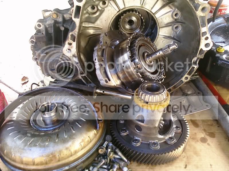

So the auto finally died, took it out today and opened it up: The band looks a little bad, the clutches inside the high clutch are burnt up and look pretty bad with even blue marks from overheating from the friction. No sign of actual damage from an input shaft or any of the gear teeth or anything.
I am going to take this broken auto to a local shop called ATF, and see what kind of quote they give me on a built auto based on the components that failed. I think with a clutch, band upgrade this auto can hold a good amount of power. Considering it has held up my abuse for years, Jim's as well. I dont think we really need anything else to upgrade.
Another option is getting an auto built by IPT, it cost $3,175 and also include 12month/12k miles warranty. I have heared good things about them, their customer service is great. Level 10, ehhhhh ill pass on them. Lets see what the local shop tells me.

See if they can squeeze a extra disk or two in there, believe me it helps

Well I was thinking of ordering a rebuild kit from IPT and just putting it together, But dont know if I wanna get involved with this although it dosnt look too bad, but still, no garage to have a tranny on a bench to work on. I got my old man complaining already lol.

Its higher strength friction materials, I have decided to go with IPT. I really like how the customer service is and how detailed they are, they modify the pump for higher flow and higher pressure, they heat treat all the metals such as input shafts and anything that has gear/teeth on them, they machine the casings to be able to fit more clutch disks' on both reverse and forwards clutch packs, they also do a VB, improved cooling passages, everything basically. Should be a bullet proof auto. Ty at IPT told me it will support 450-500hp, i told him what about higher hp. he said ofcourse, he just says 450-500 because thats pretty much the standard, but it will basically handle anything I throw at it. (well realistically that is, im sure it wont handle 1000hp, or maybe it will, but i wont find out lol)

The "new" auto is in, tomorrow I put in axles, fluid, and test it out. I was shown two autos at the yard, the one I picked had great color on the fluid, cherry red, the other one was more brownish. Hopefully this auto is good, based on the fluid it looks great.
I am going to drive with the stock VB for a week or two on the cheapest fluid I can buy, then flush it out and put in some good stuff as well as the Transgo.
