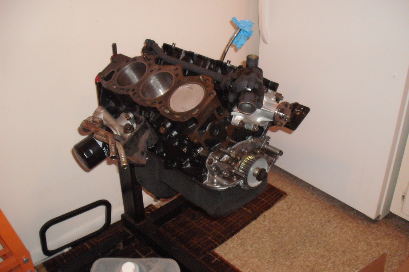

Ahem...I'm formerly a VE junky turned VG holic. Still have a beautiful VE collecting dust along with EFI harness and ECU. I really have no use for it anymore. I have a rebuilt VG in my apartment waiting to go into my current build. With full turbo set up.
Let's throw up some pics etc.
Got a pair of low mileage heads waiting to go on
fully rebuilt T3 with new housing, balance turbine with dynamic seal.
The list goes on but keeping it engine specific. Found these for ya.
