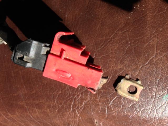

Car died on highway a week ago. Checked and cleaned all cables and connectors. Battery was down to 9v. Jumped vehicle. Alternator showed 7v. Removed alternator and tested at AP store. Failed. Replaced both alternator and battery.
New Problem
Immediately after replacing alternator and battery, the vehicle has no electrical power anywhere.
Looked at fuse/fuselink box and tested 4v at the front side of the main 120a link. Removed the +cable from the box and tested 12.7v at the end of the cable. Reattached +cable to box and tested 4v.
Pulled all fuses from box and tested 12.7 at the main link.
Put fuses/links back in one at a time and measured voltage after each install at the main link. Remained at 12.5 until the BCM fuse (#56 on wiring diag - 7.5a) was installed, then voltage dropped to 11 v at the main link and bounced around. Pulled the BCM fuse and the voltage went back to a steady 12.5v. If the light switch is turned on (even with the BCM fuse out), the voltage at the main link drops to 4v and remains there until all the fuses are pulled again.
Checked the connections at the alternator battery (ground and +) which seem good.
Any suggestions for next step testing would be very much appreciated.

While doing so, the brass loop snapped off. Closer inspection revealed that it had a stress fracture (probably from taking it on and off the battery so much). My hypothesis is that i could get 12.6v at the fuse box as long as there was no load on the battery. As soon as I put a load on and called for power, there wasn't enough cross sectional area of the brass loop with a good connection, so the v dropped at the end of the cable. Went to the boneyard today and picked up a new + battery cable ($4). There are two snap together connections, one to the starter, the other to a wire that I think goes to the fuel pump, a bolted connection at the starter, and a bolted connection at the fuse box. Slapped it in and voila..........12.6 all around, everything works. I sure hate being ignorant, but it's my best thing. Hope this is helpful to someone. As stated repeatedly in this forum..........First check EVERY aspect of the battery connections before you do anything else. (But I bet I have the cleanest ground connections in any 99 max on the planet). Thanks to Dennis for his suggestions.
TH
So......last night was fiddling with the connector on the + terminal that routes to the fuse box, trying to see if I could get it apart. On my car it is red with a small brass loop that connects to the main battery terminal connector.
TH
TH
