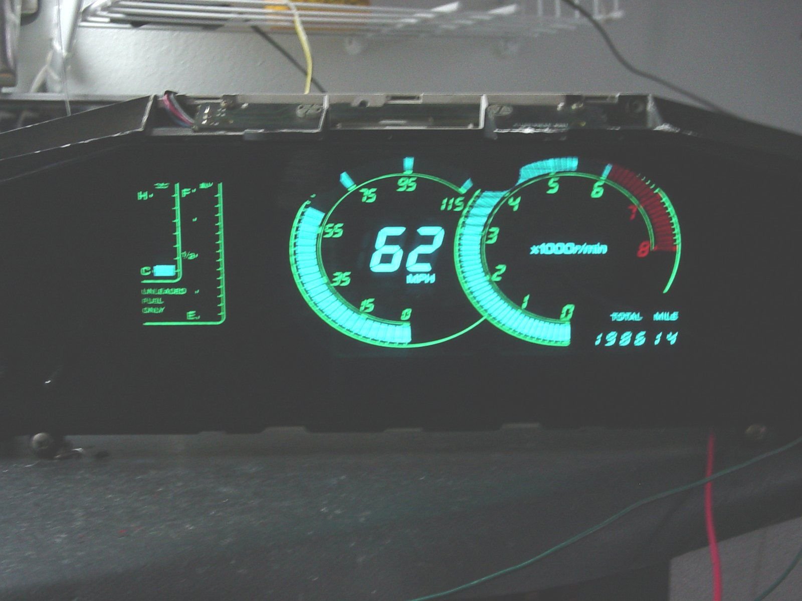

Old Jun 28, 2015 | 11:53 PM
  #9456
RocketSledder77@me.com's Avatar
Joined: Jun 2015
Posts: 35
From: Lake Buena Vista, Florida
Digital Instrument Cluster
Hello everyone, first of all thank you for such a wonderful and helpful forums. They have been so helpful in starting my journey in "plusing" my 1999 Maxima. The question I have is there any form of a digital instrument cluster (it can even be after market) for my vehicle? I saw this one and I kind of like it. But I am not sure if it is compatible with my vehicle?
