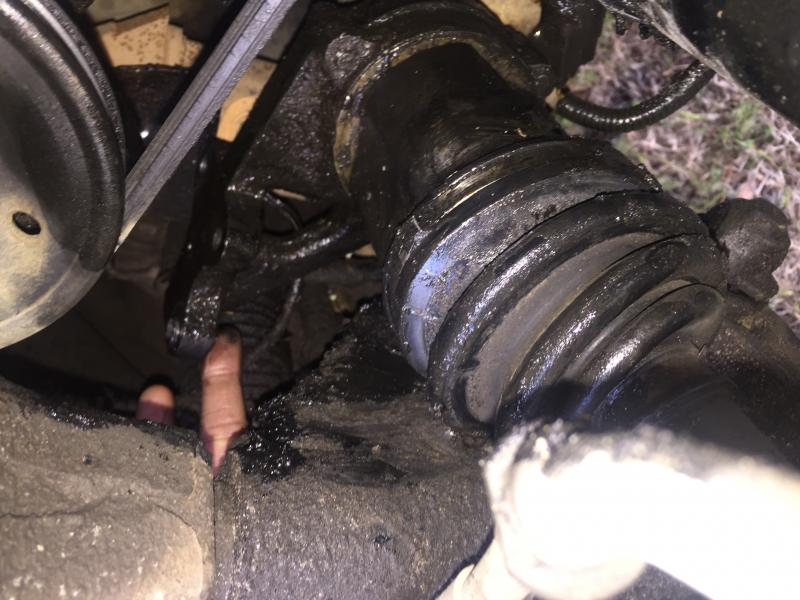

NEED HELP ASAP 99 Maxima
something came a loose by my axles . I was wondering if anyone could tell me what it is ...I'm trying to provide a pic Car Stuck In 5th Gear And Won't Move Now But Speedometer Shows Speed Increasing-image.jpg
Mar 28, 2015 | 12:53 PM
Looks like the carrier bracket on the passenger axle.
Did it break?
Mar 28, 2015 | 01:23 PM
I think a bolt came out or something
Mar 28, 2015 | 01:47 PM
If I remember correctly, there are 3 12mm bolts that bolt your axle to the engine. Go to a junk yard or a dealer and get new bolts. I would not drive the car before you tie up your axle.
Mar 28, 2015 | 03:56 PM
It looks like the axle popped out do to the carrier bracket or that bracket screw and bracket broke.
Mar 28, 2015 | 04:02 PM
The pic looks small is there a bigger pic.
Mar 28, 2015 | 04:18 PM
This reminds me of the following thread.
https://maxima.org/forums/4th-genera...power-oil.html
Mar 28, 2015 | 05:57 PM
Bolt the bracket back onto the engine. Just as I posted in your other thread, If the bracket breaks (or all the bolts come out) the axle will come out of the traans and make grinding noises and no drivey drivey.
BTW why did you start a separate thread for the same problem?
Mar 28, 2015 | 05:58 PM
Mar 28, 2015 | 05:59 PM
if u could circle in red the location, that would help too
Mar 28, 2015 | 06:00 PM
Quote: something came a loose by my axles . I was wondering if anyone could tell me what it is ...i'm trying to provide a pic
Mar 28, 2015 | 06:14 PM
Here you go. wow... how did that happen, makes me wanna check my bolts
Mar 28, 2015 | 07:17 PM
He just bought the car, this happened and he ran out of clutch fluid. Car was likely wrenched on by a hack or tweaker and is like this all over the place.
Sent from my XT1060 using Maxima
Mar 29, 2015 | 01:44 AM
Ok, this is a better pic, now the bracket is just hanging loose,where are the bolts,did they break off or the bolts were never on the bracket. Look where the bracket mounts on to the car, see if the bolt holes are stripped or broken in the holes.
