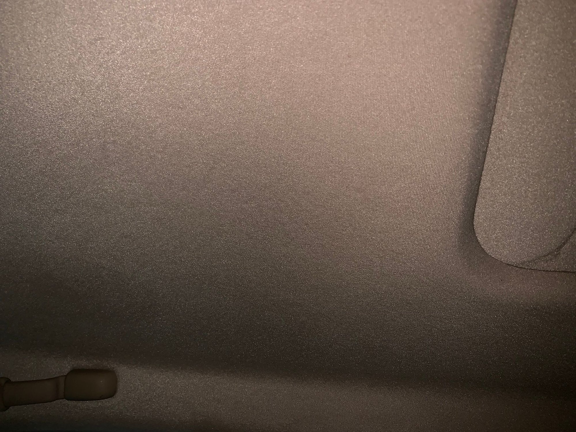

This vehicle, formerly my wife's daily, is now mine. There are many things about it that apparently didn't bother her but that annoy the S out of me. For example: dents in the leather from child seats. Also: these stains on the headliner as shown.
I'm pretty sure the small brown spots in a splatter pattern in the middle of the roof is "chili". I'm not sure where the larger circular discoloration above the rear seat came from / what it is.
What's the most sympathetic method to clean the headliner / avoid the headliner sagging ?

I will once again let you know that based on my personal experience, a mild mix of blue Dawn, warm to very warm water and a damp micro-fiber works very well.
Use very light pressure initially, increasing once you get a feel for it so you don’t “detexturized” the fabric.

Brian, Ive also been successful by using Dawn, liquid laundry detergent, garden hose's and shop vacs to clean interiors.
I feel that the Dawn solution might work, but might weaken the bond between the head liner and what it's bonded to. I'd let it air dry. I think that the vacuum cleaner might cause the layers to separate, then sag.

i used the dawn solution on a microfiber cloth to blot the chili away
i then rinsed the areas i used the dawn on with clean water on another microfiber cloth
i didn't really hit the huge other discoloration above the driver's side rear seat passenger because WOW its amazing what you notice all at once when you really start looking, this car has had a leak at the top of the rear window glass for quite some time.
not riding with the chili on the ceiling was good enough for the moment so i didn't go any further trying to clean anything
