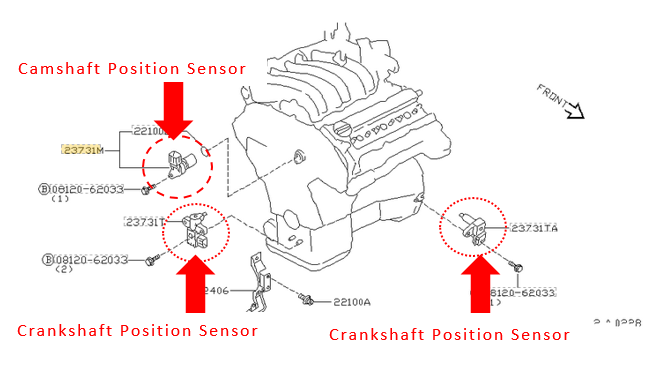

You need to replace the camshaft sensor for the bank closet to the firewall. Most ppl replace them in pairs along with the crankshaft sensor located by oil pan underneath.
Old Jan 27, 2020 | 04:28 AM
Turbobink's Avatar
Posts: 2,756
From: Tampa Bay
One (1) cam position sensor.
Two (2) crank position sensors.
