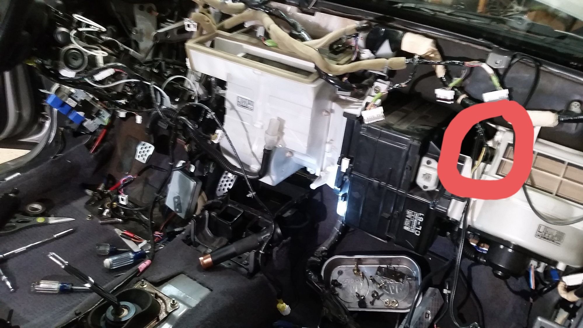

Can someone here please tell me where the fresh air/recirculating actuator is for the 97 Maxima? Not the blend door for the heat and not the controls for the defroster/floor/fan on face. Mine is stuck on recirculating and my car keeps fogging up and I have to crack the window to clear it out. Thanks in advance

It's behind the passenger airbag on the side of the blower housing.
Sorry it's blurry.

It's called the intake door motor.
It's above the blower motor.

that is perfect. When my mechanic did my heater core I have a feeling did not reattach that

Well it was plugged in. It's fair to say that motor is toast.

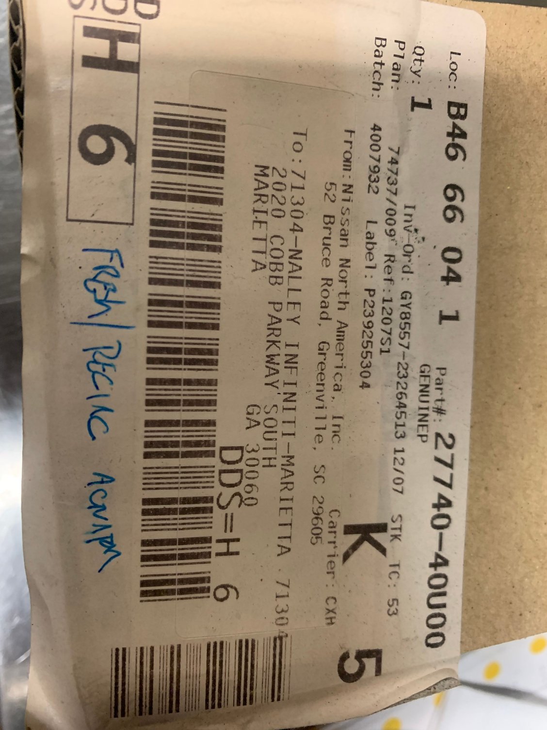

The part I have is:
27740-40U00
”Actuator-Air”

I think this is for the blend door/heat. I need the recirculating fresh air one. I already replaced that

So...I don't _know_ - just posting for edification/clarification/information. I had thought that I bought the correct part to fix a broken Fresh/Recirc condition. I very much welcome clarification:
This is the link I used to buy #27080 (27740-40U00) - it shows the part in question on the driver's side of the blower assembly, towards the top:
https://www.infinitipartsdeal.com/pa...270_B002,27080
On that website above, the part I bought is shown on the "Blower Unit" sub-assembly drawing. The part that KP11520 referenced ("27730M - 27736-40U10") is shown on the "Heater Unit" drawing. I think the "Blower Unit" is in front of the passenger seat - and "Heater Unit" is in the center stack.
