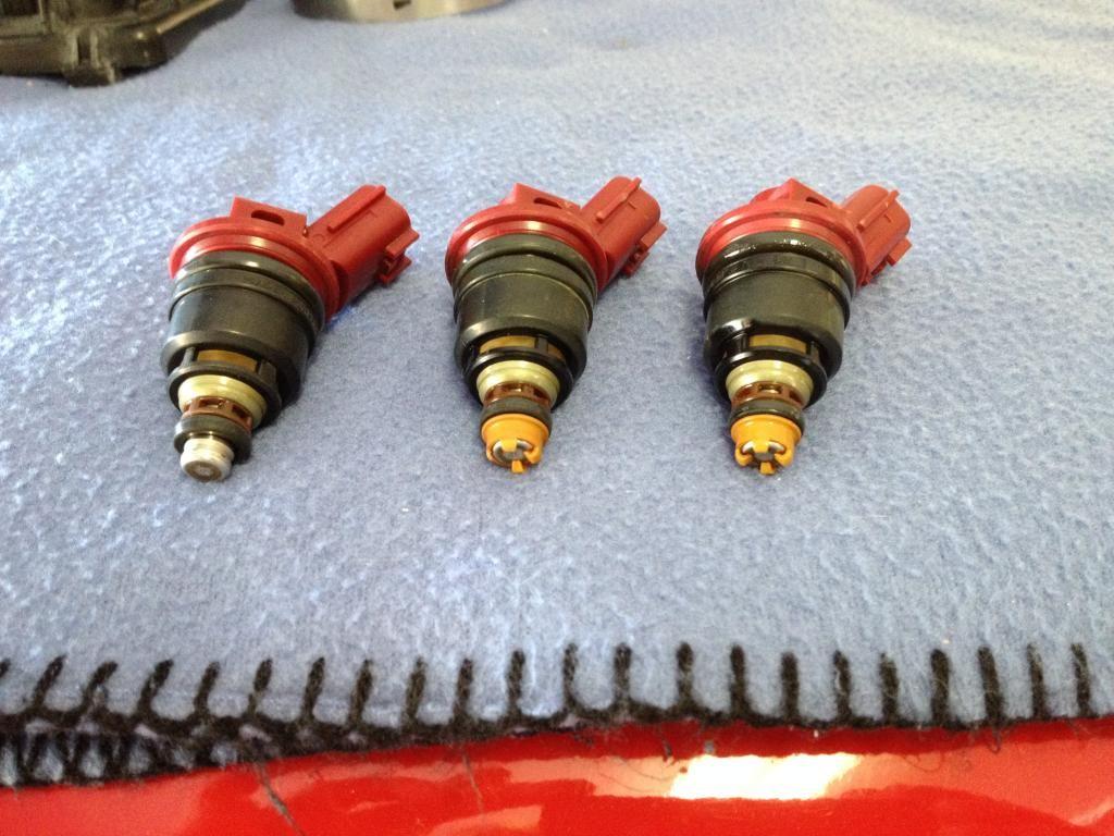

I have some pics showing the caps in this thread. One of pics shows the injectors I pulled out with the deteriorating pintle caps...

Old Mar 31, 2022 | 10:46 AM

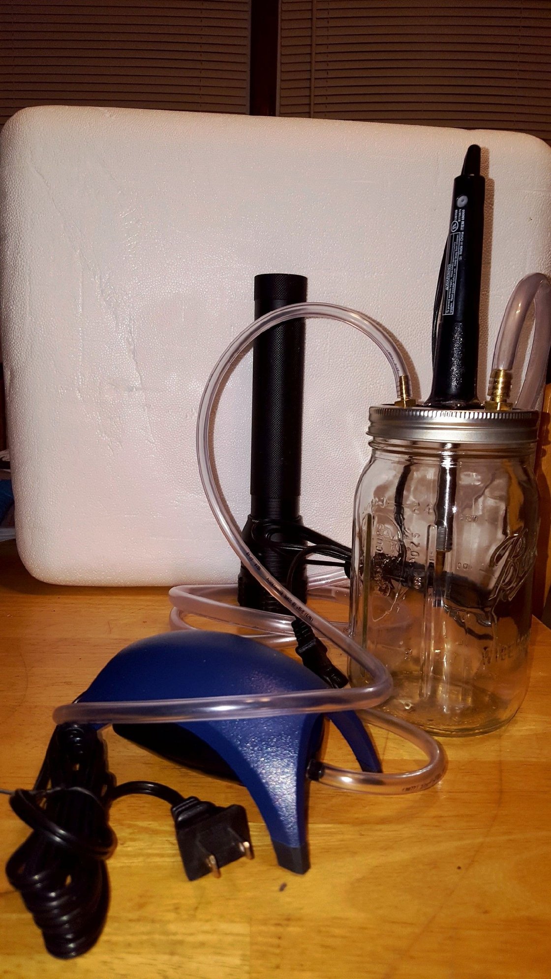

Tomorrow, I will pump smoke through my vacuum system and find those leaks.
I made a smoke blower that uses mineral oil, a cotton rag and soldering iron to make smoke and a fish tank air pump to push the smoke in the vacuum system. Then I'll see smoke where it leaks. No better way to find the hard to find.

Closing this out, problem is solved with 'new' rebuilt JECS injectors. Old injectors visibly looked fine, only #1 had pintle damage, one of the four arms was missing. Just for giggles I hooked up a harness to put power to all the injectors, and they all happily clicked away, could not tell any difference between #5 and the rest. There must have been some internal fault that caused the problem. Screens were all intact and did not appear to have any deposits or junk.
To ease the installation of the injectors, I lubed the o-rings with ATF and used a big channel lock pliers to twist and push them down into the bores.
